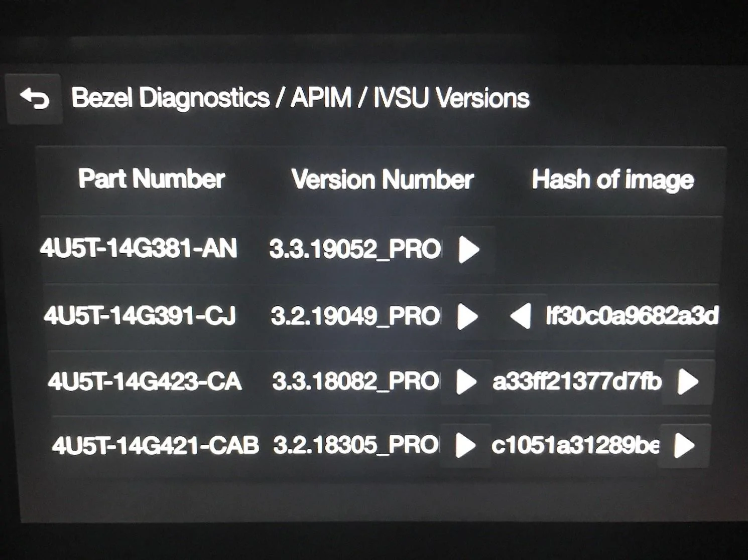

So started the update process. Got the files on an exFAT formatted 16GB stick as required. Inserted the USB on the front port and got the "system update detected" Saw warning about the time it would take to complete and asked if I wanted to proceed. Clicked yes. The "update in progress" msg came across the screen and stayed there for about 30 minutes. The unit rebooted. The same message came up and stayed again for another 20-30 minutes. Then I saw the "update complete.. remove USB and close" message. Turned ignition off then on. Checked the current version and it was the same NA 1 17. Anyone else gone through the process, without any errors, only to see the same version.? No update!
If I remember right, there's some bug with v3.3 to where it's not showing the new version number. You can verify it updated by checking the installed packages in the IVSU Version screen in Diag.

Sorry for the delayed response to some of the questions asked earlier. I used Safari and had no issues with the website or download time. Install took about exactly an hour but worked without issue. I was able to get the map update for free for the wife's 2019 Nautilus which had the NA 1 17 maps (it was an early build, delivered last November) but had to pay the $109 for my 17 Mustang. Unfortunately after going through the update process more than once my wife's Nautilus still shows the old maps despite otherwise appearing to be a successful install...
I read that the update might not report the correct version for some (read that most) ... somehow it's not updating that part.. but you do have the 118 maps
