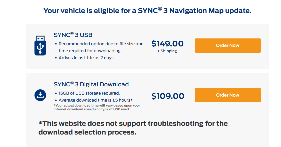

Downloaded the Sync 32.zip which was about 11GB and the license file, formatted my memory card as exfat and loaded everything up. Put it in the car, started it and it gave an error. Went back to the computer to get another file from the original site and it didn't give me the option to download, only to buy for $40.
Went back to the original confirmation email that was sent the first time I downloaded. Clicked on the re-download button and redownloaded everything. Downloaded files to hard drive, extracted the files and then copied everything over, according to the instructions to my usb drive. Popped it in the car, started it, it started updating. Ran the car for 15 minutes and it completed.

Sean, I cannot thank you enough. I gave up trying to load my files to my car. Just went ahead and ordered the drive for $40.00. I did not see the re-download link. Will try again tomorrow. If it works i'll try and cancel my order.
