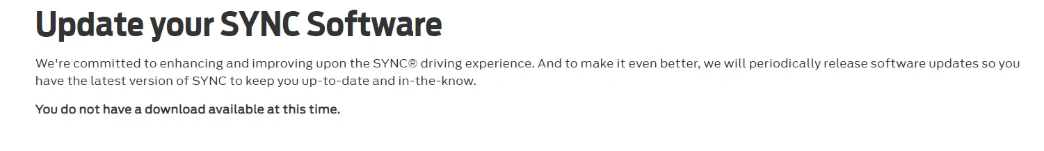

I am using the Sync serial number. I got a map update for another 2019 vehicle just fine just not this one.

I do. i even called them to see if they had another 2019 mustang in case they might have mixed it up. This is the VIN 1FA6P8CF6K5141638 if you search it it shows the 2019 mustang and I was able to confirm that they have this car
Not sure why ford's system is saying that they do not match
I'd call Ford and tell them this information, maybe they have a work around.

So I eventually got someone that got to the bottom of this for me. Seems that the VIN I have has a different ESN attached to it. They gave me that esn but it's not what I have. They are saying I have to call into a ford dealership to update the esn but when I do they want the car to come in so they can verify and make the changes. Unfortunately I cannot bring the car in as it is in a hundred pieces :blush:
So unless i can figure out the vin it came from i think there is really no way to figure this out. The scrapper insists that is the car it came from but ford has a different esn on their system and no way to update to even buy an upgrade.
Only consolation is that the maps are usually outdated anyway so I guess it's waze going forward
