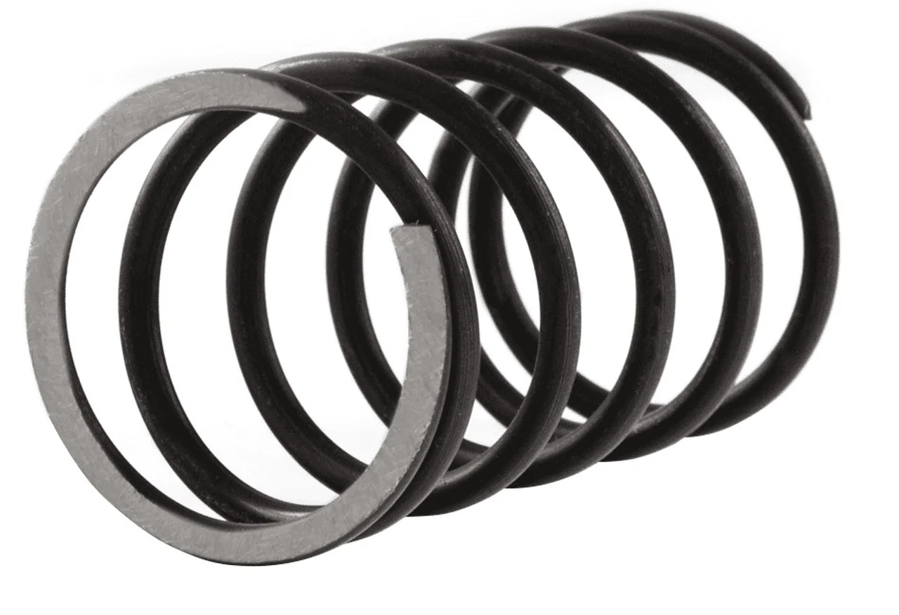

I feel your pain! The Steeda clutch spring makes it harder not easier. Did you buy it used? As in, is there a possibility that someone has swapped the spring already for a Steeda? (If you could go back to the original spring and get some lighter effort that would be great)

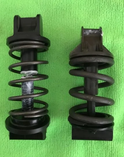

If you compare pics of the factory vs aftermarket they look quite different. The factory has thicker and more coils I believe, the aftermarket looks really weak compared to factory.

Here we go, stock on the right, big beefy spring...

I definitely have the one the left! Thanks
If you’d like to try the stock spring, I’ll send you mine free of charge. I switched to the Steeda and the Oem one has been sitting in a box. You’d just have to pay for shipping.

I took a look again and the one I have is the stock one
