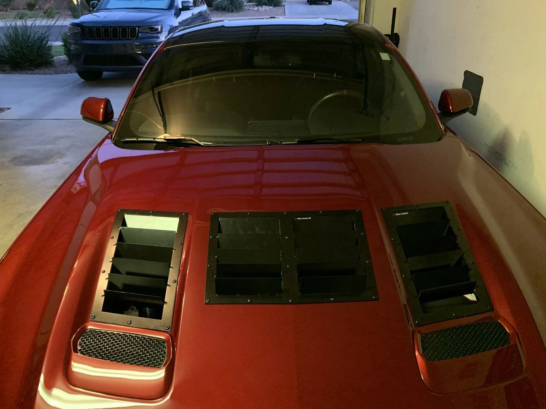

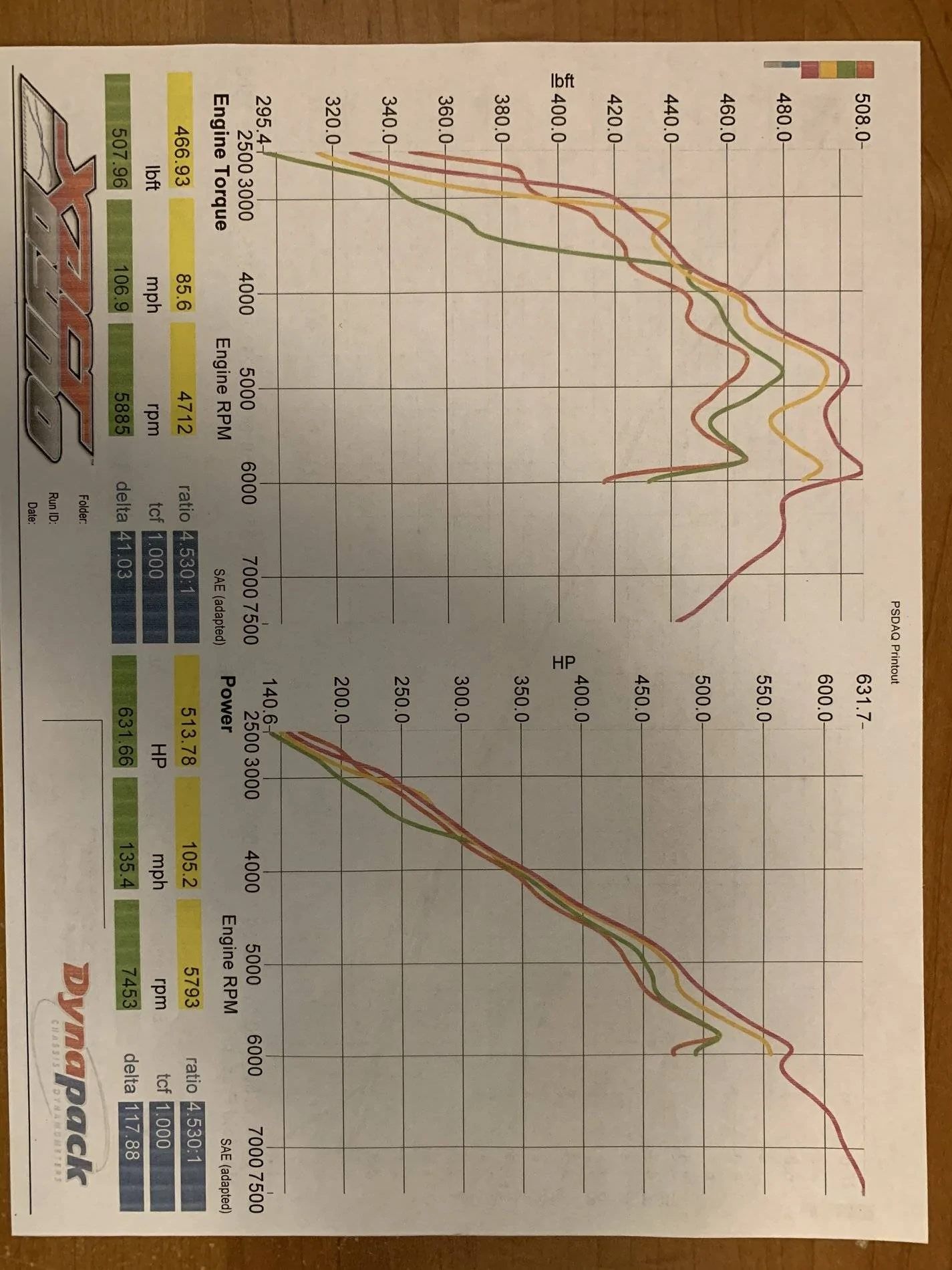

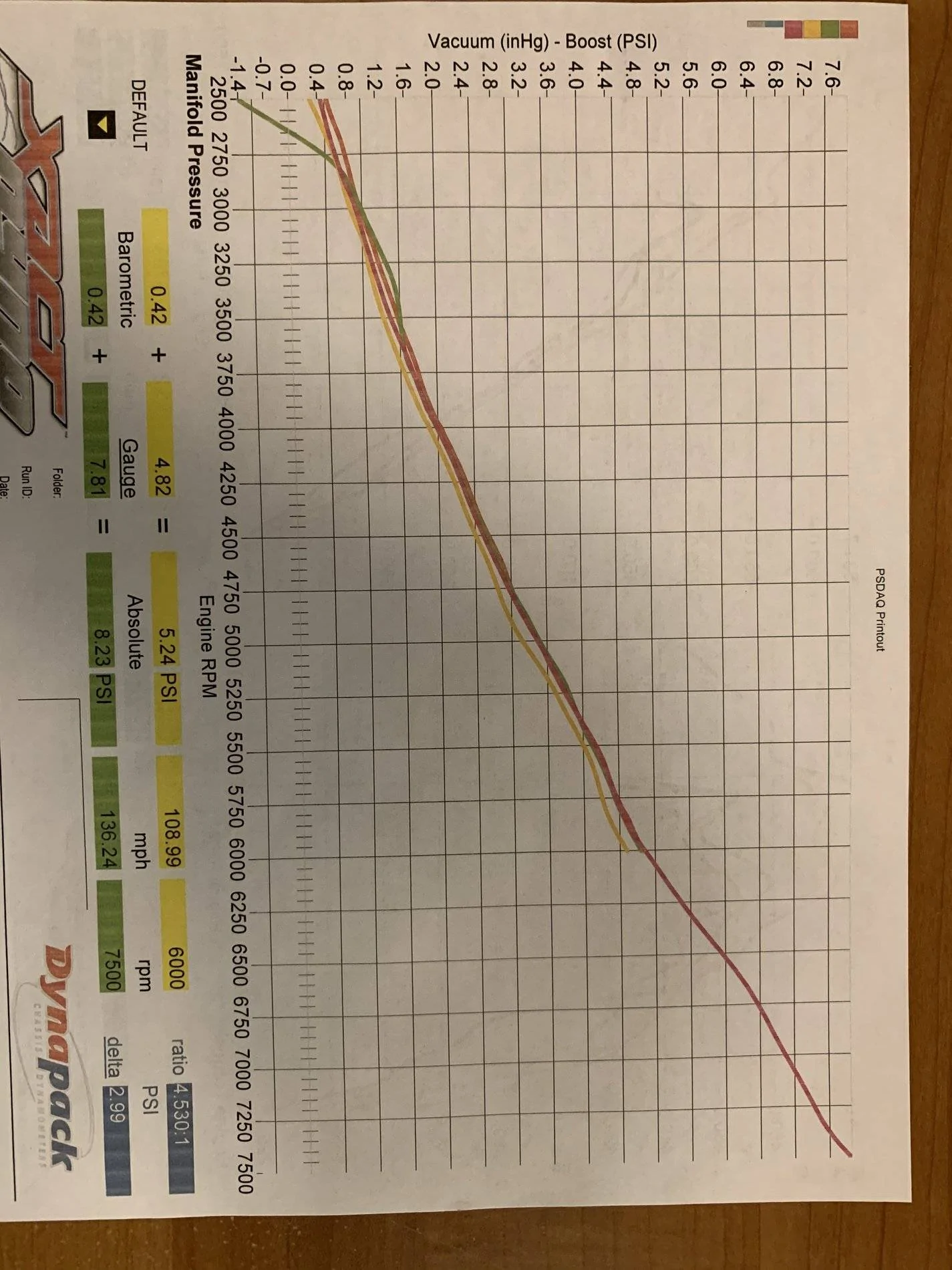

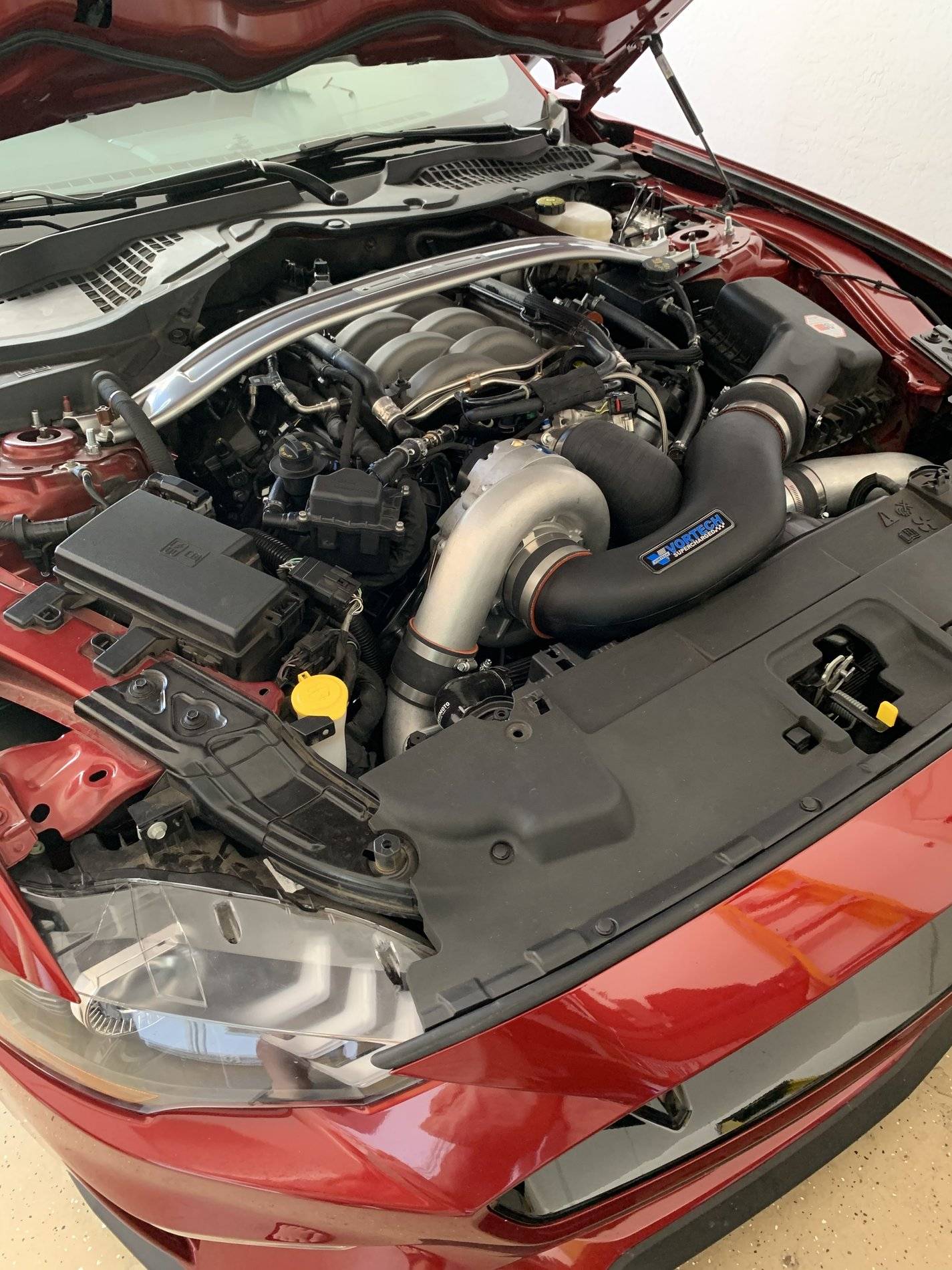

Just had mine installed a few months back. Vortech V3 JT Trim, went to a 3.8 pulley from the included 3.6 due to crappy AZ 91 gas. Have BAP and ID1050X injectors. Definitely a different car and I went with this set up to keep temps down as I do HPDE road course. This was the recommendation from Terry at Beefcake and I am very pleased. Went to a private track day and after 15-20 min sessionS IAT’s never exceeded 125, very pleased and had a member here, @zero_chance do the install along with OPG/CS. I also installed hood vents which I am confident are helping keep temps down. 630 WHP and 508 Wheel Torque @ 8psi. Tuned by Lund. Hope this answers some of your questions.
