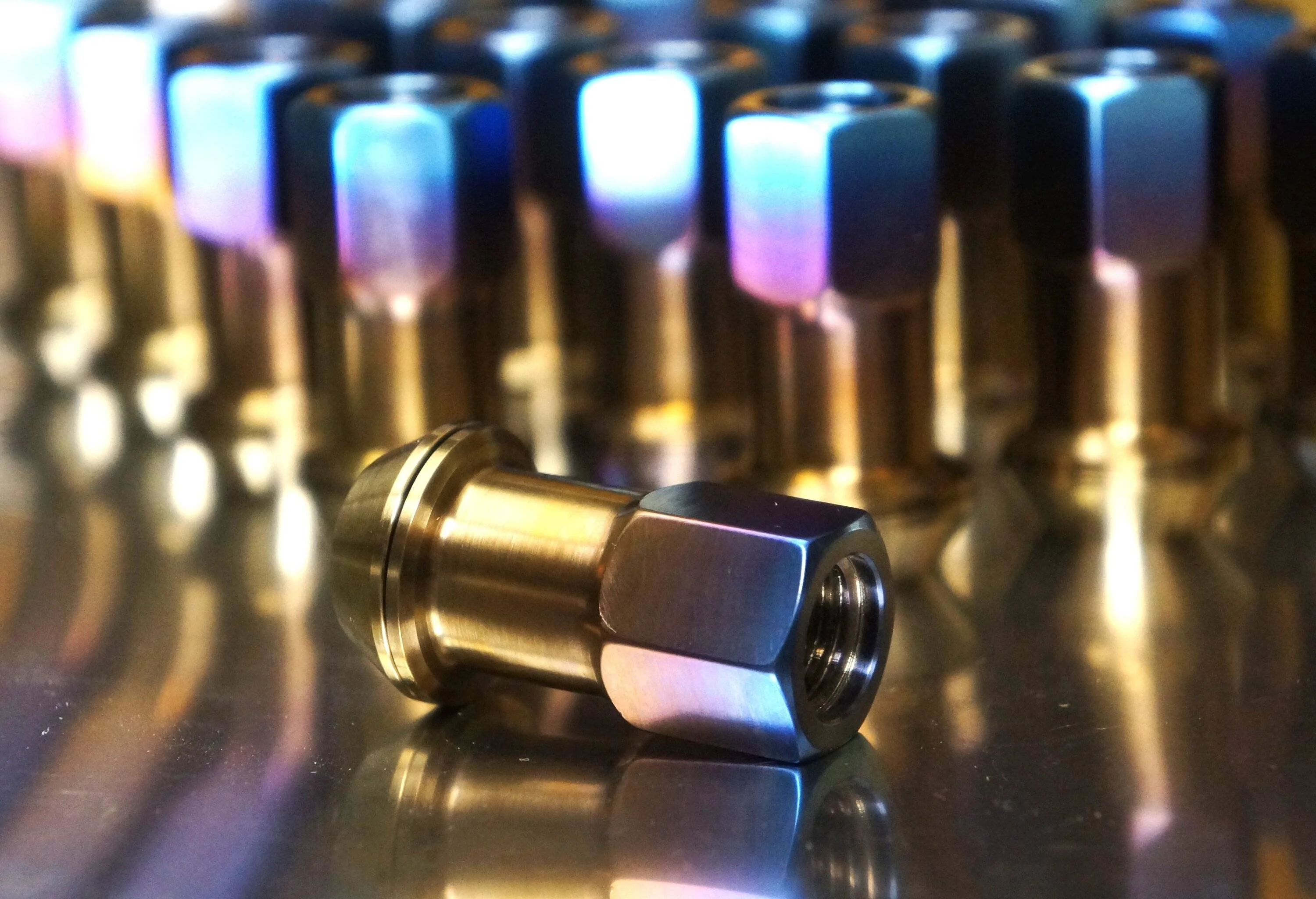

Anodizing titanium is super cool it takes 75-120 volt DC can achieve all sorts of cool hues and colors all done by electrolysis no dyes involved. It is the dyes that fade in UV light. The chemistry is simple the power supply is expensive and the voltage can be dangerous
Happy New Year!

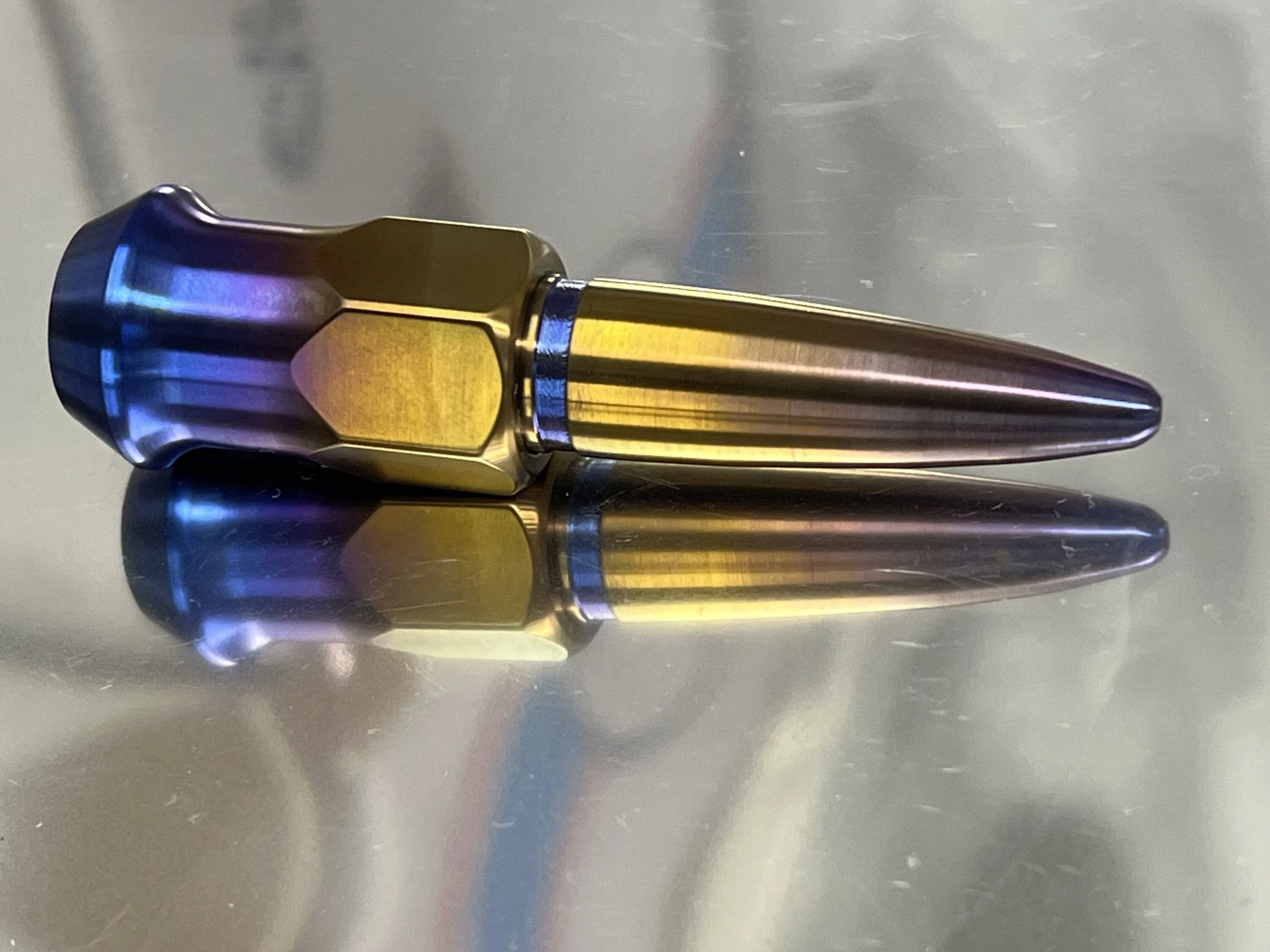

I use 9-24 Volts (see picture below). The main advantage of Ti Anodizing is its simplicity. Easy to remove (sand with oil) and easy to rework DIY (in baking soda). Ti color is the result of light interference. Titanium oxide is transparent. Light reflects from the exterior of Ti oxide and from Titanium surface under oxide. What we see in colors is interference of two reflecting lights. It makes us see colors the same way what we see on a butterfly – adjusted light wave length. This is why the colors on Ti will never fade over time but may change to a different spectrum because the oxidation may increase in thickness.
It takes me 15 min to rework old colors on a Ti 20pack

Awesome, higher voltage results in different shades. Color is controlled by current density. Very similar to electrolytic dying of anodized aluminum

Higher than 24Volt does not produce Titanium color that motorists want. 9-24V gold, purple, blue, and combination gradients are the most popular.

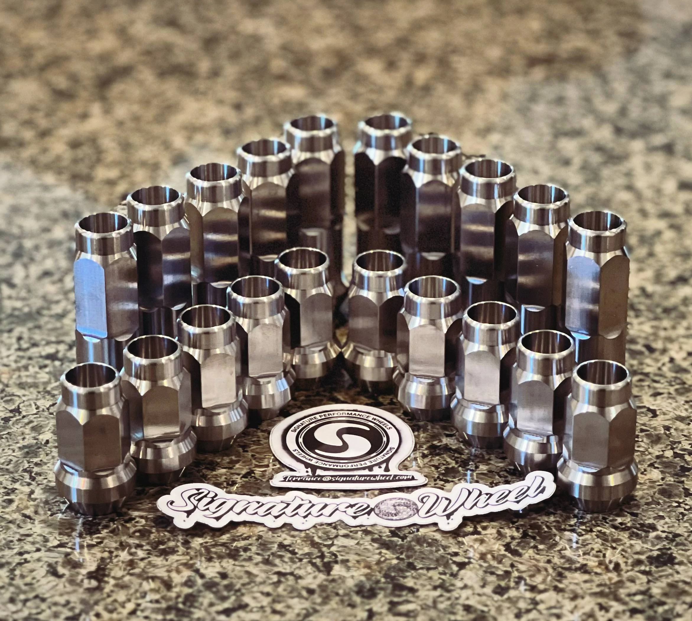

Titanium lug nuts are back in stock! I only have 14 sets of them left. GT500, GT350, CT5-V Blackwing, and ZL1 Camaro compatible.
Specific lengths front and rear to provide equal amounts of protrusion. Half the weight of OEM. Naturally corrosion and rust resistant.
The cost of titanium seems to go up every time I build these. Definitely snag a set before the next run, as I anticipate a few dollar increase.
