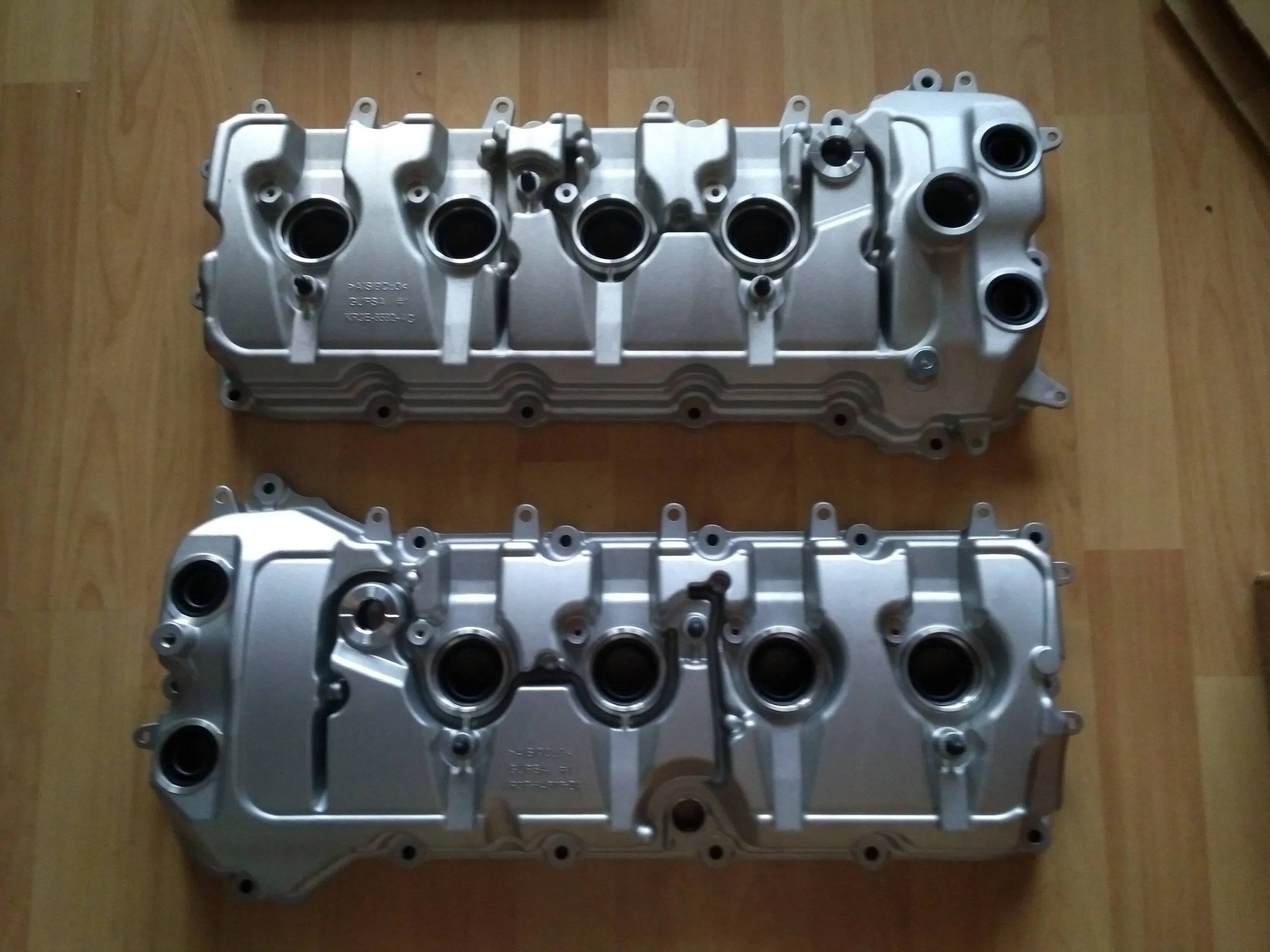

I received the covers but didn't get any bolts, should I have received bolts too?

Yeah those come with bolts, I'd recommend reaching out to whoever you purchased from (hopefully us) and try to get a set of bolts. :like:

Thanks
I called them and they said that they would take care of it.
