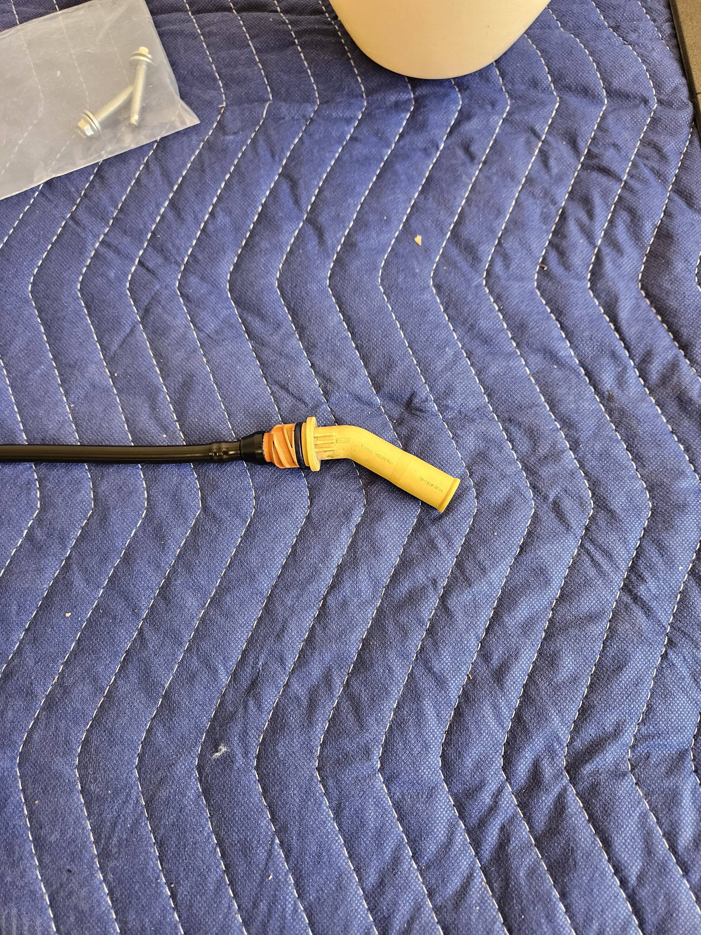

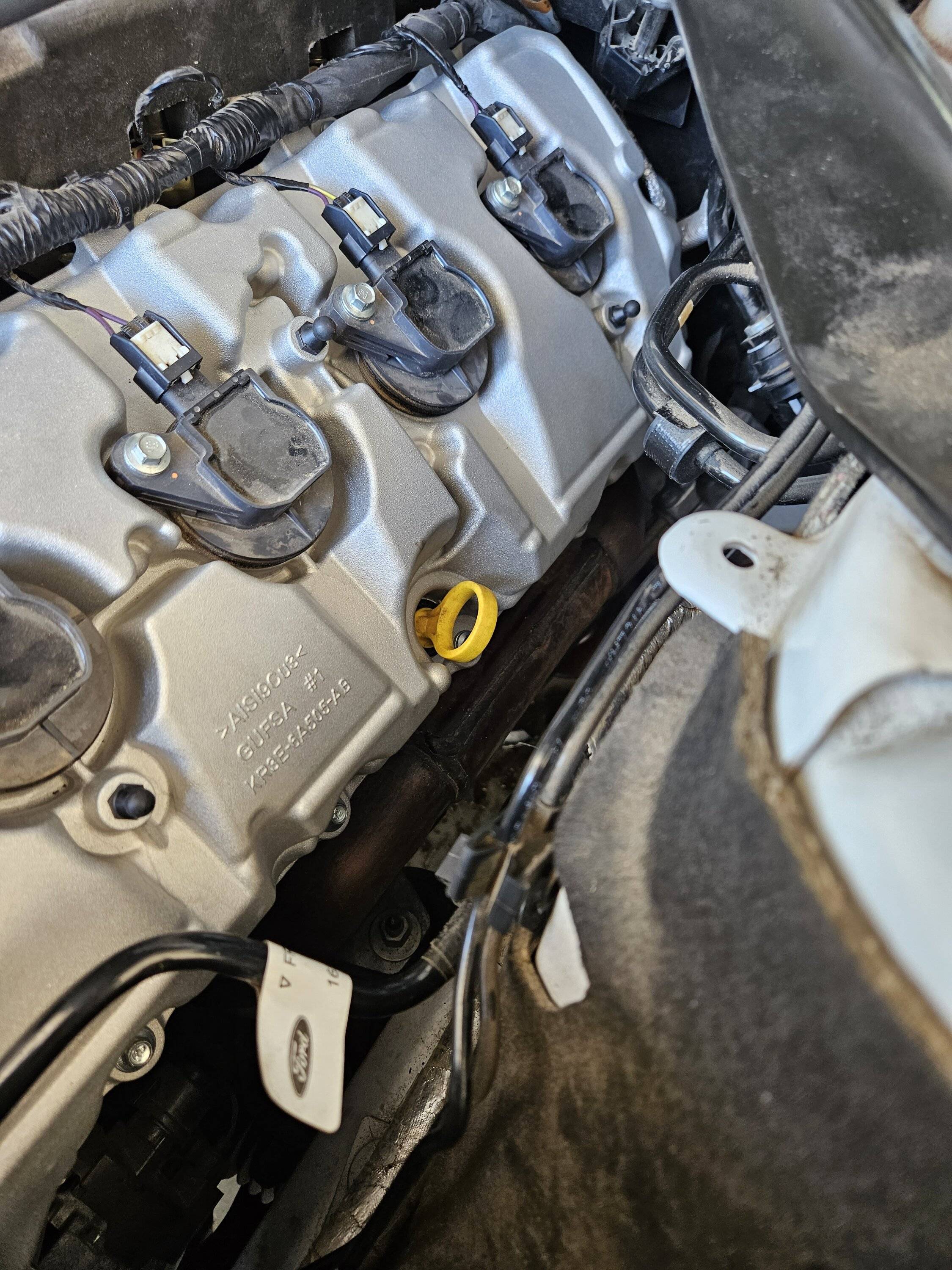

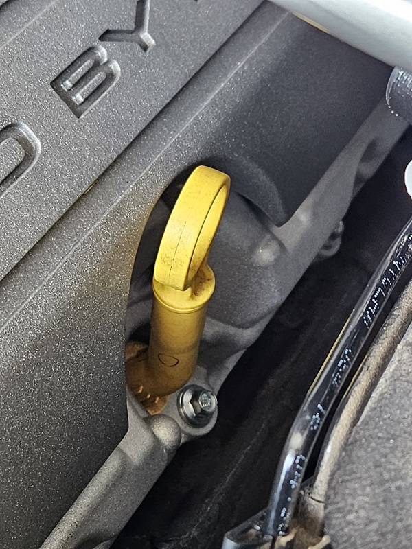

My cam covers had a small leak, known issue for a 2016, but somehow I was not aware of the TSB, yadda yadda yadda I installed new aluminum cam covers from Ford Performance. Ordered from CJ Pony Parts, and it was recommended to also order the GT350 dipstick tube. So I did that and installed everything today, and it went pretty well overall. However, I'm now suspect of the dipstick, as it sinks way further down now with this new dipstick tube. The original tube as a 2" yellow angle, and maybe another inch that is straight. As of now the original dipstick with this new GT350 tube reads way over filled, which isn't the case. CJ's website isn't real clear on this, and I probably need to call, but hoping some of you ran into this already and had the answer. Should I have ordered a new indicator as well?

So. the original dipstick tube does not fit with the GT500 cam covers? Makes sense that a replacement tube that is shorter than the original would lower the dipstick into the pan farther indicating an overfill condition when it is not. With the 350 and 500 having different sumps than the GT it makes sense that the dipstick tube might be a different length, but I am surprised that Ford would redesign the attachment method requiring replacement of the tube. If the tubes are different lengths, then it would seem that the dipstick would also require replacement or modification to be accurate.

They do not mention anything about a new indicator, just the tube. The original dipstick fits just fine, but does go in much deeper now and produces a false reading.

I removed the GT350 tube (not that easy actually) and installed my stock tube and everyone was correct, it fit just fine. Not sure why CJ's site recommends this.
I checked my level a few times this week and it is still showing a tad high, just past the hash marks and the top hole, maybe a 1/4" total. I"m going to chalk that up to the Ford house who last changed the oil. I don't think I'll be going back to them, they done me wrong too many times. It's not over-filled by any means, but their attention to detail is the last thing I'd expect to get right.

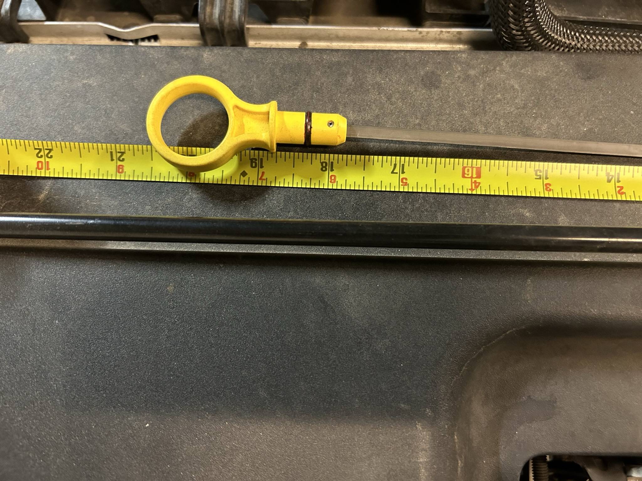

@NightmareMoon if it's not too much trouble could you measure your dipstick? I'm just curious compared my stock one, which measures exactly 21" from tip to o-ring.

NightmareMoon
Nov 22, 2015
7,190
6,495
Austin
2016 Mustang GT PP w/ Voodoo
The difference is exactly the size of that yellow extension on the GT tube. This is the shorter one for the GT350 tube.

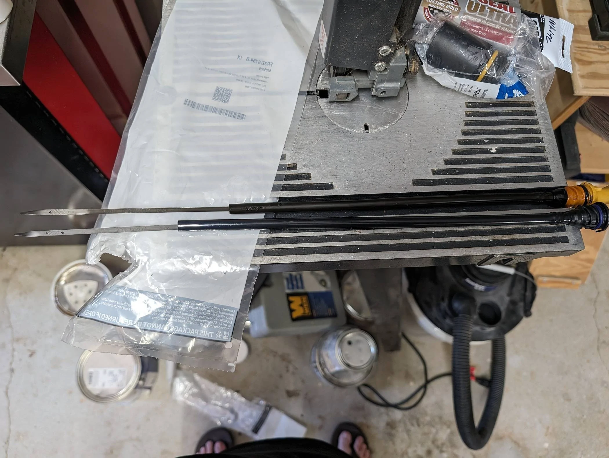

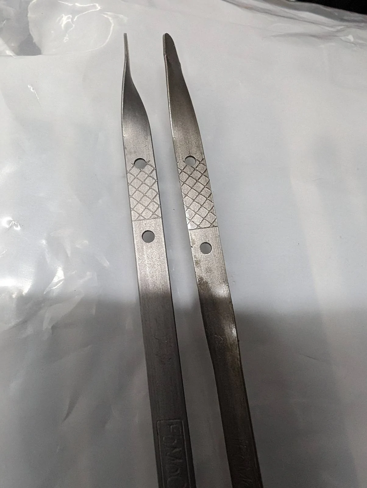

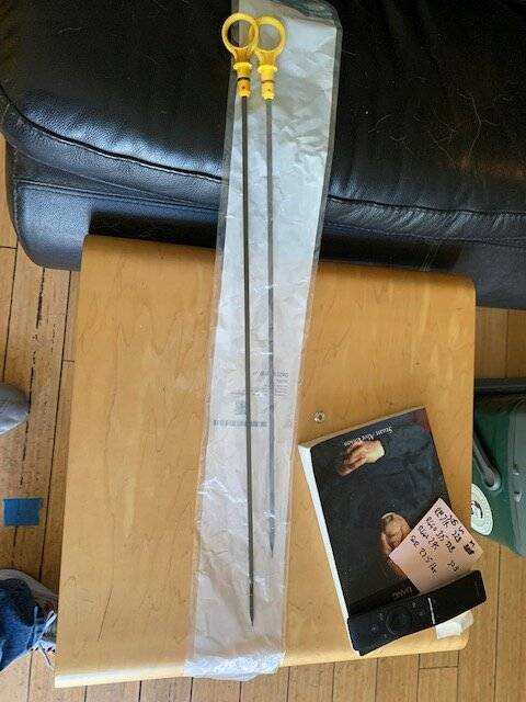

I know this is an old thread, but it still comes up in google search results for people like me looking at the same issue. I had seen a note on LMR's site that they recommended their "GT500 Style Cam Cover Install Kit" for putting the valve covers on a 2011-17 Mustang GT. It comes with a new dipstick, a new dipstick tube, and an oil cap adapter tube to use the original oil cap. I took some pictures with the dipsticks and tubes side-by-side for comparison. The dipstick and tube they include are for a GT350, GR3Z-6750-B and FR3Z-6754-B. My findings:
  • Both dipsticks are the same length from tip to mounting surface of the tube
  • The Low mark is the same on both dipsticks
  • The High mark is lower on the GT350 dipstick
So if you use the GT350 dipstick on this swap on a 2015 GT, the "full" oil level will be a little less oil in the pan than if you used the 2015 GT dipstick. It's also a little harder to reach than the longer GT tube/dipstick, and you don't need the shorty GT350 tube/dipstick to clear anything on the GT. I'm not sure why the GT350 Voodoo has a lower "full" oil level, but I'm going to guess it's related to windage at high rpm or something like that.
I can't see any reason anyone would want to use this GT350 tube/dipstick when putting the aluminum valve covers on a 2015 GT. Maybe S197 needs it? Looks like the S197 dipstick tube might attach differently, but I've never worked on one.

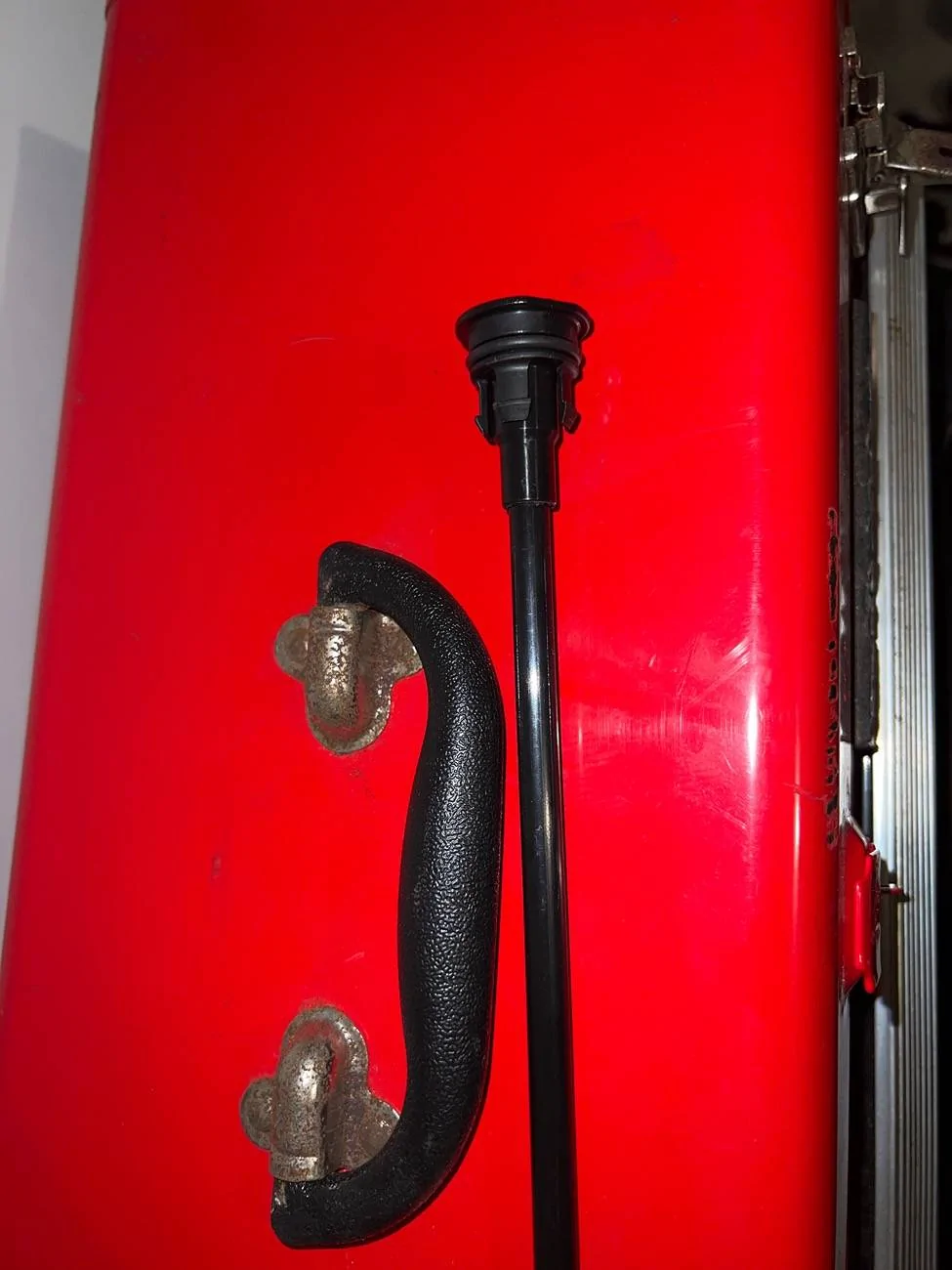

Vermillionaire
New Member
Jul 13, 2024
Paul
2012 Mustang GT
Ok I have a 2012 mustang gt and I put these covers on. My oil tube does not fit at all. It has clips and looks similar to the one they recommend but it doesn’t twist on and just clips on. The one they recommend is no longer made and ford now only has the long yellow one. My dipstick is too short and the new one is too long. I am sticking with the new dipstick because the oil line is right when the twist starts and I have to remember that. Picture of the tube attached..
