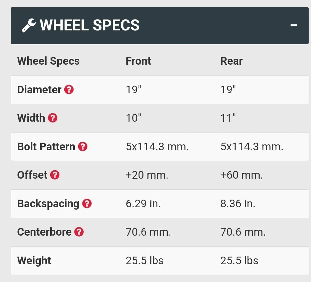

Here's my budget all season set up for my 350R. Not in the PNW but the NE is pretty rough as well. 285 35 19 all around on these wheels. Attached the specs for you. That's the "R" specific set. So you're good. They're heavier than the CF and your wheel studs will show. This set up is a big change from the CF SC2 set up, but there are no problems.
Thank you! You've taken the approach I was trying to consider. I love the big tires of the R, but if I'm cruising/daily/or winter driving on a sunny day, just seems unnecessary. Doesn't seem like a huge price difference, looks like $60 difference. Gives me something to think about. Leaning towards getting some Velgen Classic5 V2 wheels off CJ.

Those PS4S won't do you any favors from late November through April or so up there in Washington state. All seasons are the way to go. Sizes are restricted in the HP All Season category unfortunately. 305 30 20 and 285 35 19 offer some good choices.
