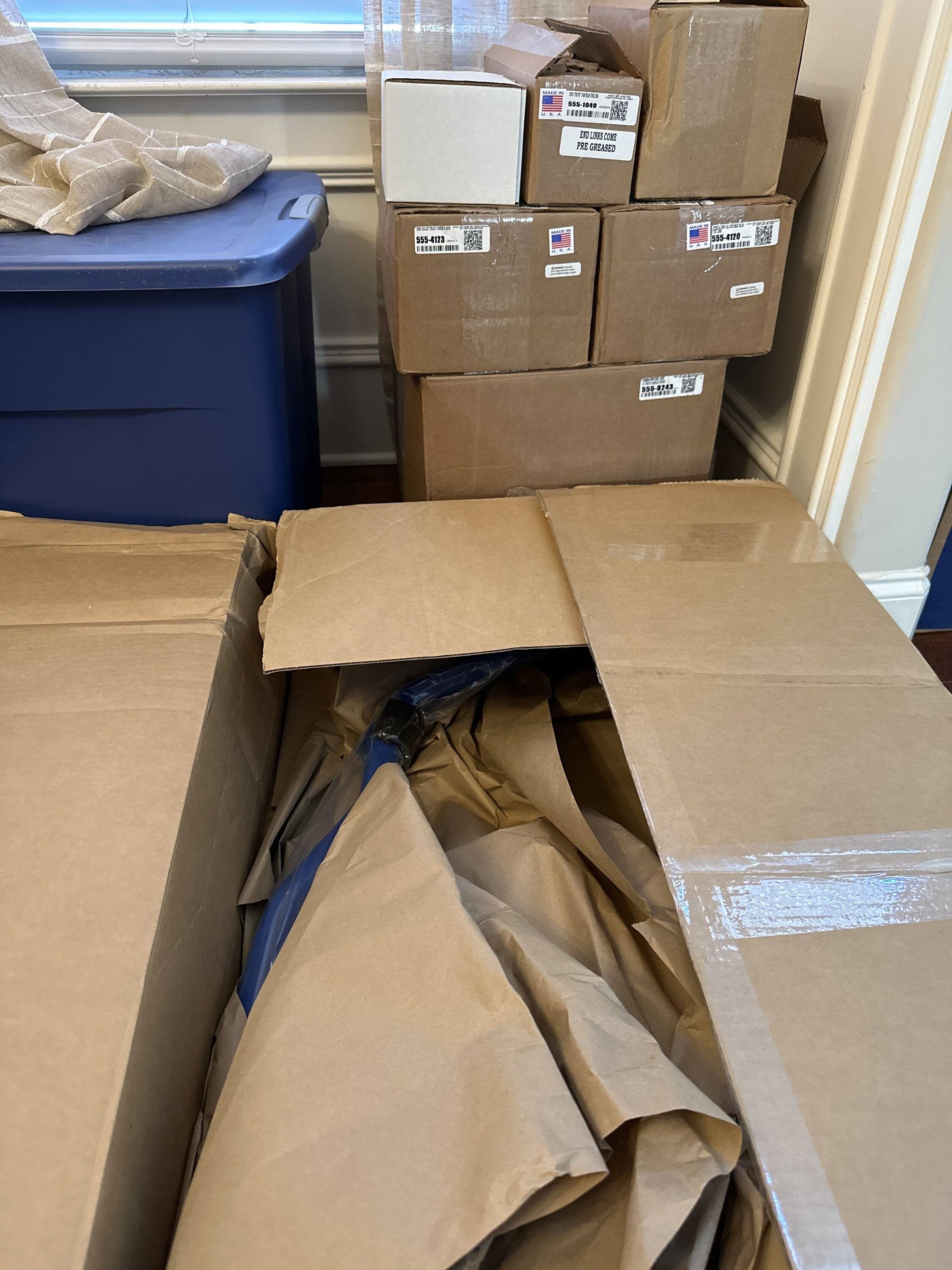

What products did you go with specifically?
Front: sway bars, links and g-track bar. Rear: sway bars, links, adjustable camber, vertical links, adjustable toe links and subframe support.
On hand: subframe alignment kit and dual rate lowering springs.
Waiting to order: subframe bushing and bump steer.
