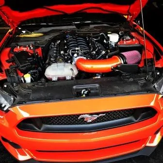

I upgraded to GT350 IM, LU47 Injectors, JLT CAI, and running an MMR TB Adapter with stock TB. I have LUND FF Tune, however, I am on stock headers/cats with MBRP Race catback. The car behaves so much differently! I kept my headers/cats because it keeps volume down and I don't have to come up with excuses if I get pulled over in this emission hell that is CA. The butt dyno can tell a difference in power, especially on the top end. My car felt like it fell flat at 6500 RPM, but now it just keeps pulling, like it doesn't want to stop, all the way up to 8k RPM. I've hurt some feelings that people weren't expecting from my stang. Love it. Highly recommend, especially if not going FI. :headbang:

I had JLT CAI and FF Tune. The butt dyno can barely tell a difference in lower range. To be honest if I'm rowing gears I don't feel much difference in the mid range at all. Normal driving, I can tell a minute difference in very low RPM from before, but it's honestly miniscule, because once power comes back and keeps pulling, you forget about it.... I'd say real world difference is someone getting a slight jump on you for a few feet. If that makes sense?

I'd say I can tell a difference (loss of TQ) under 3500 rpm. To me this is normal driving range. And yes exactly, large differences are felt the higher in RPM you go. Over 6k rpm is where the real big differences start and where it shines. Honestly the loss of TQ/power in lower RPM isn't a big deal to me. I don't honestly feel it as much. You definitely notice the top end. Yes, down low you lose a bit, but if you're shifting at 7500 rpm or higher, next gear is already over that low end RPM range, and into the RPM range where the GT350 IM is making more power.

Yes I know it isn't CARB compliant. But I'll deal with that when smog time comes. LEO's around my area are much quicker to look for cats than to pop a hood.
I like the JLT CAI, adds a nice look to the engine bay. Wasn't a fan of the GT350 CAI either, that's the reason I went with JLT. Do have to say though that sitting idle in traffic sure does make IAT climb pretty quickly. Only negative thing I have to say about it.
