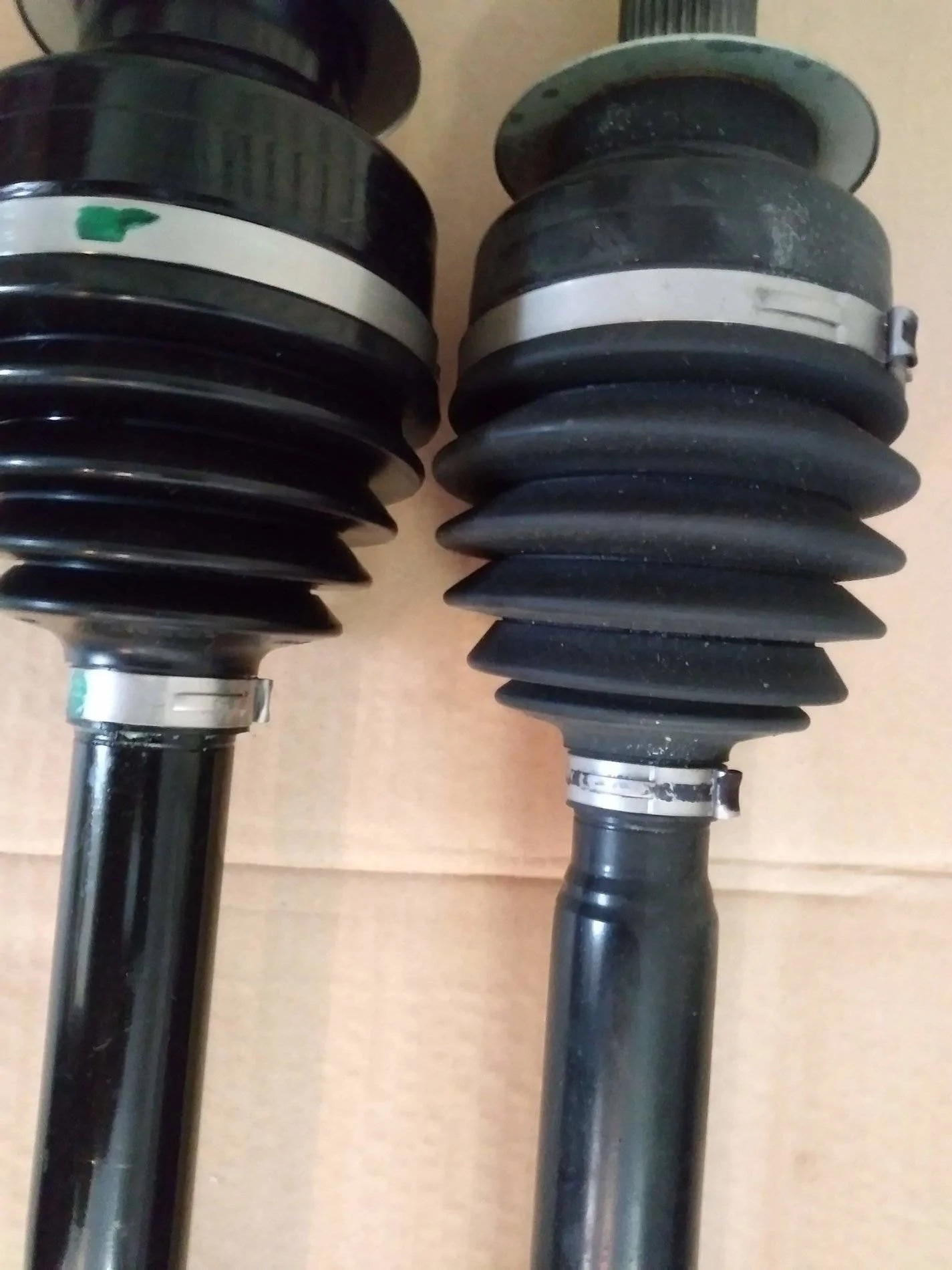

The 350 left side axle is a great upgrade from the stock axle on a non PP 2018 A10 GT. It is a direct fit. The 350 axle is about 4.5 pounds heavier, has larger CV joints and doesn't taper down at the ends like the stock unit. Unless you go boosted, I think you will be fine with the 350 axle. The left side stock one is the one that usually breaks. I don't think there is any difference in the right side between a stock GT and a GT350.
Thanks for the pic and the info, l am picking up a new set from a member this weekend. He ended up not using them and they are new in the box. I also just ordered a ported intake from Beefcake Racing, goin to try and get the car into the 10's with stock converter and gears.
