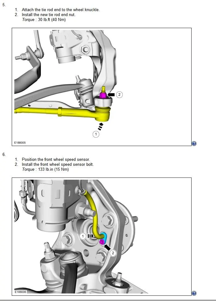

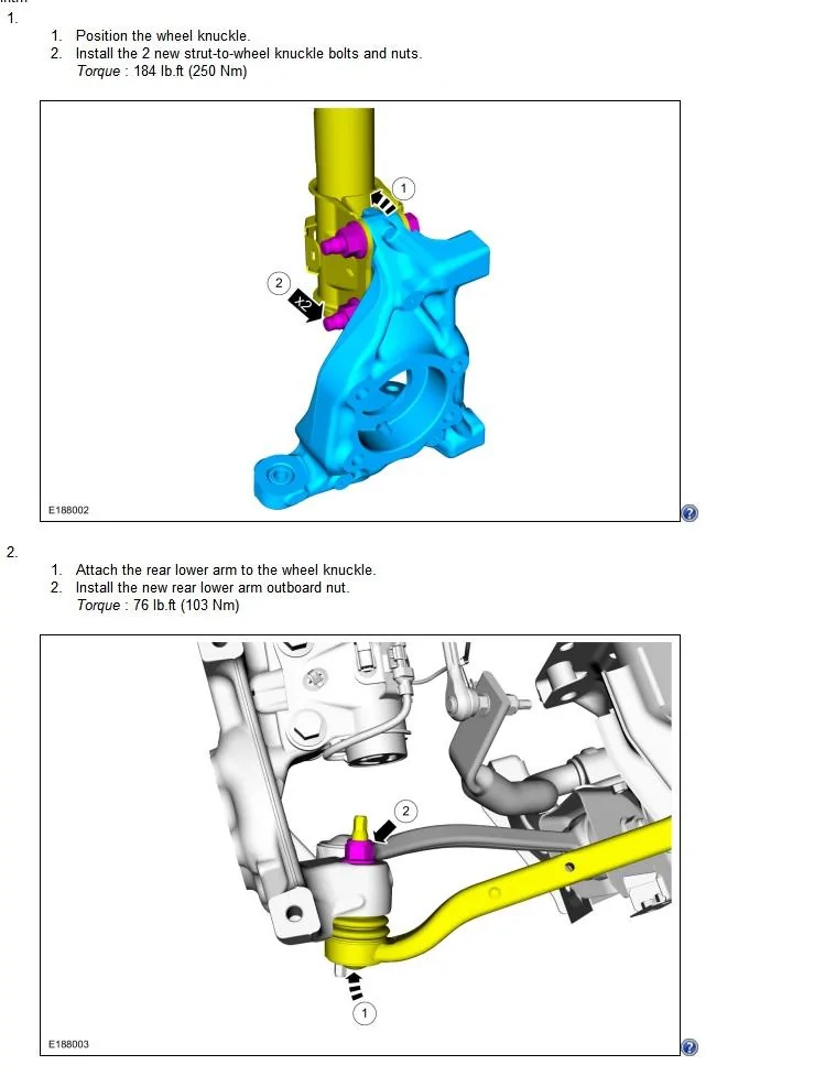

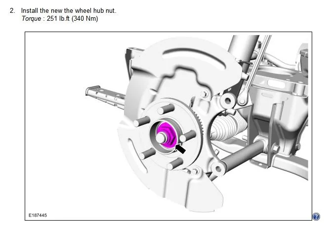

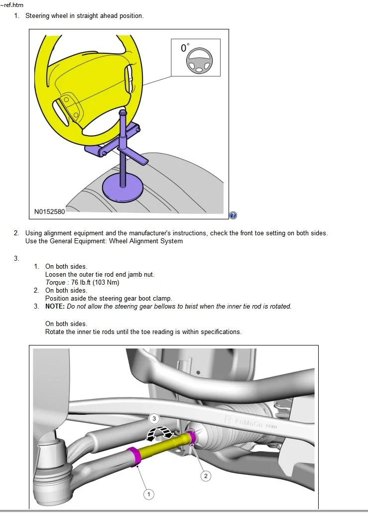

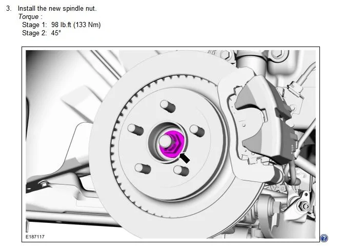

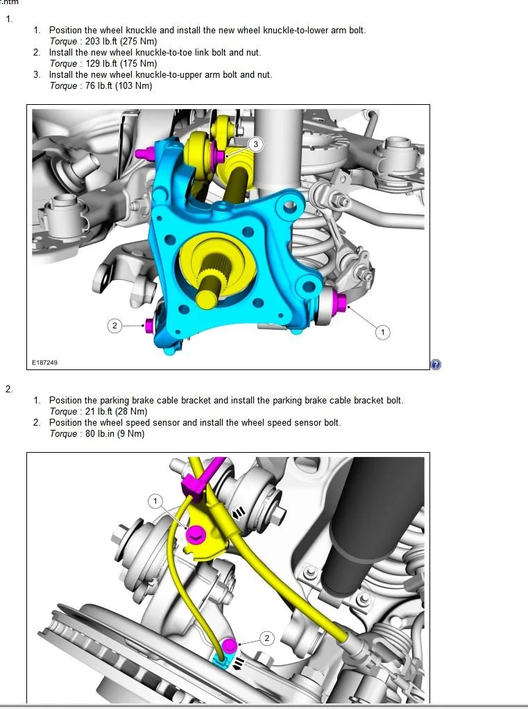

    2   0   0

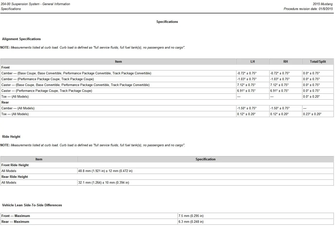

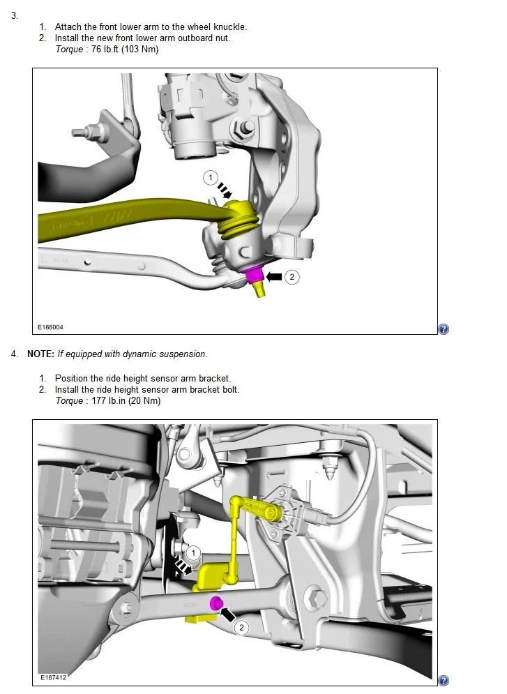

    Some more to add to the list. alignment.jpg front Wheel hub.jpg rear wheel hub.jpg rear wheel knuckle.jpg toe rod front.jpg front knuckle (svt pp).jpg front knuckle (svt pp) 2.jpg front knuckle (svt pp) 3.jpg
    Vroom, Coaster and Digital_Synapse like this.

    First off, thank you so much for gathering and posting all this information.
    I'm planning on installing some BMR lowering springs, but I only have a floor jack and no access to a lift. How would you recommend I clock the bushings? Do I need to try and put the car on ramps?

    0   0   0
    I had the shop that did my alignment take care of mine.
    As far as I can figure the best you can do is put one axle on ramps at a time and clock those bushings. The loading isn't perfect but should be closer than doing nothing.

    0   0   0
    I thought the upper strut nut(the single one that people have issues with the shaft turning) was 76 ft/lbs.
    It's actually 184? It's late and maybe I'm reading the specs wrong.

    0   0   0
    I clarified that now so it is easier to understand. The single nut is 76.
