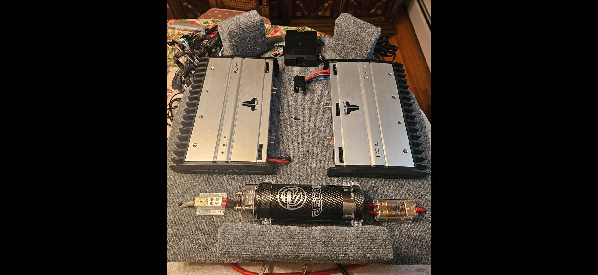

Here is the amp rack im building. I just have to hook up thr rca's and speakers wires and its done

Is that the underside or top of the cover?
Do those amp ends elevate the amps off the carpet at least 1/4 in? If not definitely want to do that so they get nice convection cooling.
