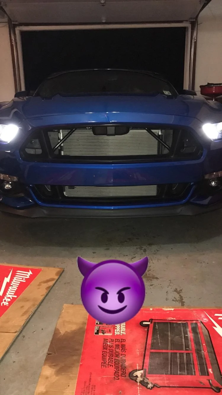

Grille delete is the way to go. Looks really good and helps with airflow. We have always done these grille deletes to all of our shop cars and we're located in South Florida, so it is almost just as hot and humid as where you're located.
Nice. Thanks for the info and the photo. I'm getting ready to install some Velossa ducts, and will be doing _something_ to the OEM upper grill, just not sure if I want to go totally open (like the car in the photo), or do some kind of mesh just in the center section (definitely leaving the corners open with the new ducts). I'm up in St. Augustine, so another high heat, escalating IAT location, and most of my driving is around town between 25-45MPH ...
I hit a small bird a few months ago at 55 mph and very little made it through. Did have to clean my grille a bit.
OK, am I terrible person that this made me laugh out loud ... :lol:

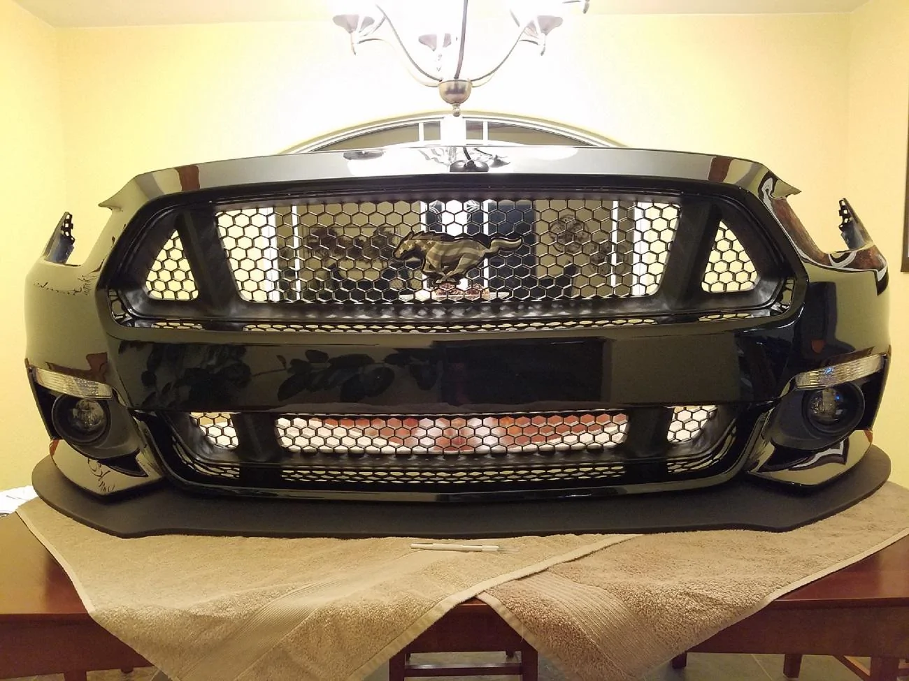

Using a router, I opened up all of the honeycombs both upper and lower. Before putting the front bumper cover back on, I also placed some washers on the upper mounting posts of the radiator support to get the front cover just above the height of the leading edge of the hood.
Not only do I now have less hood flutter, my IAT temps are about 2* cooler at highway speeds. Most importantly, however, are how much more quickly those temps come back down once moving. Subtle, yet nice looking mod in my opinion as well.

Nicely done, holy hell, that must've taken some time (and patience).

That Looks way better than a delete. I have the gt350 intake and today it was 92 outside the iat were steady at 98 cruising on the highway.
Can you post pic of your washer mod?
Thanks! Really it didn't take that long with the router using a 1" bit. However, it was really messy as there are small plastic shavings flying everywhere!
