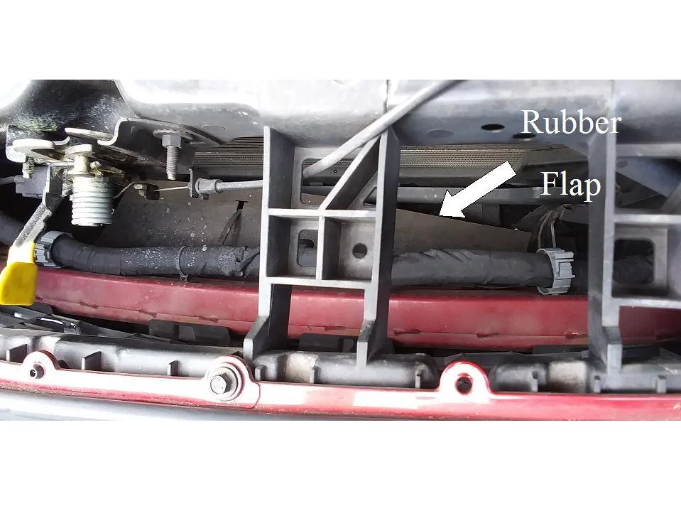

So I removed the trim panel above the radiator, etc and the nose to see if I can modify the Grille Shutter Motor operation and I discovered I have no Grille Shutters. 🤔 What I have instead is a rubber flap that is "mounted" horizontally between the back of the "bumper" and the AC condenser. See image...

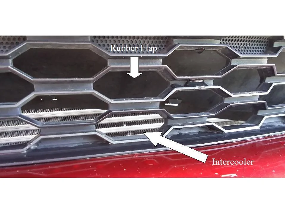

You can see it has 2 little "stays" that attempt to hold up the flap at the center and passenger side. But on the driver's side there's no stay to hold it up. I can see the flap hanging down in front of the intercooler on the driver's side ...

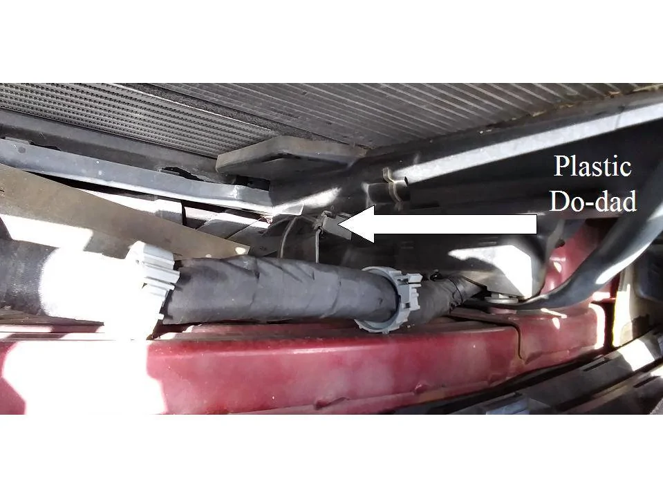

There's a little plastic Dodad on the driver's side radiator brace that holds the rubber flap down so that it covers about a third of the intercooler ...
I messed around with the plastic Dodad for a while in order to reposition the driver's side of the rubber flap but I didn't achieve very much. I suspect that as soon as I drive the car the flap will just end up back where I started.
Does anyone know how this flap and plastic Dodad are supposed to be mounted? Or is the flap supposed to hang down in front of the intercooler on the driver's side like mine does? Will sufficient airflow (Ground Speed) cause the rubber flap to extend out fully horizontal when the car is moving? Based on how my car is set up I still think the plastic Dodad will prevent the driver's side from moving keeping that side of the intercooler covered.
I'm not sure what the point of the rubber flap is. My guess is that it is intended to prevent the heat from the AC condenser from soaking the intercooler. For the most part I think it does, except for maybe a third or a quarter of the driver's end of the intercooler.
Thanks for any ideas gang.

I assume you bought this as a used car? If so, the previous owner may have removed the shutter assembly. I don't believe the rubber flap you have is a factory installation.

I believe the part you are referencing is the same I had questions a while back in this thread:
https://www.mustang6g.com/forums/th...stion-about-part-near-ic.142243/#post-2915179
I dint believe that flap is to be down in front of the IC at all and it has no purposes when moving/driving, such as what the active grille shutters do.
It seems like it is to be laying above the IC so that air is directed through the IC and not past it. Take a look at the images others have posted in that above thread.

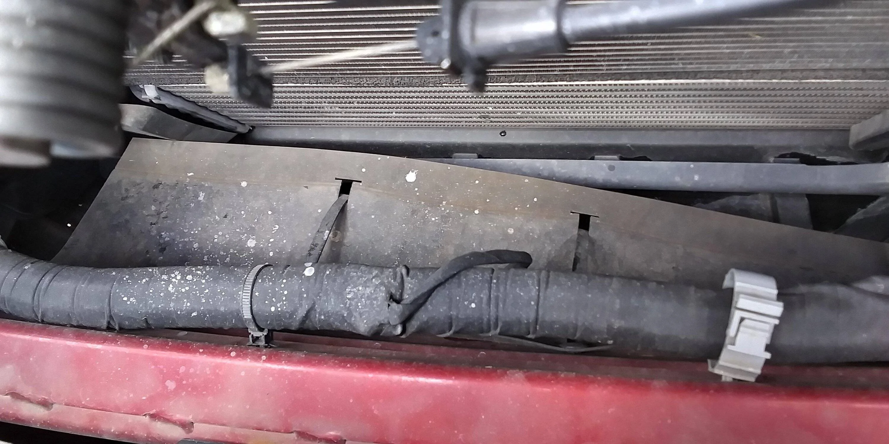

Rod, Yes I did buy the car used but I'm sure that the rubber flap is OEM. It's attached to the rear of the bumper bar with 3 or 4 of those plastic "Christmas tree" rivets. It also has slots stamped into the rubber for the 2 "stays" that are supposed to hold it horizontal. And it also has a sensor that mounts into the rubber flap up against the bumper bar. Not sure what the sensor is but I suspect it's an air temp sensor. Probably the outside air temp sensor on the touchscreen display.
Based on the images from the links in this thread it appears that mine isn't the only car that suffers from the rubber flap blocking part of the intercooler.
Thx everyone. I guess I'll just leave it alone since it doesn't seem as thought there's a good solution short of removing it entirely. I'm not convinced that removing it will improve things much. It should provide better airflow over the intercooler but it may also result in more heat soak from the A/C condenser as well. Since I'm in Florida the A/C is on just about all the time.
