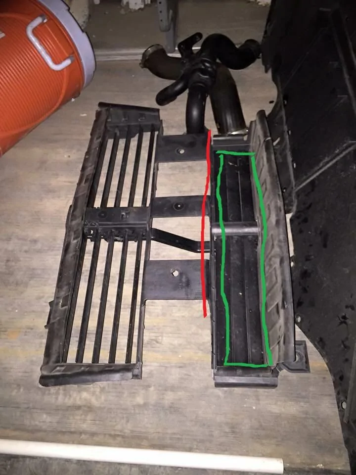

So, here's my journey with these active grill shutters.
When I first purchased my car I immediately bought a new grill because of how ugly the stock one was. Personally I find the gt grill the most attractive once you do a "delete kit" on it. Anyway back to the story. So I removed the upper and lower grill and noticed the ungodly AGS system, so I removed it. This was the first time I've removed it. Well after I removed it I guess I snagged a wire on something and it snapped without me knowing and blew a fuse(which I didn't know at the time) well I live up near mount rainier in Washington and I was taking my wife to see the snow. That wire that I snagged tapped the frame.........well that wire was connected also to the fuse that regulates the turbo waste gate. Idk if you have ever tried to drive the EB with a turbo not building boost but it's scarier that hell. And it just so happened to go out when I was passing someone. That motor without the turbo is horribly slow. Like 2008 Ford Focus slow. Anyway took it to ford they fixed it.
Second time removing them. Took them out pulled the AGS motor. Zipptied it to the frame. No codes. Car works fine.

I removed my AGS, zip tied the motor to the frame too......I have noticed no changes...I'd imagine only better cooling to radiator and intercooler
