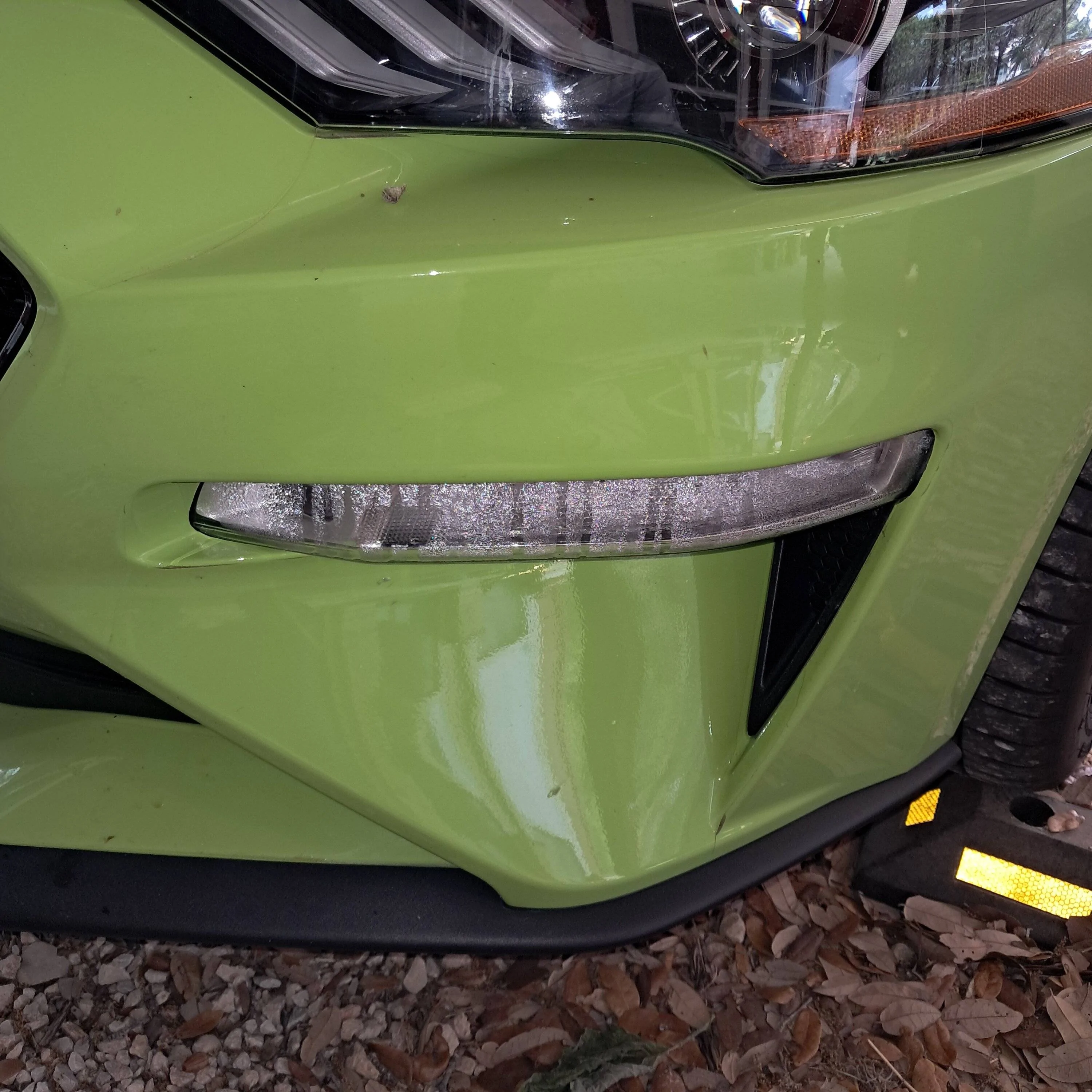

Got a little green house going here......

Someone please tell me I don't have to pull the bumper off to get to that lower light.......

Should be able to turn the wheels to the right and reach up there.
The fender liner is in the way.
I've got to change the oil before I sell it, I'll see if I can get to it from underneath with that aero piece removed.
Was just wondering if anyone knew for sure.

Any reason you can't detach and move the fender liner? I was going to suggest that as probably the easiest way to reach the light.
I'll take a peek at it this weekend. Probably just push pins holding on in?

Remove wheel, pull fender liner back (simple retaining clips), and you have easy access.
Why are you changing the oil and bulb before you sell it of you are trading it in the will do that themselves

Yes take the fender liner off it’s very easy
