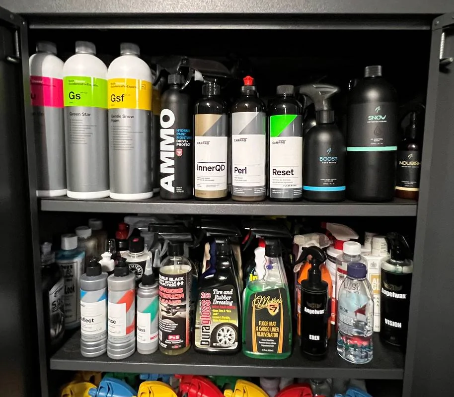

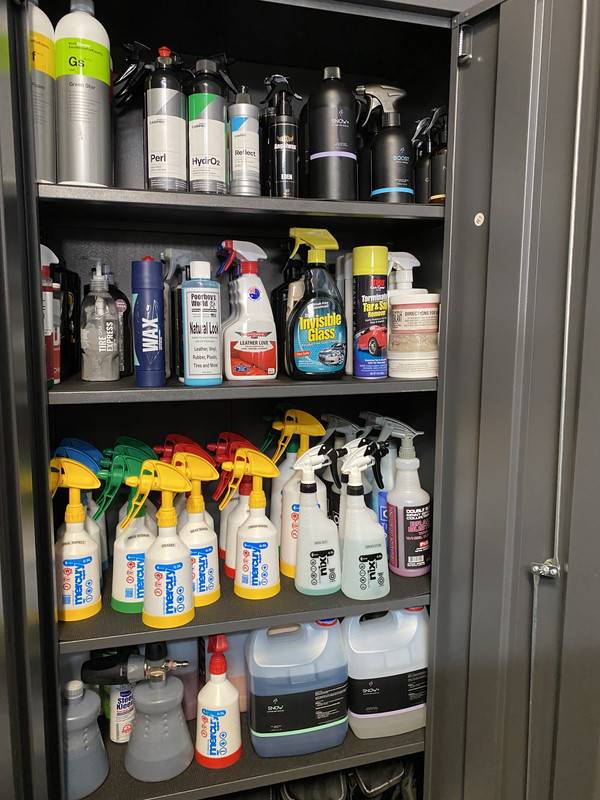

I think the pics below best describe what side of the fence I sit on regarding that! :giggle:
I put a lot of thought into my detailing responses. I'm privileged that I can splurge on any detailing product I like. I also understand not everyone can spare or justify $25 on a small bottle of water-spot remover. That's why I tend to offer options that suit everyone's individual situation rather than "this is the product you MUST buy".
In terms of why would someone choose a specialty product over a home made one, convivence plays a big factory here. I want a product I can buy and use that does its job well without stuffing around with mixing and bottling. CarPro for example will have spent countless hours and dollars tailoring each product to do what it says on the label and I in no way doubt that ability. So, convivence and better results form my choices.

Love this. I've got a similar cabinet and 99% of people just don't understand why anyone would have something like it.
Unfair question and potential hi-jack:
Out of all the products in here, what is your favorite one and why?
I recently got on the GSF train and now I use it on everything - from cars to patio furniture and windows.
