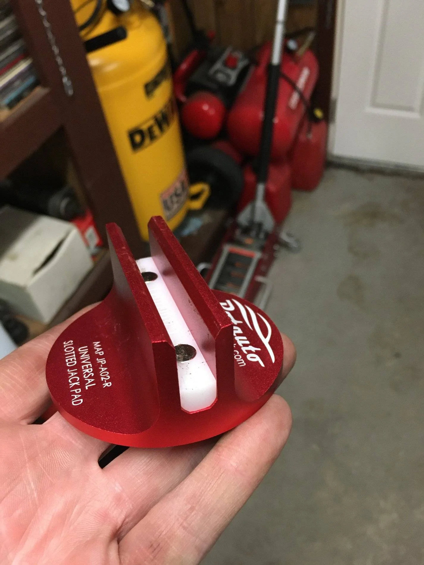

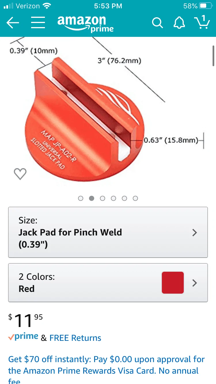

Buy two of these. They are AWESOME. I didn’t feel like adding 30lbs of weight with jacking rails.

i like low cost solutions but bmr cjr002's only weigh 13.76lbs, work great, and seem to stiffen the car

13.76lbs EACH yes.... They do NOT stiffen the car.
