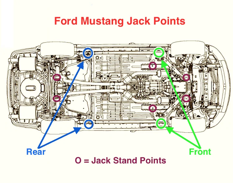

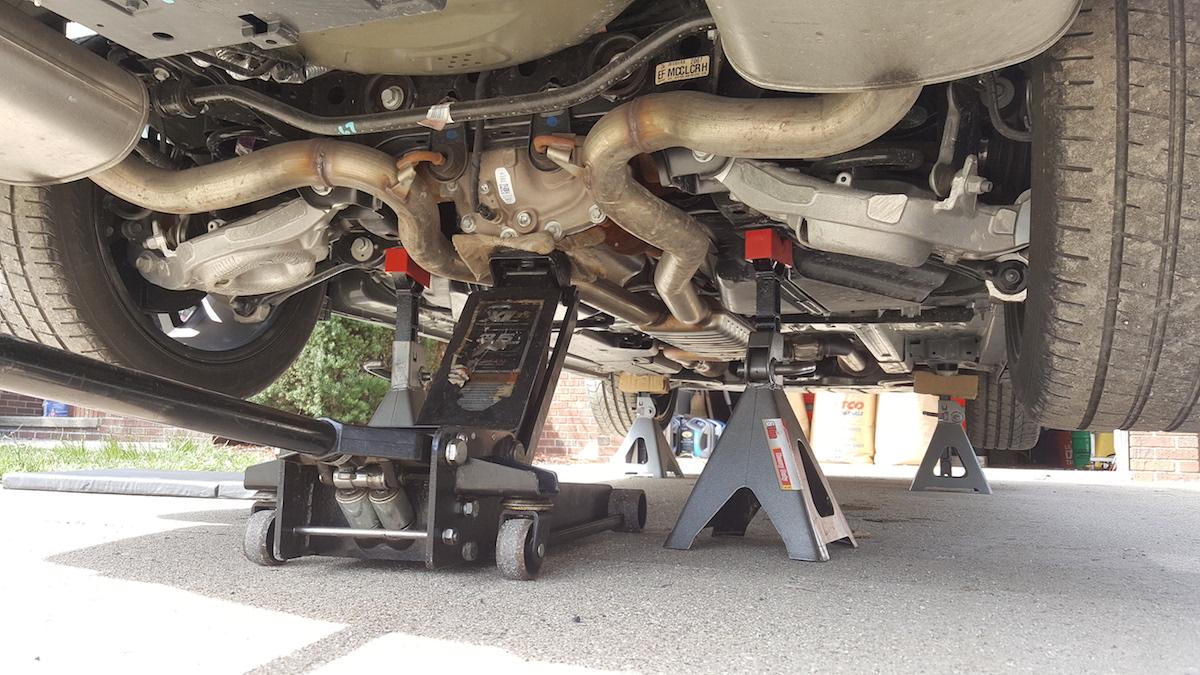

Might not be model specific but the same. For the rear I usually use the diff/pumpkin with a soft piece of wood sitting on the jacking plate.
After owning a few cars with a center jack point, I find this disappointing.
Small price to pay for IRS. I got a cross beam adapter for $30 + tax to lift the rear. I will raise the front with ramps as usual for oil changes.

According to this forum if you jack the car by the IRS the car will explode. Still waiting for mine to explode.
Dumb question but no so much explode but wouldn't that put pressure above the pumpkin? Or is that why it isn't recommended?
The problem is the pumpkin is bolted to the chassis via a few horizontal bolts. In operation those bolts just keep the diff from falling onto the ground. If you jack the car up by the diff, those bolts take on the weight of the back half of the car. So you have to ask yourself "Do I feel lucky?" [/Dirty Harry]
