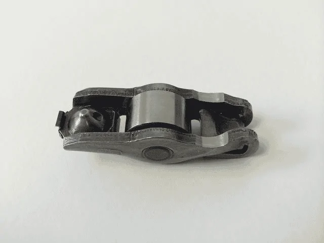

MMR rockers are half-assed ?
I’m learning, so could you explain this.
They require maching to clear the nose of the cam because the geometry of the Voodoo valvetrain is different from the Coyote.
Honestly, that looks like a legit modification that doesn’t appear to compromise the integrity.
I wouldn’t hesitate using those to fit the GT350 heads.
