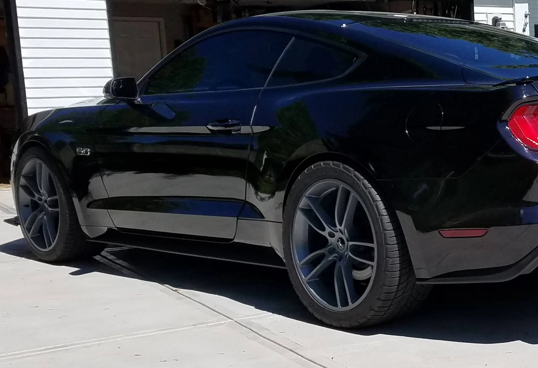

Why do you have nearly 29" tires? Are these drag racing slicks that need lots of sidewall?
Simply going down to some 26.7" tires will make a big difference in gearing and it won't look like you're driving around on truck tires.

315/35 I don't think they look like truck tires plus potholes
