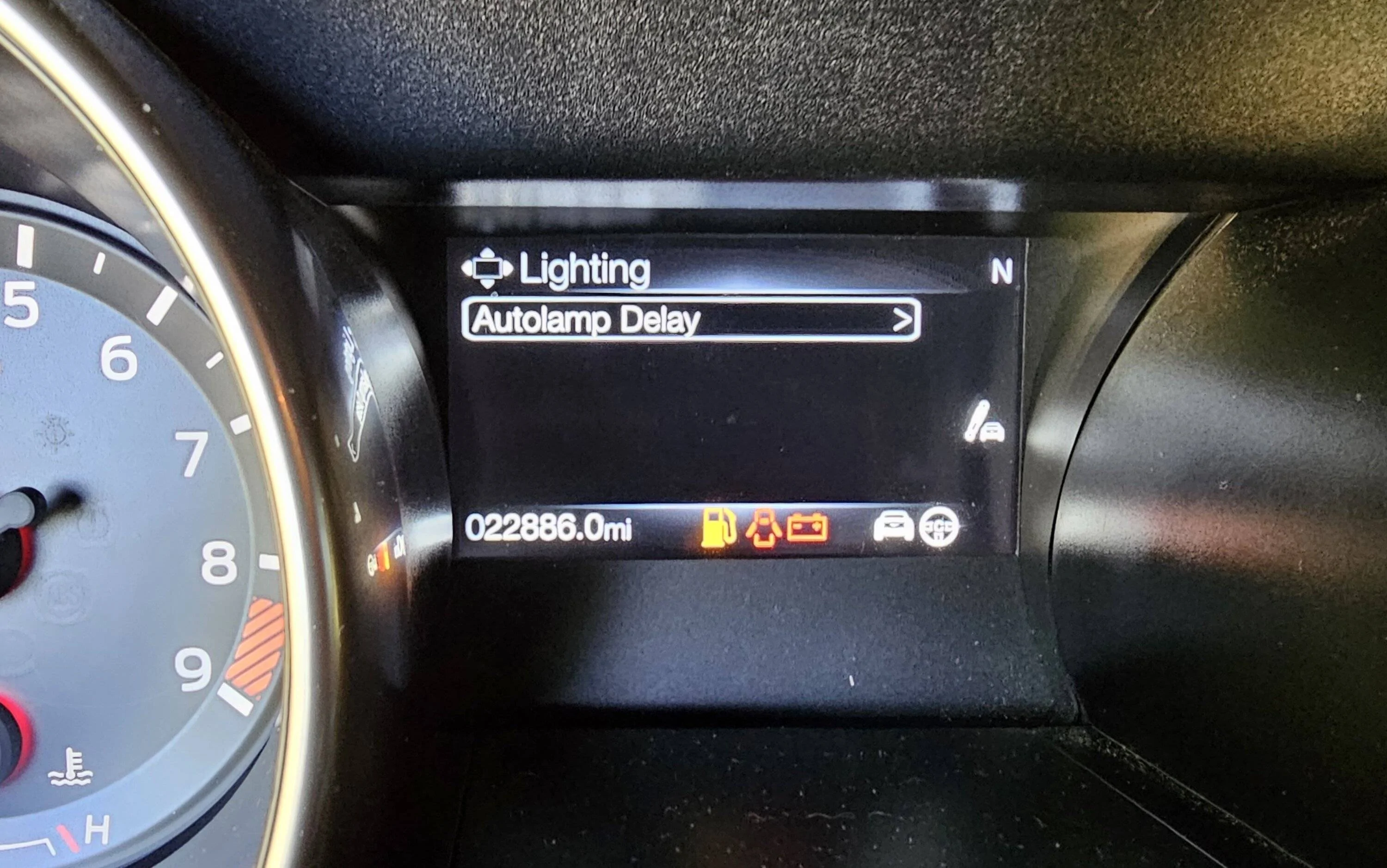

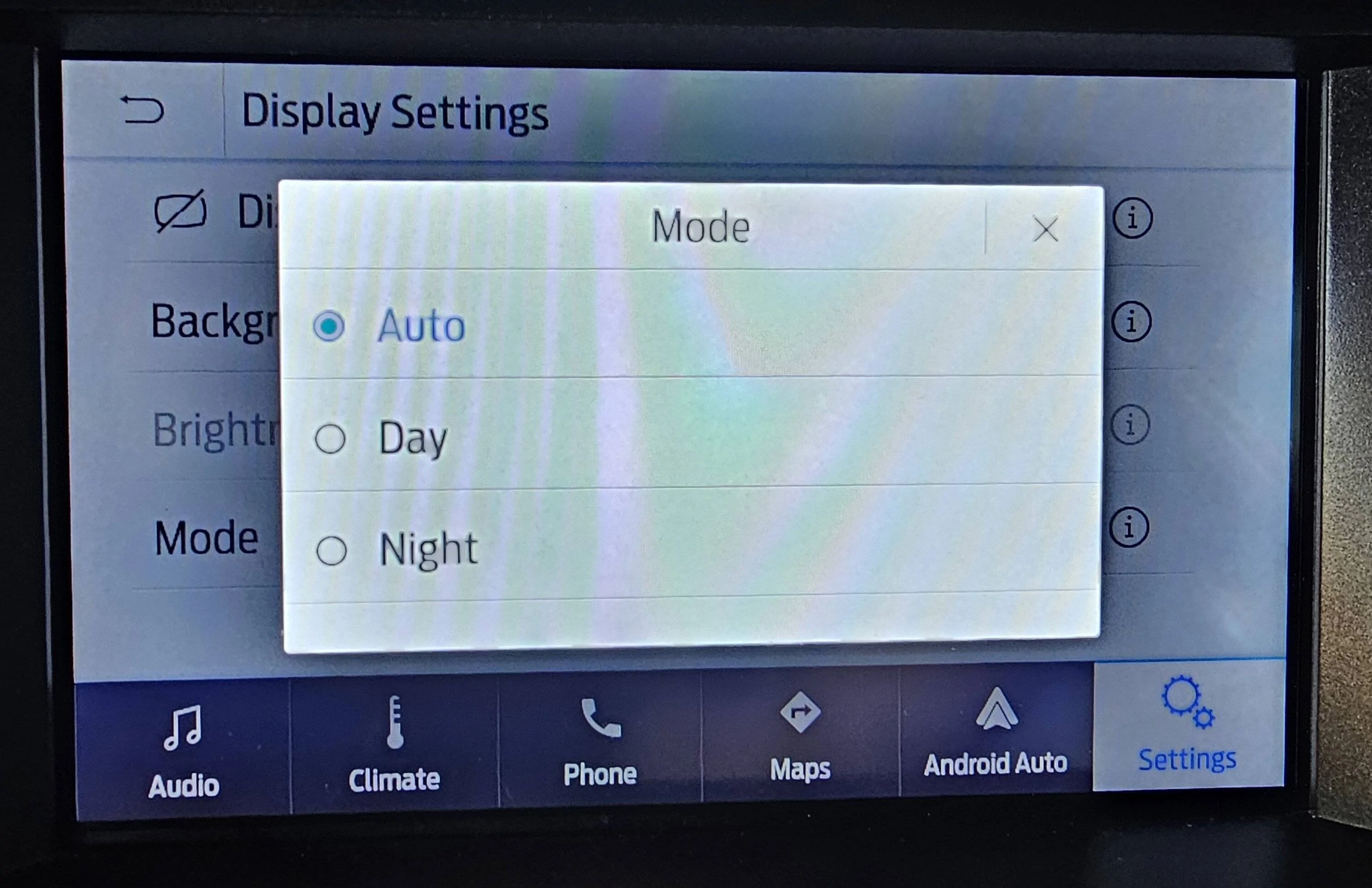

It does have a night setting, which does help. But it doesn't control brightness. Brightness is greyed out. And, there's no adjustment for the center LCD screen (other than dimming everything).
The only lighting adjustment in the center LED is the autolamp delay.

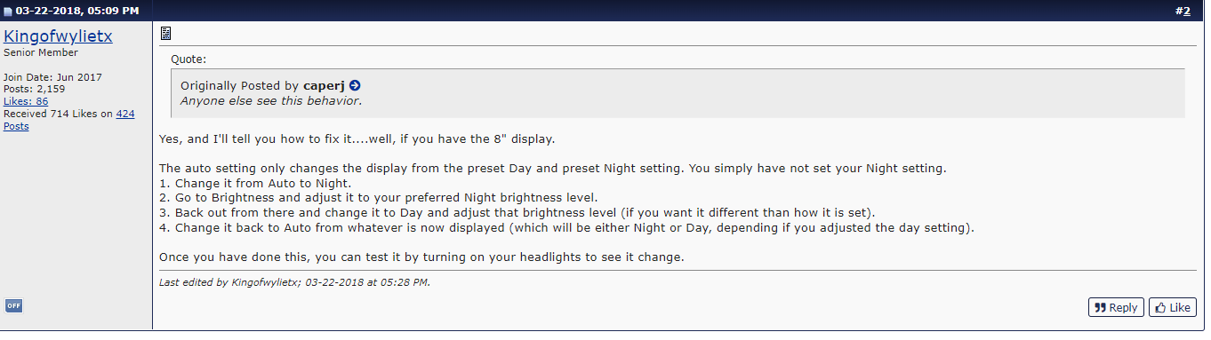

OP, I'd bet forscan has something. It's really odd that your "brightness" is grayed out. There has to be a setting that is blocking that out. Found this on an F-150 forum, worth a shot:
Basically, put it in night mode, exit out of menu, then brightness should be available. There is also mention in that same thread that this bug should have been fixed in Sync 3.4, so make sure you have the latest Sync on your car.
