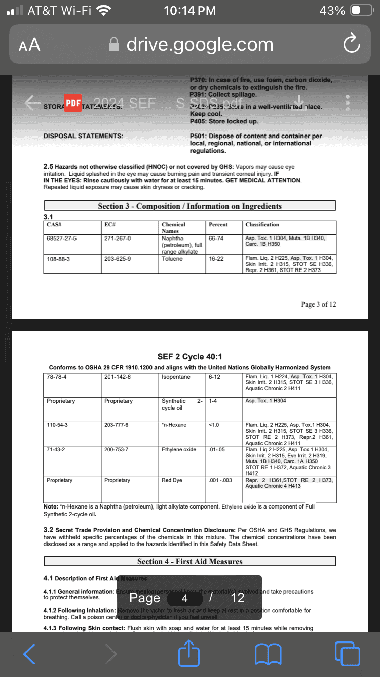

What are the additives in the VP 2 cycle engine fuel?
I suppose I could just add oil to turbo blue, might even be cheaper....
VP 40:1 is close to Tru-Fuels formula.
Cheaper would be to wash 93 and add 3.2 oz per gallon of Non-detergent SAE30 oil. I’m partial to Klotz R50 or Maxima K2 or SuperM.
Klotz exhaust aroma is race fuel sweet.

Looks like it is only missing xylene.....

e10 93 in the summer. Winter gets us better fuel.
(quoted)
“Summer-blend gas has a lower RVP to prevent excessive evaporation when outside temperatures rise. Summer-blend gas contains 2 percent butane, but that percentage is higher in the winter blend.”
Isopentane = methylbutane
Note; the VP 40:1 packaged fuel is 6-12% Isopentane !
