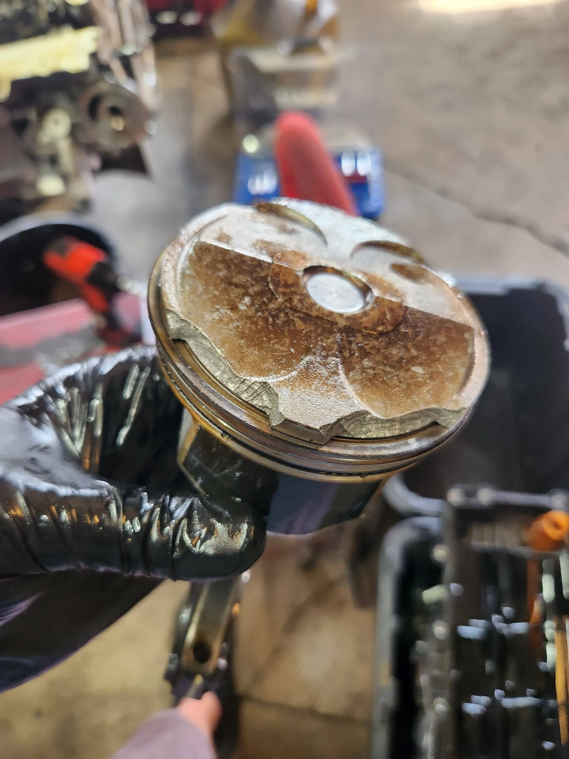

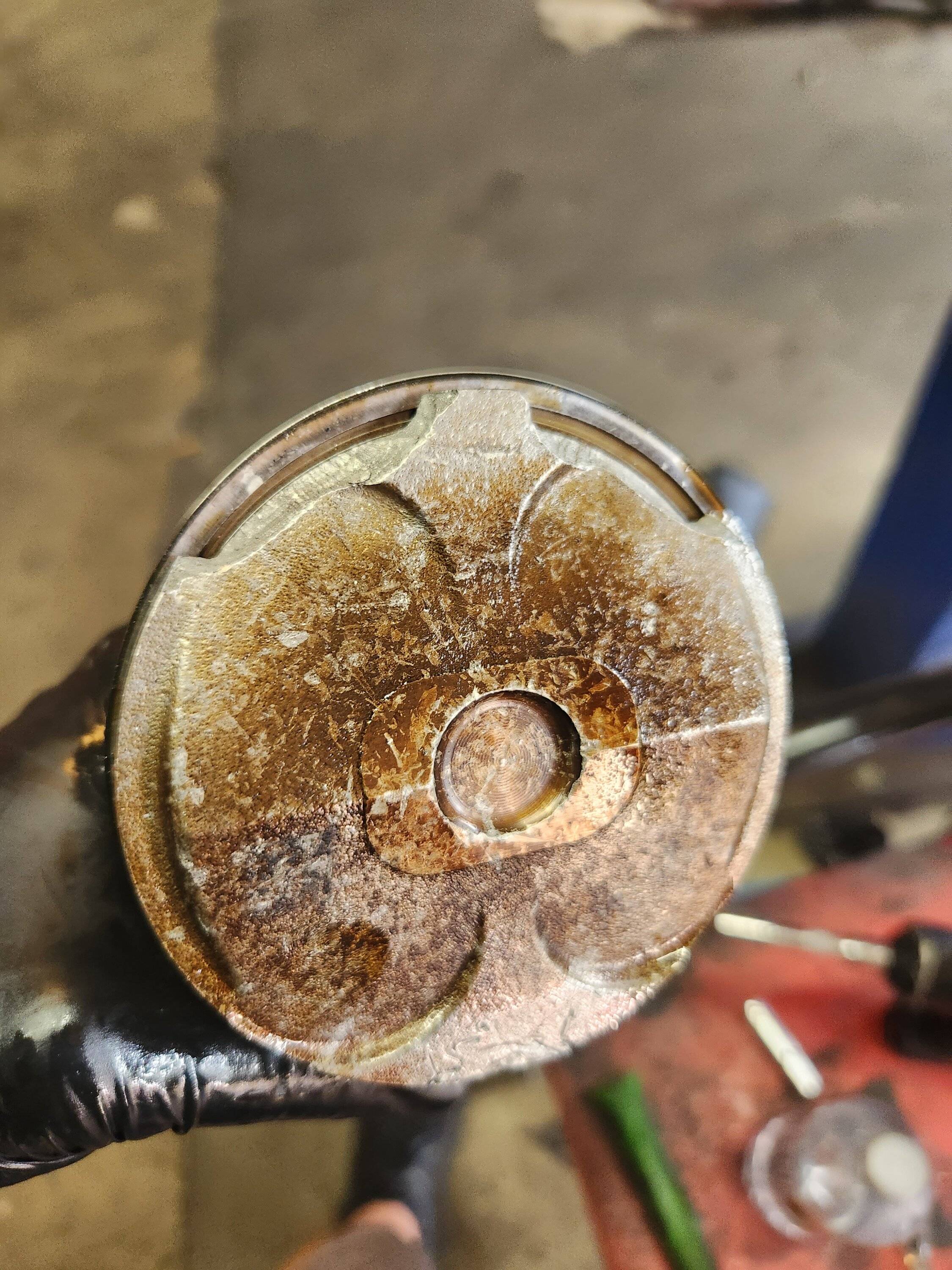

The issue, for me at least, would be the ring land area of the piston. I had my stock .009 gapped rings get where they were essentially gapless at about 7500rpm due to boost and heat and THIS happened...
😲 What indicators did you have to let you know of this catastrophic failure?
HKusp
Jul 22, 2021
39
2,305
2,953
Hampton, Md.
Jason
2018 Mustang GT
The car wasn't pulling as hard as it was a few minutes before while racing 2 GT500's from a roll of about 60mph and I let off at about 110ish. When I did, I heard an audible pop and the check engine light started flashing, the AC started cycling on and off and the engine sounded, smelled and felt like it had a misfire situation. I limped it home about 75 miles. You can read a little more detail about it here.

The car wasn't pulling as hard as it was a few minutes before while racing 2 GT500's from a roll of about 60mph and I let off at about110ish. When I did, I heard an audible pop and the check engine light started flashing, the AC started cycling on and off and the engine sounded, smelled and felt like it had a misfire situation. I limped it home about 75 miles. You can read a little more detail about it here.
I don’t really understand how this applies

If a gapless ring expands due to heat what is going to happen to the top of the piston where it has a weak point?
