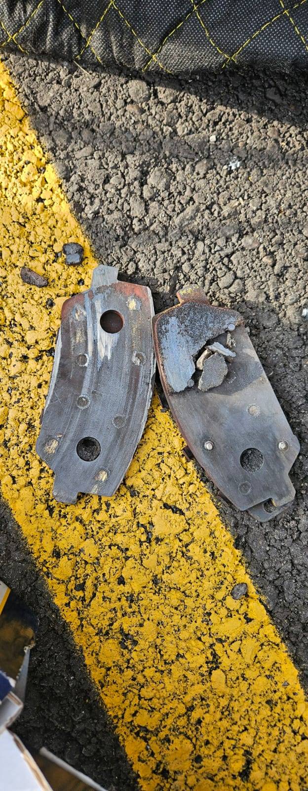

Yes I did love this pad set up which is what I ran! However I obviously reached the maximum temperature or had a bad pad because I ended up bending the quarter inch steel backing plate. I am probably going to move to a R12/R10 or a R16/R12 combo for the future.
Yeah, definitely. Using R16 pads on the front and R12 on the rear would give you better braking performance and heat tolerance, which is great for aggressive driving, racing, or frequent track days.

For what you do and what you drive, I would not put R10's either.
I think I need to replace my Pagids RSL after track event too 😆 . (not mustang, the other car)

It looks like you got your money's worth here at least?

Yeah, they gave me everything they could and heroically disintegrated after last session. :ninja:
