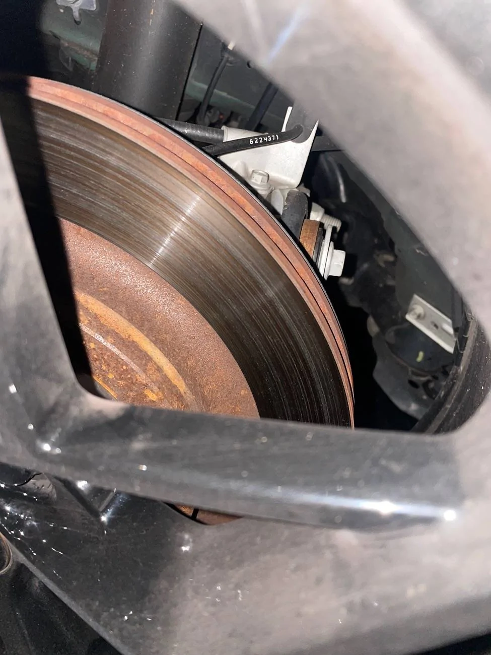

I have had my GS-1 pads start squealing, only when braking lightly. Under medium brake pressure they are silent. Have you had the same experience. I was beginning to think I glazed them. This is a picture of the rear rotor. Thoughts @gone_n_60 ? You think that brown stuff is glaze or just rotor wear?
My GS-1 began squealing after a time as well. I couldn't get rid of it no matter what I did. Others didn't report the same issue so idk. I tried reinstalling them and even sanding down the rotor surface but it didn't help. The R10/R8 combo squeal was wayy louder though.
I have glazed them on one occasion when I was pushing on the street backroads too hard. And honestly, that surprised me. I'm not sure what you've got there. It isn't rust? How old are the rotors? Rotors can be also worn down to a point where they need replacing and can't be seen by the naked eye. Need to measure the thickness.
I've been very happy with the Raybestos pads and rotors and nobody seems to know about them. For your application, you might do well with another set of rotors to be used specifically for the track. That way you can run whatever pads you want for the street and not have to worry about the mating surface. These are just my thoughts. There are far more knowledgeable folks here than me.
Hard to say without looking at the pads, could be. fwiw mine while newish, only 3 track events glazed over a good bit. But my rotors were getting end-of-life after two track seasons too.

@Bluemustang and @gone_n_60 I showed the picture to my race shop and they said its just discoloration since it has been raining for the past few days. I thought there couldn't be rust on the rotor as I had just driven them when I took the picture lol!
Shop said no evidence of anything wrong, but told me to look at my pads if I still have squealing after a couple days.
For what it’s worth, my rotors with R10s on them have a slight brownish hue to them, and they’re definitely not glazed - haven’t tracked these pads yet. I was assuming it’s just pad material

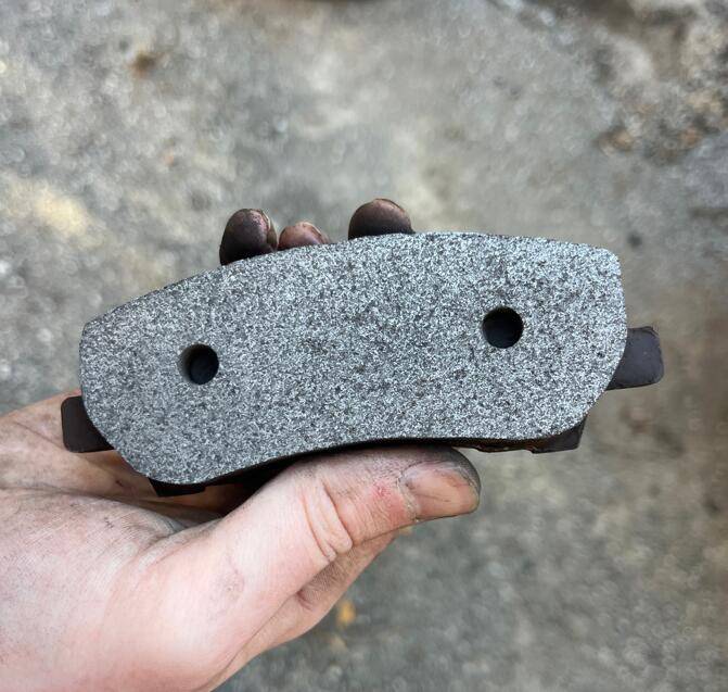

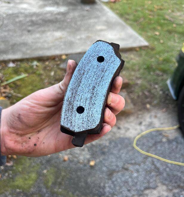

@gone_n_60 and @Bluemustang I found the problem! They were glazed!!
I sanded the pads down starting with 80 grit, then 120 grit, then 240 grit! The glaze is tough stuff, took a while sanding by hand in figure 8 patterns. I've only driven them maybe 10 miles but the squealing is gone and honestly they feel much better under the pedal!
Before and after pic!

If you are glazing them then you are are on them too much. Do you do events with an Instructor? Rotor paint is your friend to determine what temps you are seeing on track. I would just use the most aggressive sand paper and stop there.
