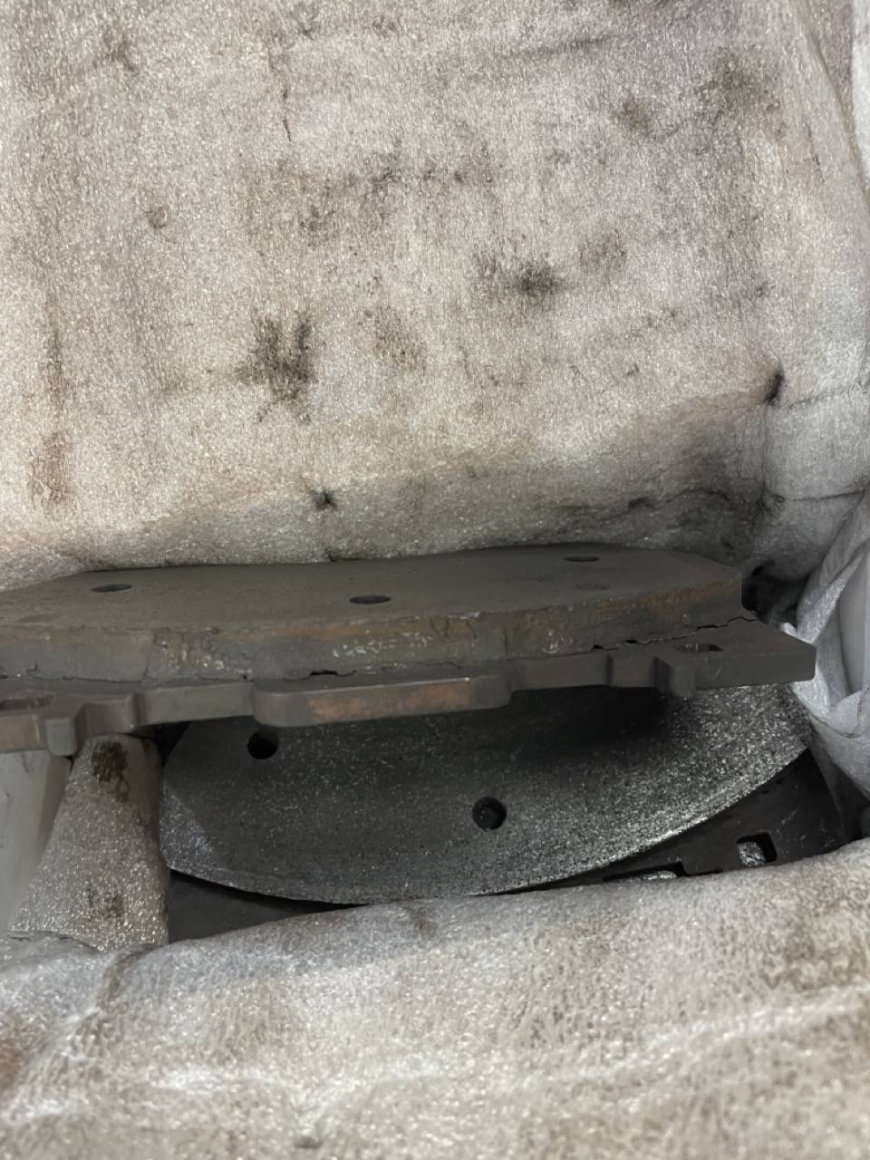

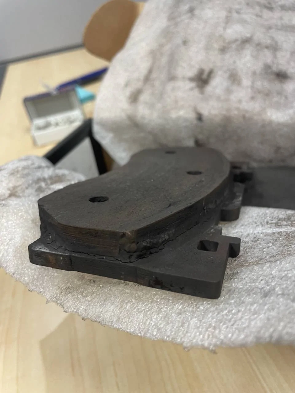

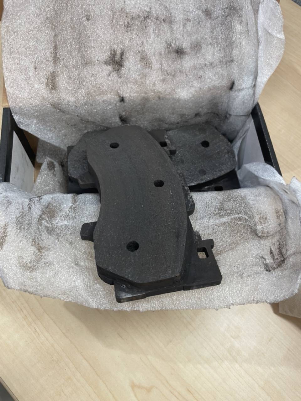

I took these pads to my race shop and the lead tech said he would not put the pads back on the car, but also because one of the backing plates was bent. Only one pad was bent, also odd that it didn't bend in pairs. He said this was rather shocking this happended to the R10s on my 500 tread ware tires. He recommended I step up to the R16 compound. Rather upsetting as I still have tons of life left on the pad face which looks great, no signs of glazing.

I see zero wrong with those pads.

The backing plate of one of them is bent to where it wobbles significantly on a flat surface. This set won't be going back on the car. Maybe there was a quality control issue with the one pad as none of the others were bent in any way.
I agree with the pad compound, nothing is wrong. But the cracking along the edge where it meets the backing plate can be pulled on and made larger. The pictures unfortunately do not do the crack justice. I just have never seen a track pad do that and not come out glazed to hell and back or shredded.
My plan is to email G-loc and see if I can get some sort of discount for an R12 or R16 pad.
