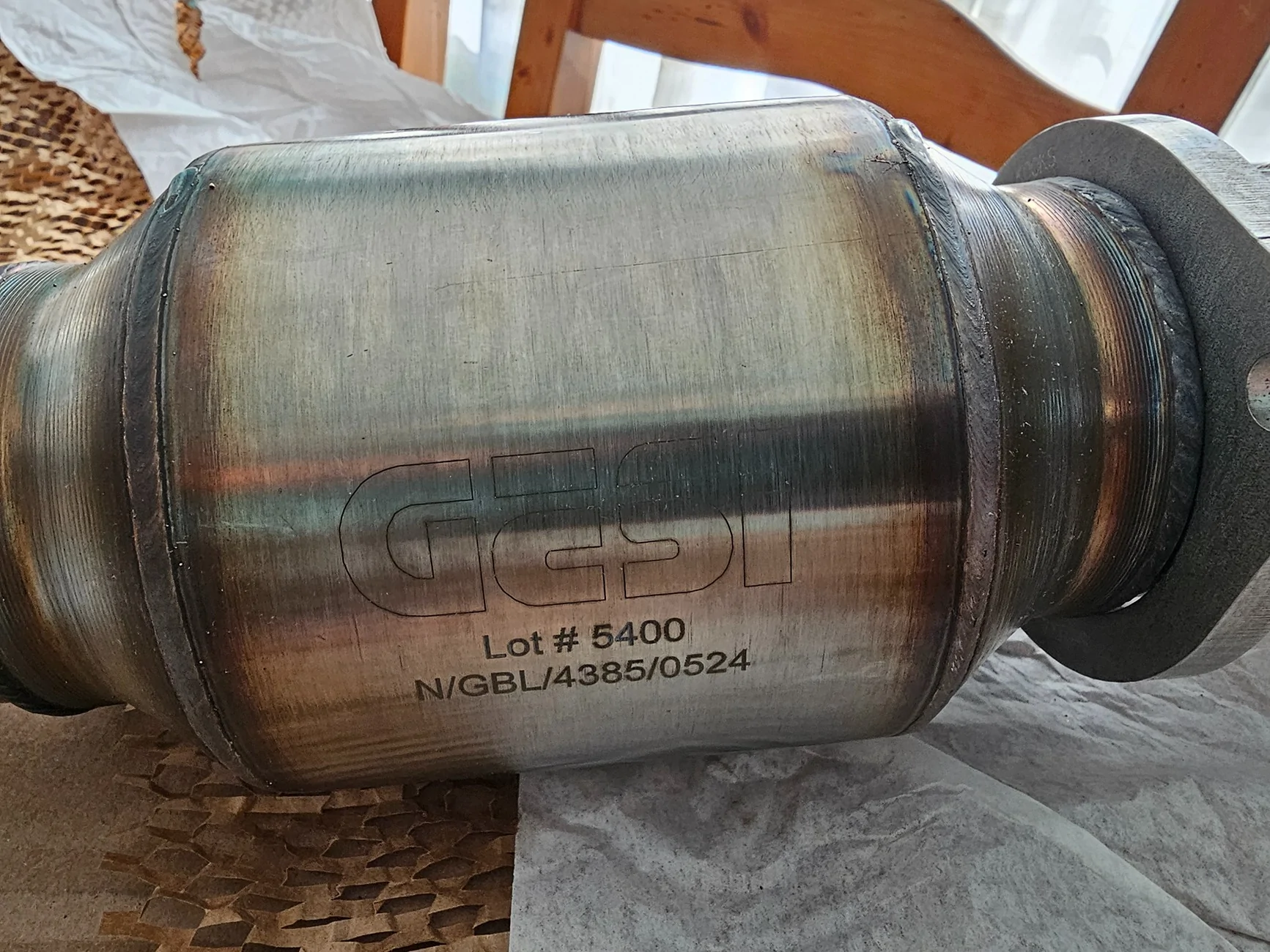

If/when the stock cats fail again, I'd suggest going with the GESI Gen 2 UHP cats. I had my stock cats fail within 2,000 miles and regular Kooks non-green cats fail in 700 miles running the supplied whipple tune.
Been upwards of 7,000 miles now at 800+ hp and these GESI cats have showed no sign of failing or giving off that sulfur cat is going smell.
Kooks sells them rebranded as their HO Green Cats with connection pipes attached making it easier to swap in/out.

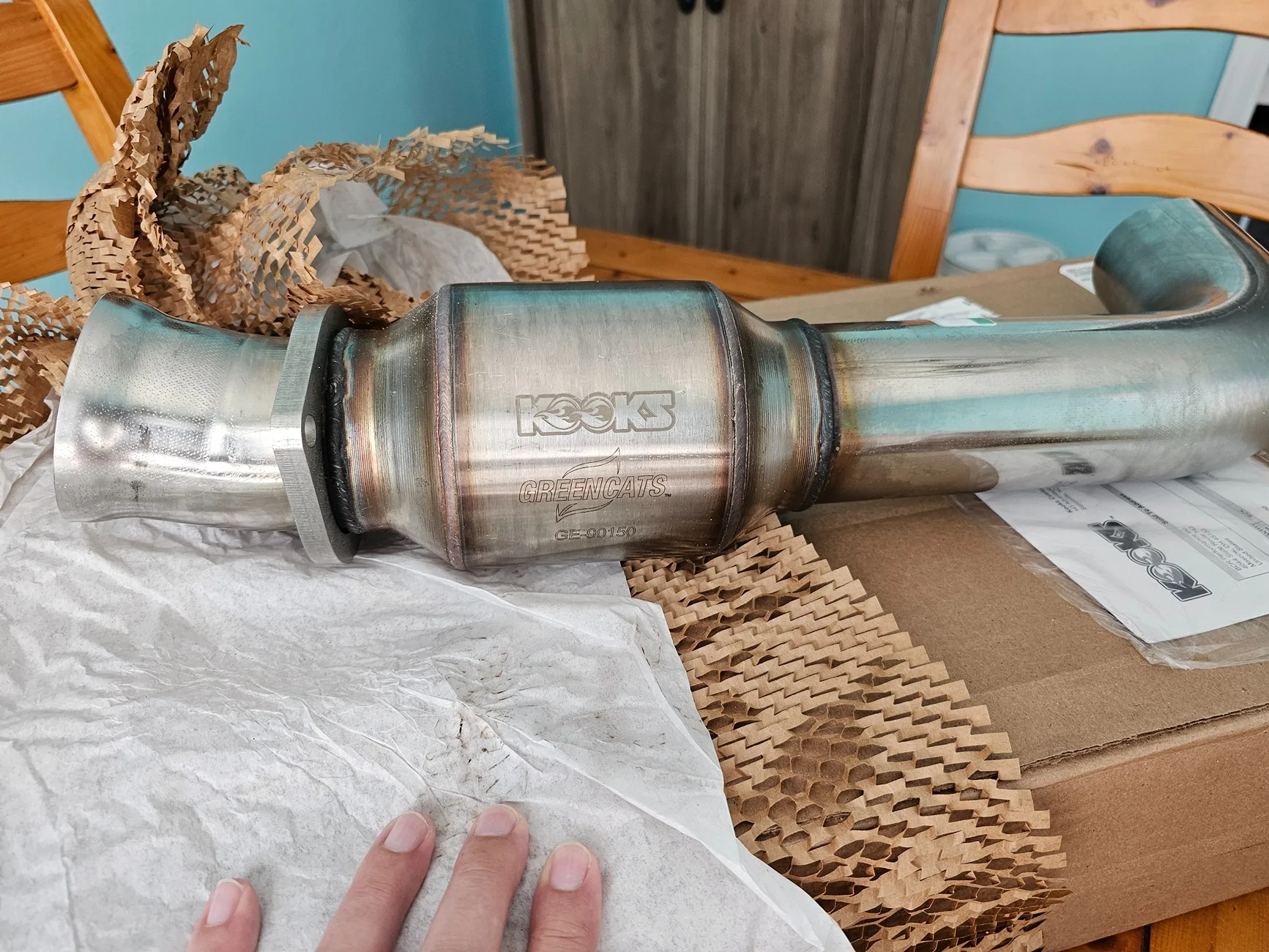

Also are you referring to these? https://kooksheaders.com/products/11513400
I assume you are running the kooks long tube headers too right?

No crackles or pops. I do have the Kooks 1 7/8 headers with the GESI connection pipes.
Have to make sure you get the HO Green and not just Green.
3" Kooks H.O. GREENCATS Catalytic Converter 7" Long Certified to EPA S – Kooks Headers https://share.google/DeNDQ054a6VLQAZxd
