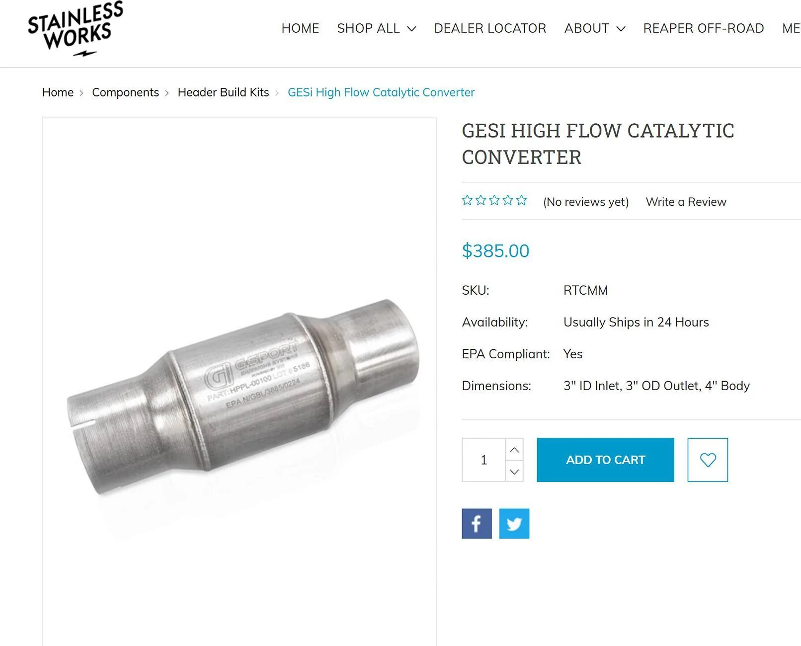

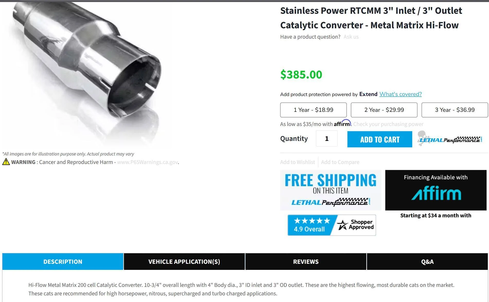

That is odd, even Lethal Performance has that Cat description saying that it is a 200 cell. Stainless works does not have it listed at all
You can send an email to the guy in my email, and give him the part number on the cat you have, and he will tell you for sure what its specs are. Im not seeing anything on Lethal's website about the Cell count on the cats they have. Only that they offer the GESI Sport SWGESI450 as an upgrade for $800
Maybe their base option is a 200 cell, but for sure your car won't pass emissions with those, if that's a concern

I guess I would assume that their description is incorrect. Ether that, or the Gesi rep. was. I can confirm that even on E85, my car will set all of the readiness monitors with these cats.
Also, their description says EPA compliant, and I would highly doubt that a 200 Cell cat would be

See lethal uses the SKU Number for the description. As you can see though the part number in the picture lethal has is the same as the one you are saying. I'm not here to say you are wrong or to prove you are wrong. This is just what turned me to make this post in the first place. I hope what the guy emailed you is 100 percent true and these can take on a whipple with nothing more than proper tuning. It is completely normal for description to be wrong on different websites. I have emailed Gesi and Stainless Works and will confirm what they say. I do not have to worry about emissions or anything but if the cats start to melt I have what I need to replace them.
