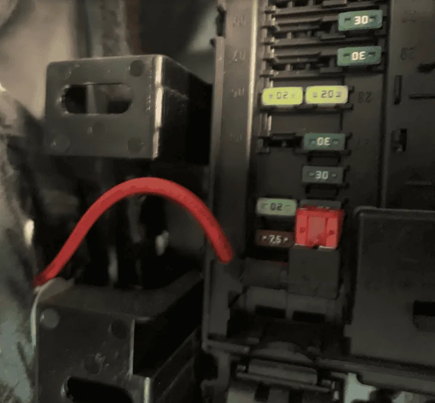

I had my aftermarket amp installed over 3 years ago. The stereo has NEVER given me an issue. In fact, its one of the reasons I really enjoy driving the car. But about a year ago, I noticed that sometimes (every once in a blue moon), my passenger side power window would just DIE. No response from the switch. This would be problematic if I were out and about and got caught with the window down; but usually, if I turned the car off, let it rest for a second, the power window would start working again on the next ignition cycle.
Again, it started happening about a year ago, and it probably happened less than a handful of times. So each time it would fix itself right after, and I wouldn't really go chasing it down.

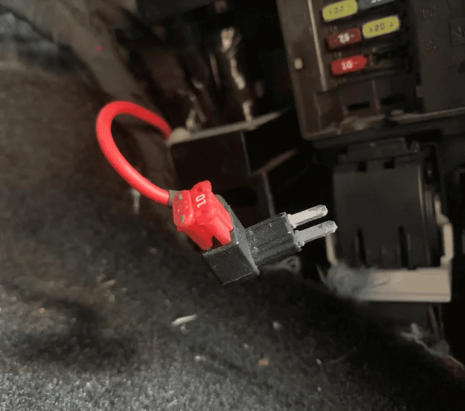

Well it happened again yesterday, but this time the ignition cycle trick didn't work. I dove in, and noticed that my amp remote turn on/off is piggybacked off of fuse 23 (as are MOST aftermarket setups, as its pretty much the fuse that everyone advocates to use). I didn't install it myself, I had a 'pro' do it, so I was never aware of this.
I pulled the piggyback wire off the fuse and simply popped the 10a fuse back into slot 23. The power window didn't work right away, but after one ignition cycle it did.
So it got me thinking about what's happening. It's obviously NOT the fuse. It hasn't popped. There's something on the other side of the fuse, that's causing the window to spazz about sharing a 12v signal with another device. As far as I know there is only the "regulator" and the "motor" that run the power window. The motor should pretty much 'run' if it has juice. However, the regulator does have some 'brains' and may very well be cutting the juice from getting to the motor because it doesn't like it?? Just guesses.
Not sure what the remedy might be. I've thought about the fact that my battery is about 2 1/2 years old now (plus I live in hot, humid Miami) and it might be near replacement time. Weird electrical stuff happens when your battery starts to get weak.
Has anyone out there noticed any problems with the passenger side window after running an aftermarket amp off of fuse 23??
Has anyone out there used any other fuse slot besides 23, successfully?
Any other thoughts are appreciated. Thanks in advance!
