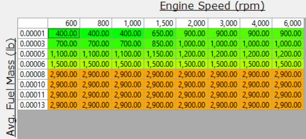

You are correct that the DI pump takes fuel off of the fuel rail then pressurizes it further. It's a positive displacement plunger pump. The flexible hose that supplies fuel to it has a check valve in it, but the pump itself, by nature of it being a plunger pump, has a check valve in the discharge. The pressure is controlled, not regulated by a valve. The suction valve in the plunger pump is connected to fast-acting solenoid that holds it open for part of the discharge stroke to reduce capacity. It's mind-boggling how fast this valve has to actuate in order to control pressure real-time, stroke by stroke. The pressure is set in the tune and usually under 1000 psi at idle and 2900 psi at WOT. There is a phenomenon where the pressure creeps up when the DI injectors are off due to imperfect suction valve control and thermal expansion. There is something called pressure maintenance where the DI injectors will activate just to relieve this pressure. It reduces PFI flow at the time so lambda stays constant. Some get concerned when they see 3500 psi at idle but it is normal. There is way more to this subject than I described here.

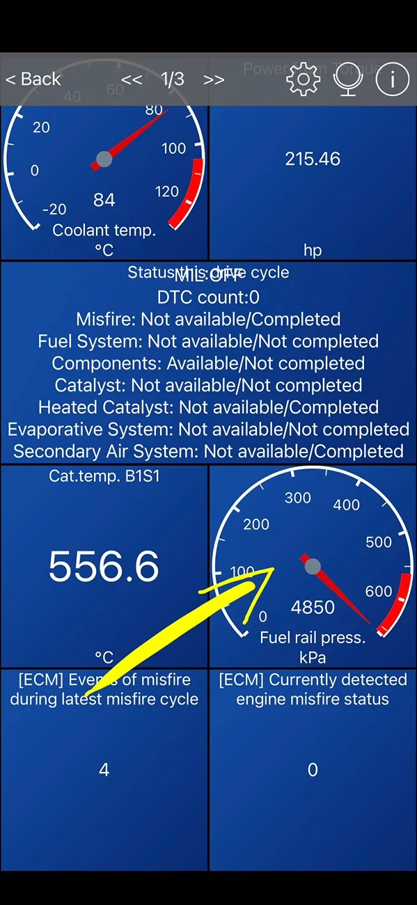

part of the reason I ask is because I’m having a problem with misfires and noticed in my data logs that my fuel pressure is around 400 at idle and builds pressure,(not much over 1000) but then that pressure drops back to 400 once the revs come down. (I also didn’t rev it very high as it was still misfiring) I was hoping it might answer my questions of where to start.

Below is a stock GDI pressure table. You can see it's a function of injected fuel mass. Once it gets under heavy load it will go up to 2900. Unless the GDI injectors turn off, the pressure will fall as soon as the fuel mass falls. It's unlikely that GDI pressure is causing your misfires.

I understand it’s unlikely but I’ve gone through every other likely option it feels like. Plus I just checked it today and my high end fuel pressure drops to 0 within a few seconds after I shut the car off.

I did do a compression test, but not leak down, also checked the IMRC, no broken flaps or controlling rod, no evidence of wiring being damaged anywhere, there were a handful of times where I did get a P0300 but it doesn’t come back everytime and my tuner said my VVT for both intake and exhaust overlapped how they should. The only odd thing I’ve noticed was fuel pressure on my data logs going down and not holding pressure even at running temps and idle. It keeps pressure around 400 and rises with revs but immediately drops back down and at idle bounces constantly down and up in psi.

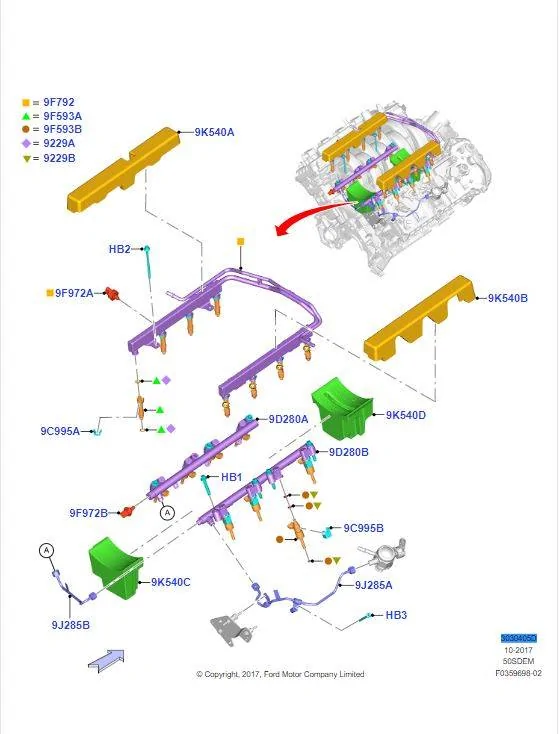

Also side note, the hard line that runs between GDI injector rails-does anyone have torque specs for that line, I had to loosen it to pull out the injectors. 9J285B in pic
