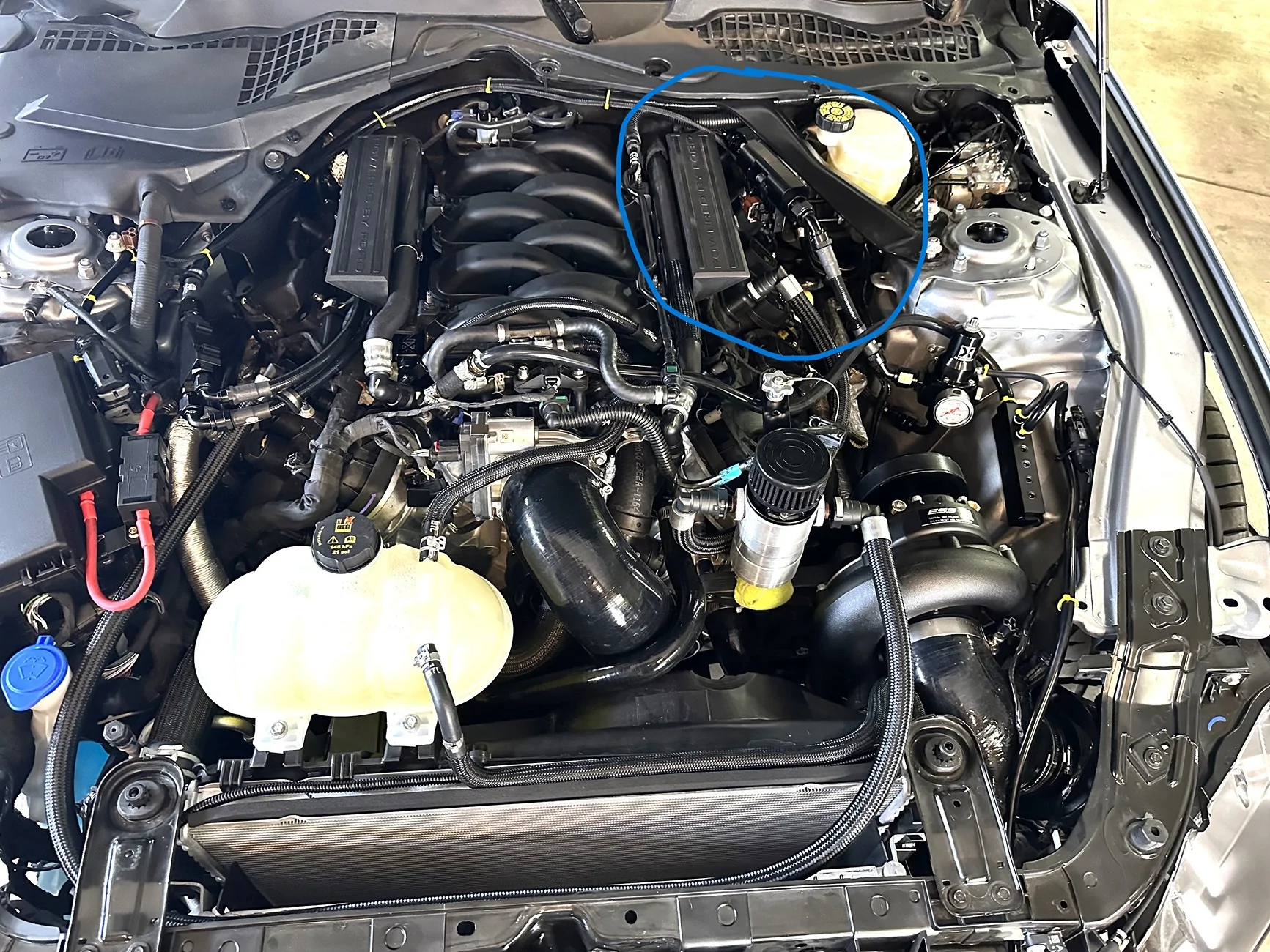

The only part of the Fuel-It kit I still use is the GM Flex Fuel Sensor and the bluetooth dongle. I have since adapted the setup to work on my return fuel system, with AN lines and the Aeromotive Sensor adapter.
However, the original Fuel-It kit worked just fine. I was initially concerned with the fairly aggressive bend in the fuel line coming off of the OEM hardline on the firewall, but it worked.

By using an adapter that allows for larger lines. This has a bypass in it that allows additional fuel to flow around the sensor so that the sensor itself is not a restriction
https://aeromotiveinc.com/products/...gwlbi_eNyDrJ5IrFbGZb7oAhH6mgYxHzd7ukdujtYGCda
I have this installed between the drivers side rail, and the Pressure regulator. It could also be installed on your feed side, as it allows for -8 or -10 fittings.
I took this picture prior to installing my strut brace, but it fits with no interference.
