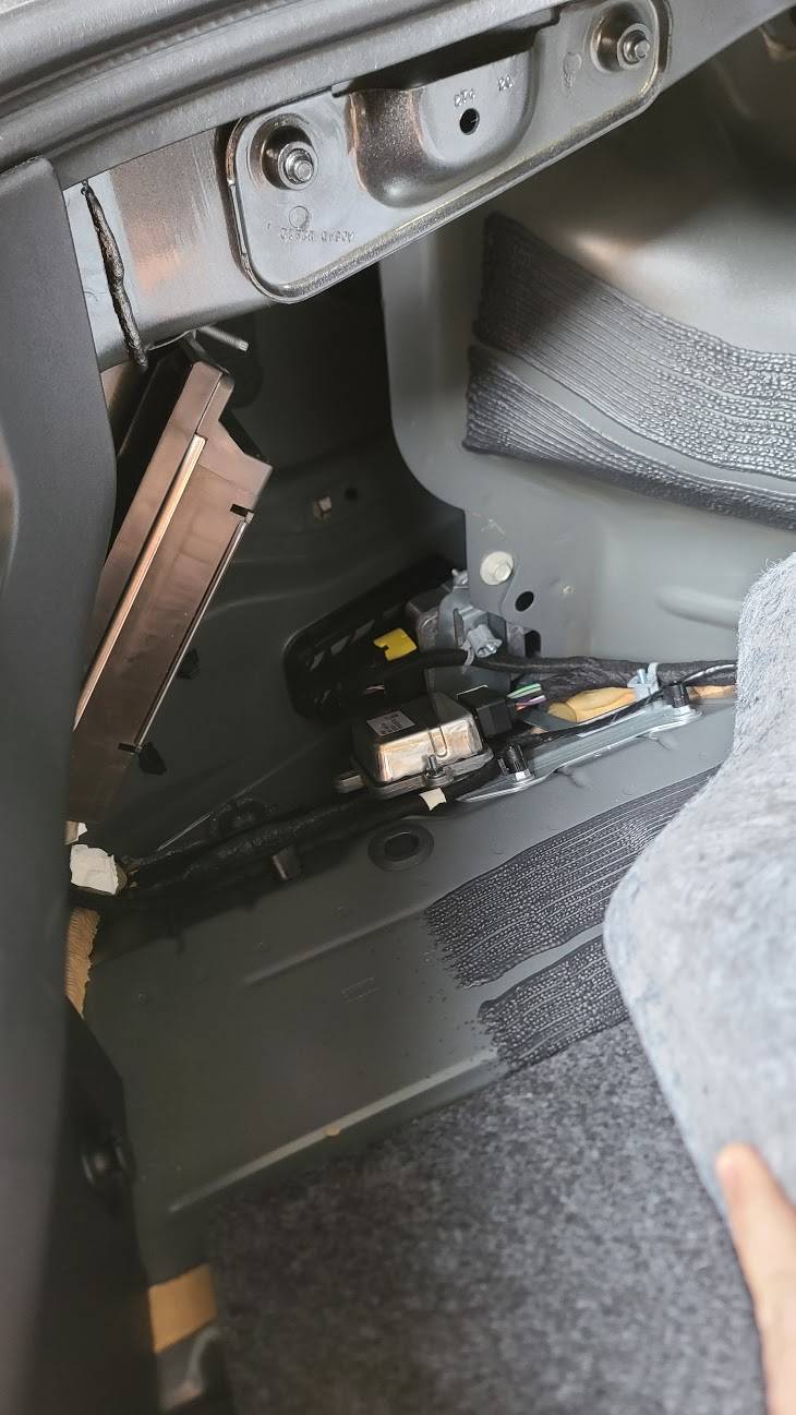

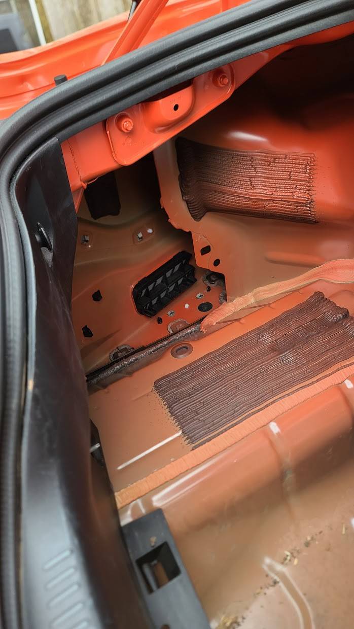

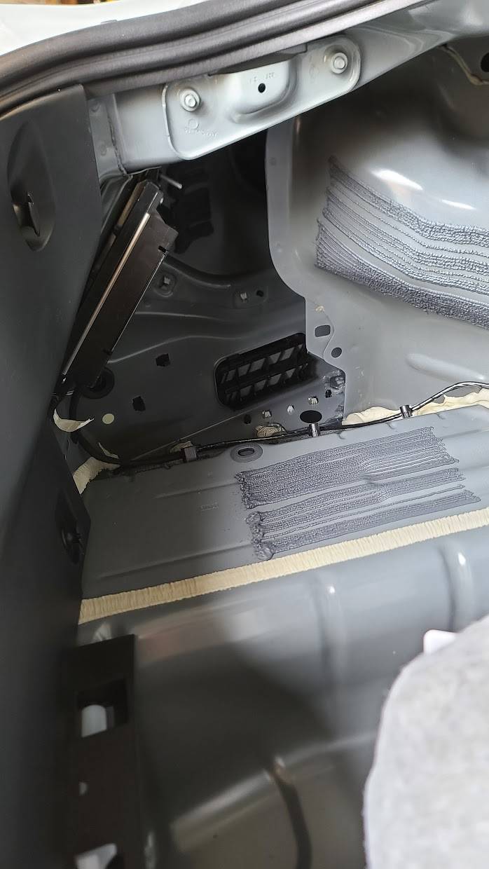

It does not appear that the base Mach 1 has dual fuel pumps. I pulled back the carpet to look for the dual fuel modules that are present in the GT500 and there is nothing there, exactly like the 2016 GT. I suppose its possible they could have been moved, but I doubt it. Let me know if there is any other obvious place to confirm besides pulling up the back seats...I don't have the energy for that for a while.
Here are some compare photos:
GT500 Fuel Modules:

Same area of car in base Mach 1:
Same area of car in 2016 GT:
