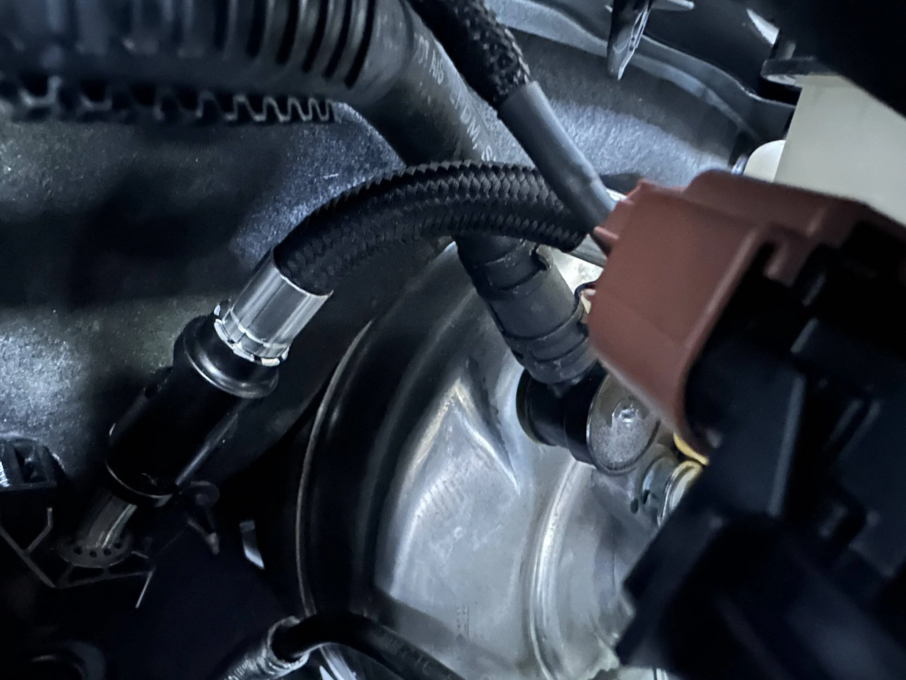

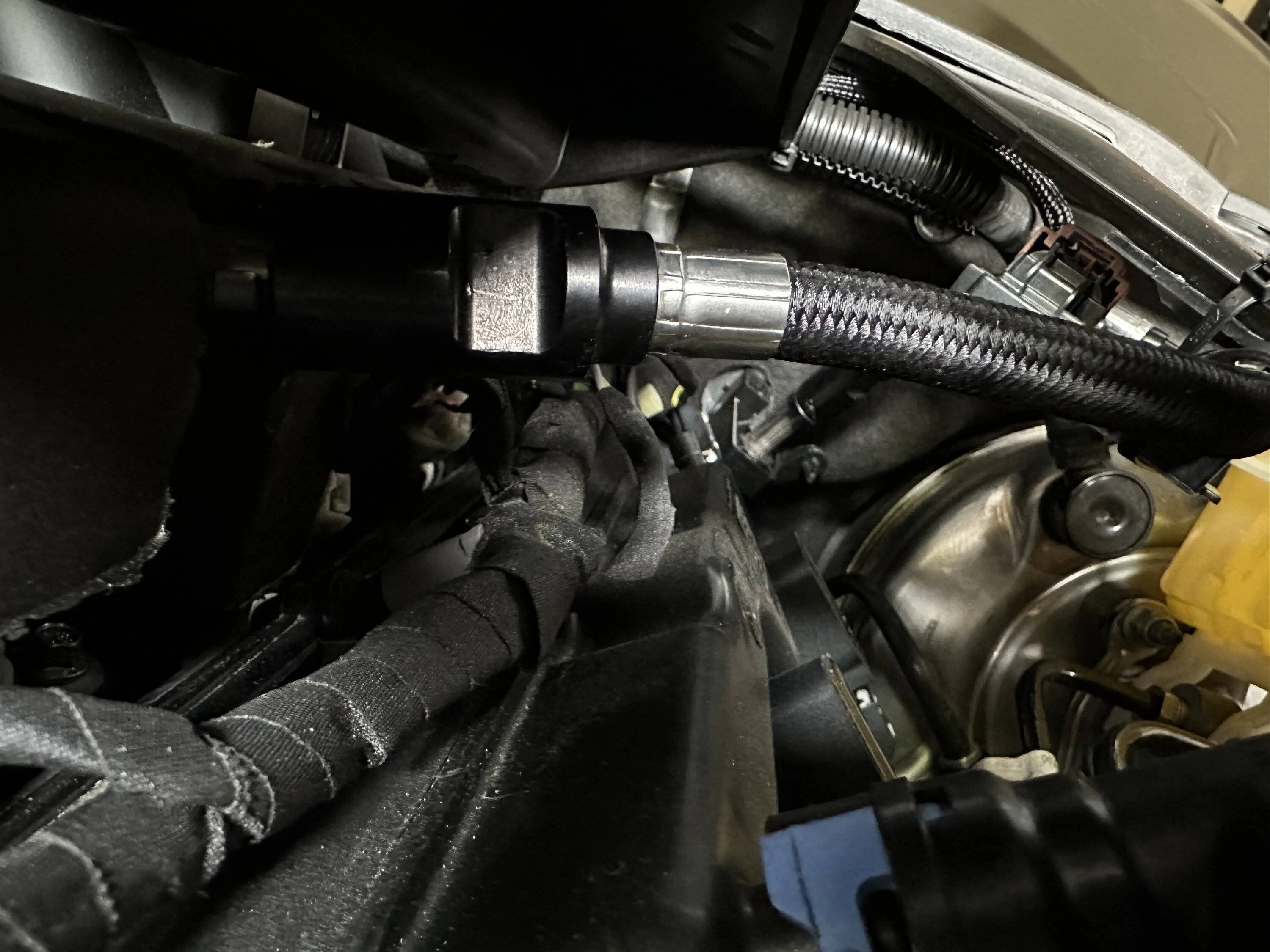

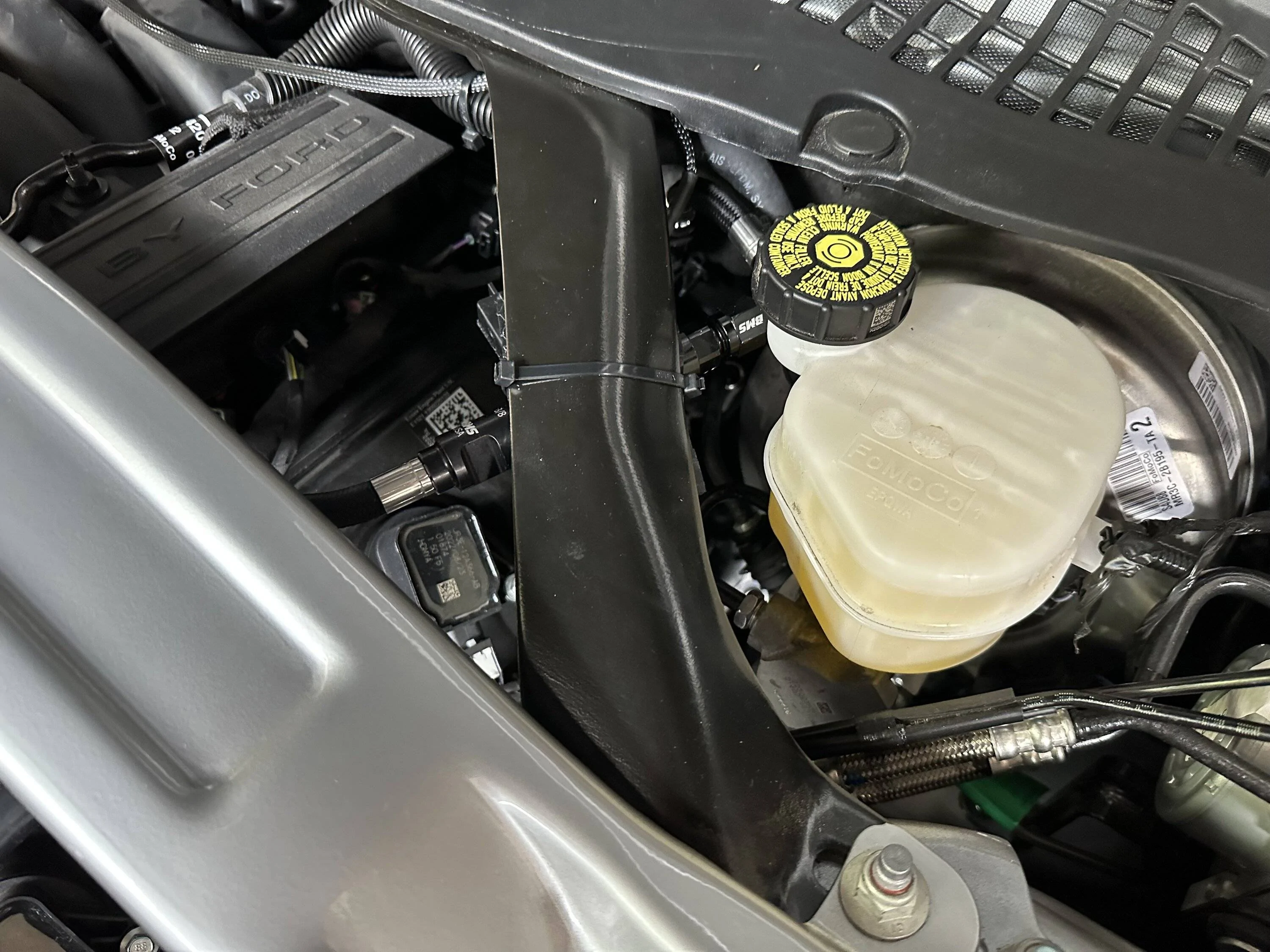

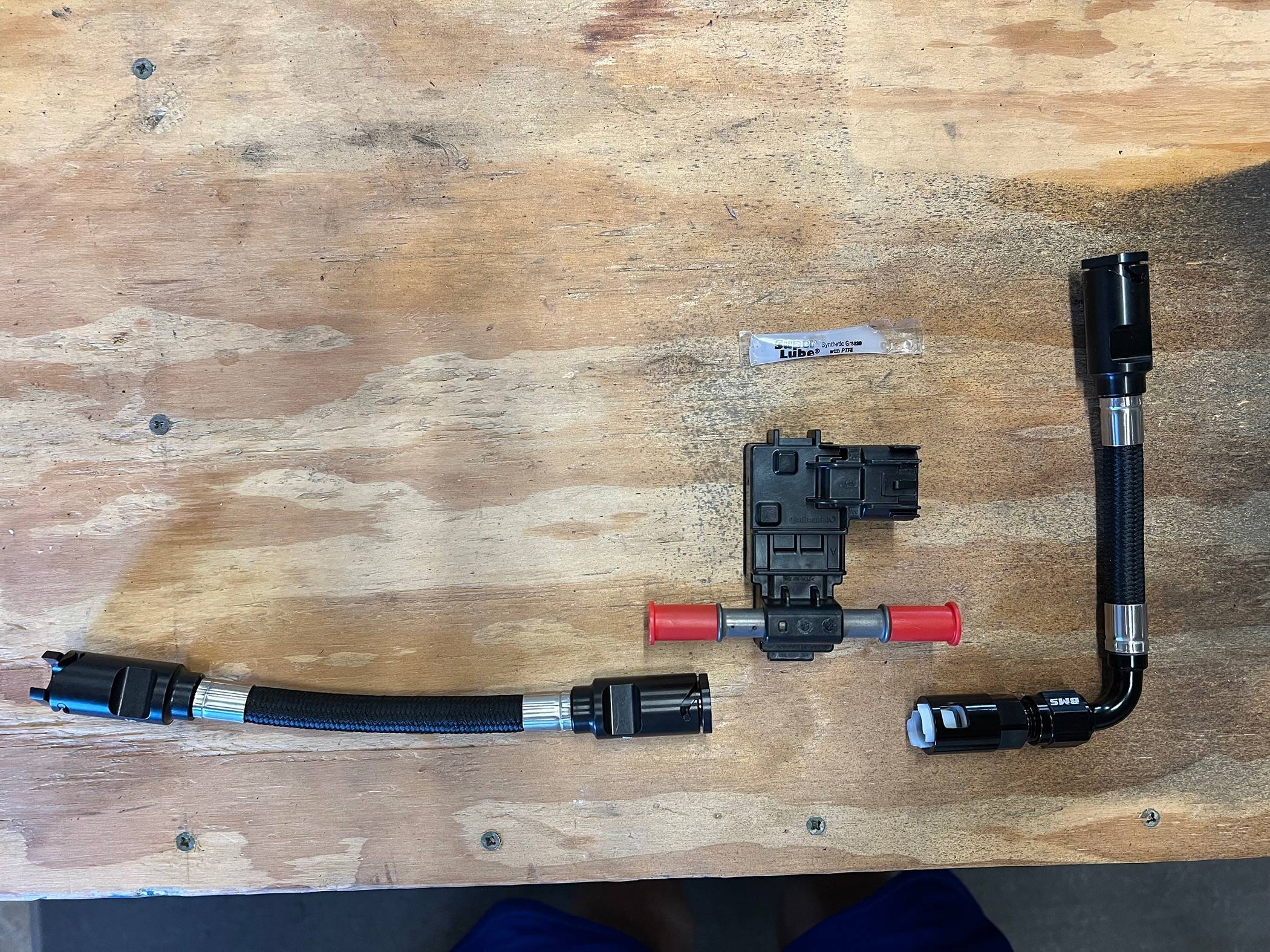

Just wondering who else has done this, and if you had any issues with the hose routing? It appears that this kit was designed to be installed on cars that do not have the firewall bracing. The path of the fuel lines forces the sensor directly underneath the brace, and makes it impossible for the lines to be in a neutral, or un-stressed position. The line that comes off of the OEM hard line against the firewall has to make a 90 degree bend to meet the sensor, which I think over time and heat cycles in the engine bay may cause the inner liner of the fuel line to fail. I have sent a request to the company but have yet to hear back.

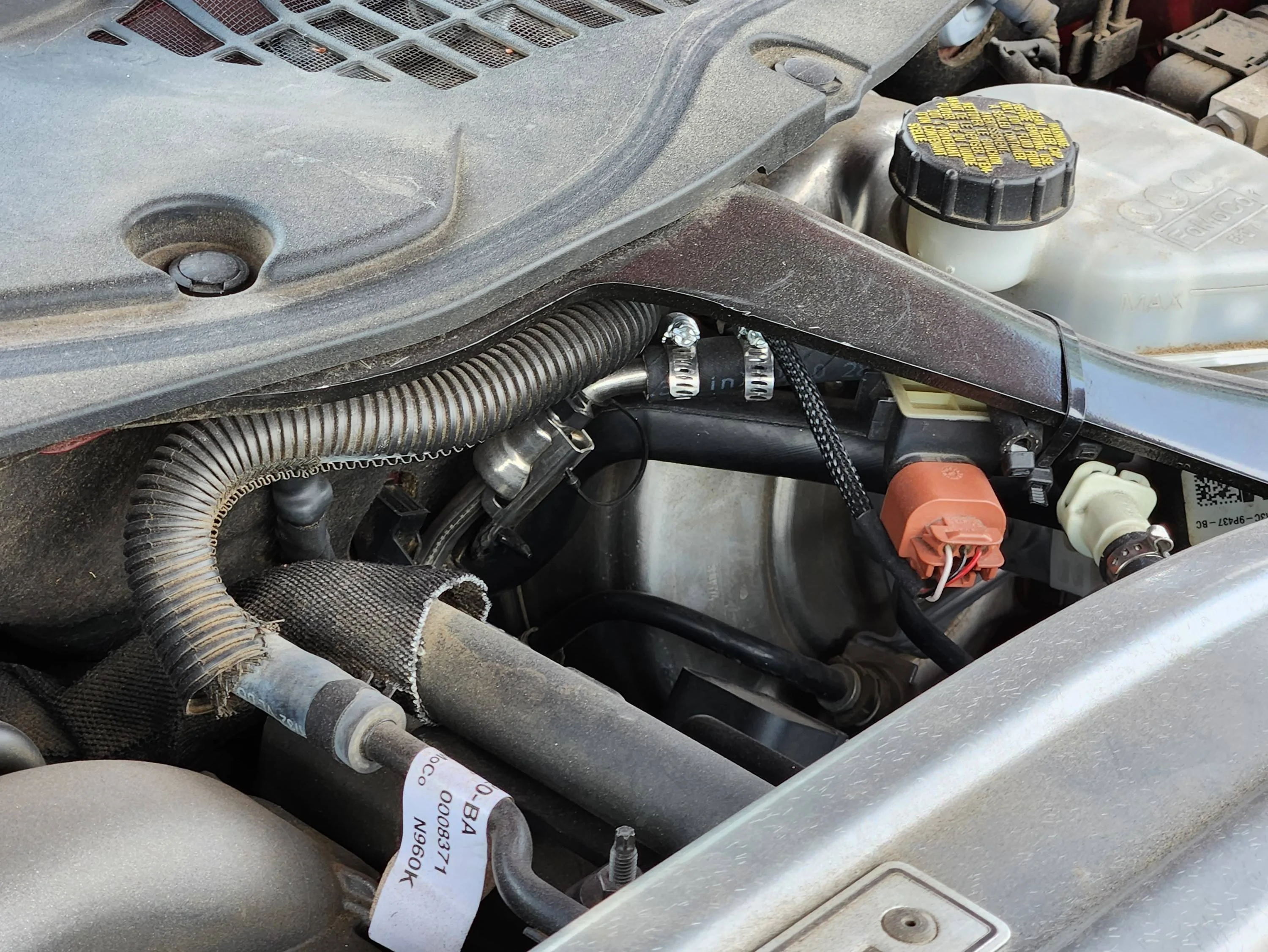

I installed this kit on my 2018 GT a while back, and I had the same concerns. I ended up securing the ethanol sensor to the bottom of that corner brace with zip ties and some rubber cushioning between them. It has held very well for a year now. One of the crimp on clamps did fail a couple of months ago, it was the one I had to install myself (per the instructions), so that's on me. I would recommend tossing out the supplied clamps and use better clamps during installation.
I'll snap some under hood pics soon and post them up.

Gotcha. Yeah I opted not to go with the billet fittings for mine, and it looks like it may have been to my advantage. It appears the billet fittings are longer and force a tighter bend.
When I ordered mine, they hadn't made a 2018+ kit yet. Mine is the original 15-17 kit, so I don't know how much of a difference there is in yours.

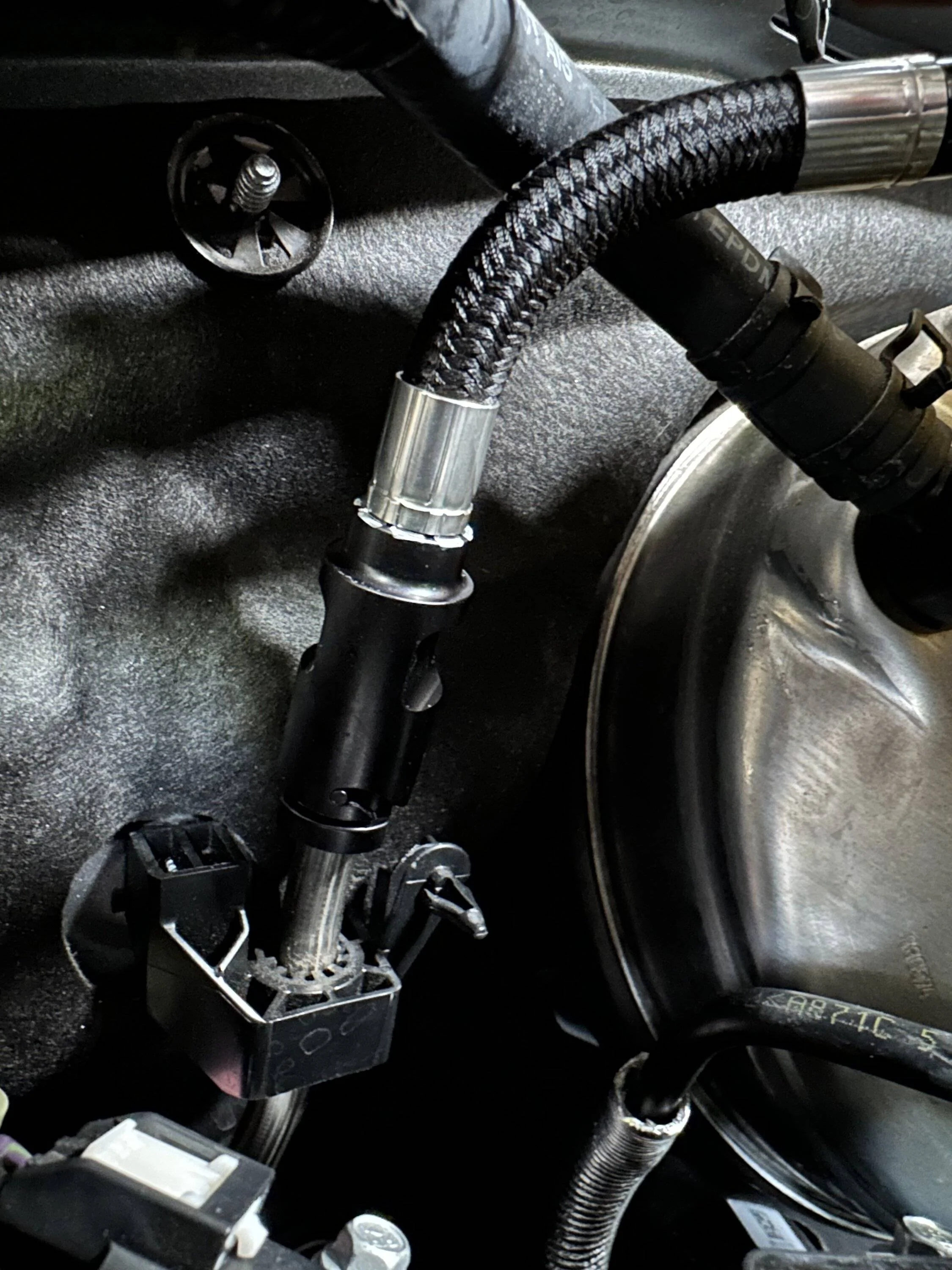

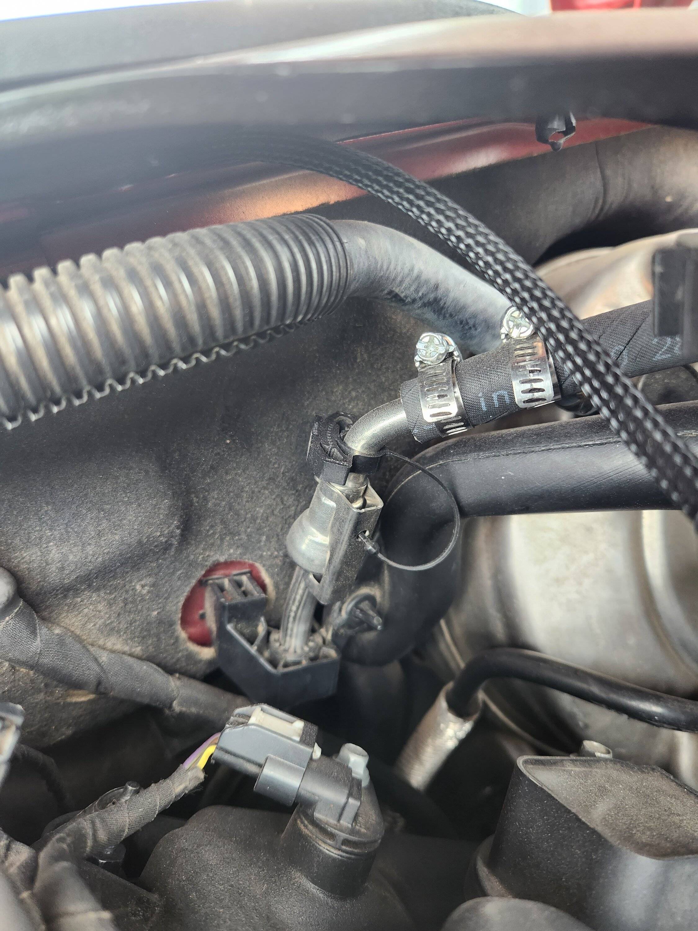

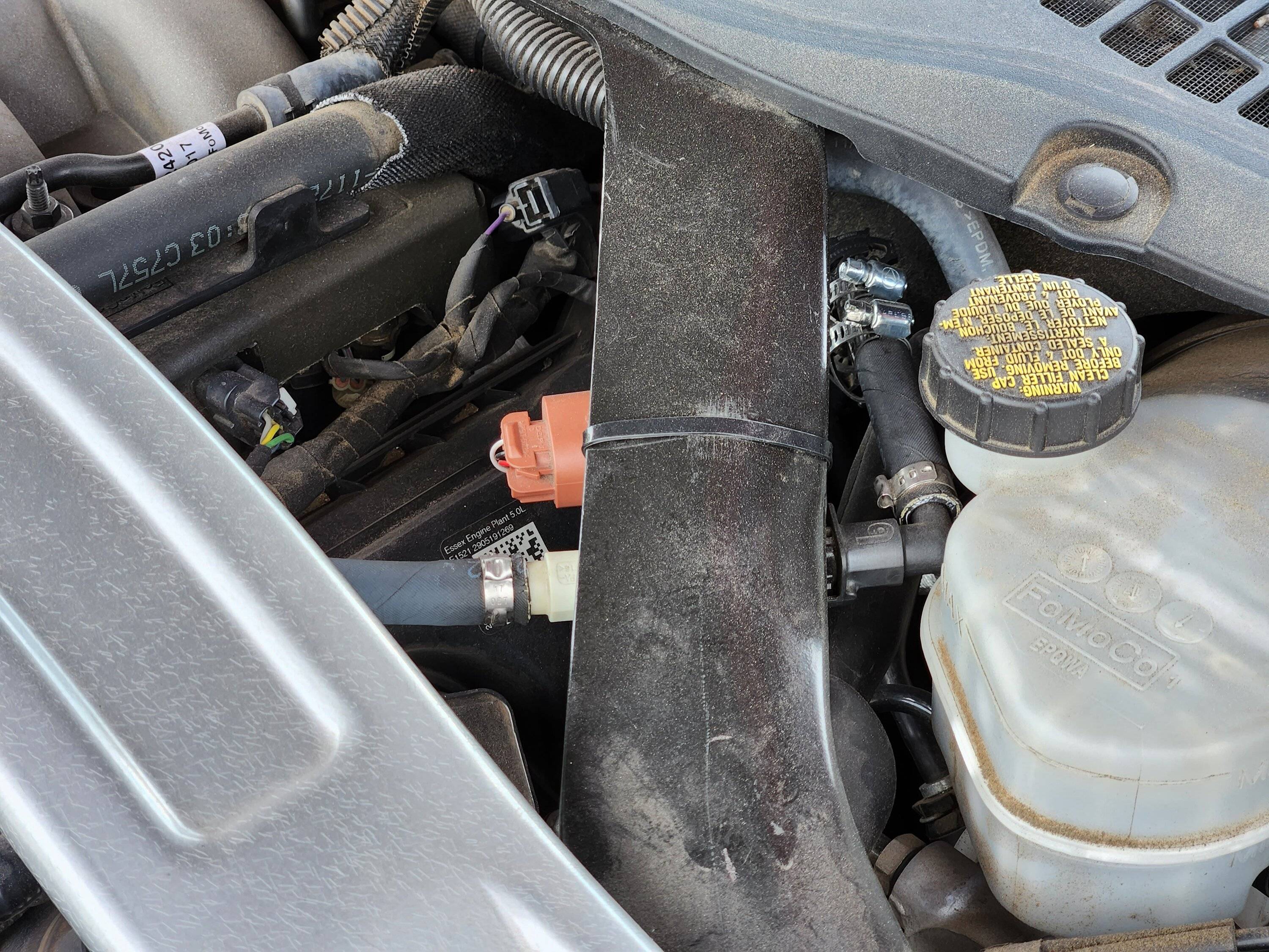

I see the difference now! My kit reused the OEM bent barb fitting that connects to the firewall, so I have no bend in the hose. Pics below.

Thanks for the pics, yeah your right, the billet fittings do seem to add too much length, but I think even with the plastic ones, it would force this bend since it isn't using the crimped section onto the old hose

Yeah, Fuel-it said they too don't think it is an issue, but that the kit wasn't designed to be used on a MACH1. I told them the same problem would present itself for any car with the Performance package. They again said that the would not make any changes to their kit, or make a new line for me. I can certainly make new lines with the correct fittings, it just chaps my ass that they didn't address this issue. This place has all the necessary connectors and adapters to do it correctly.

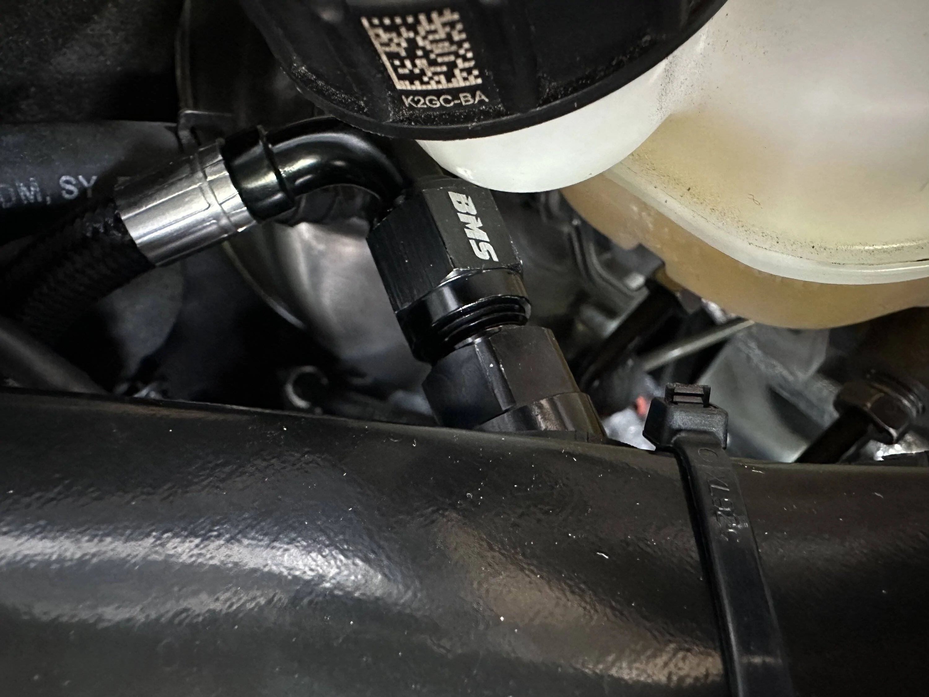

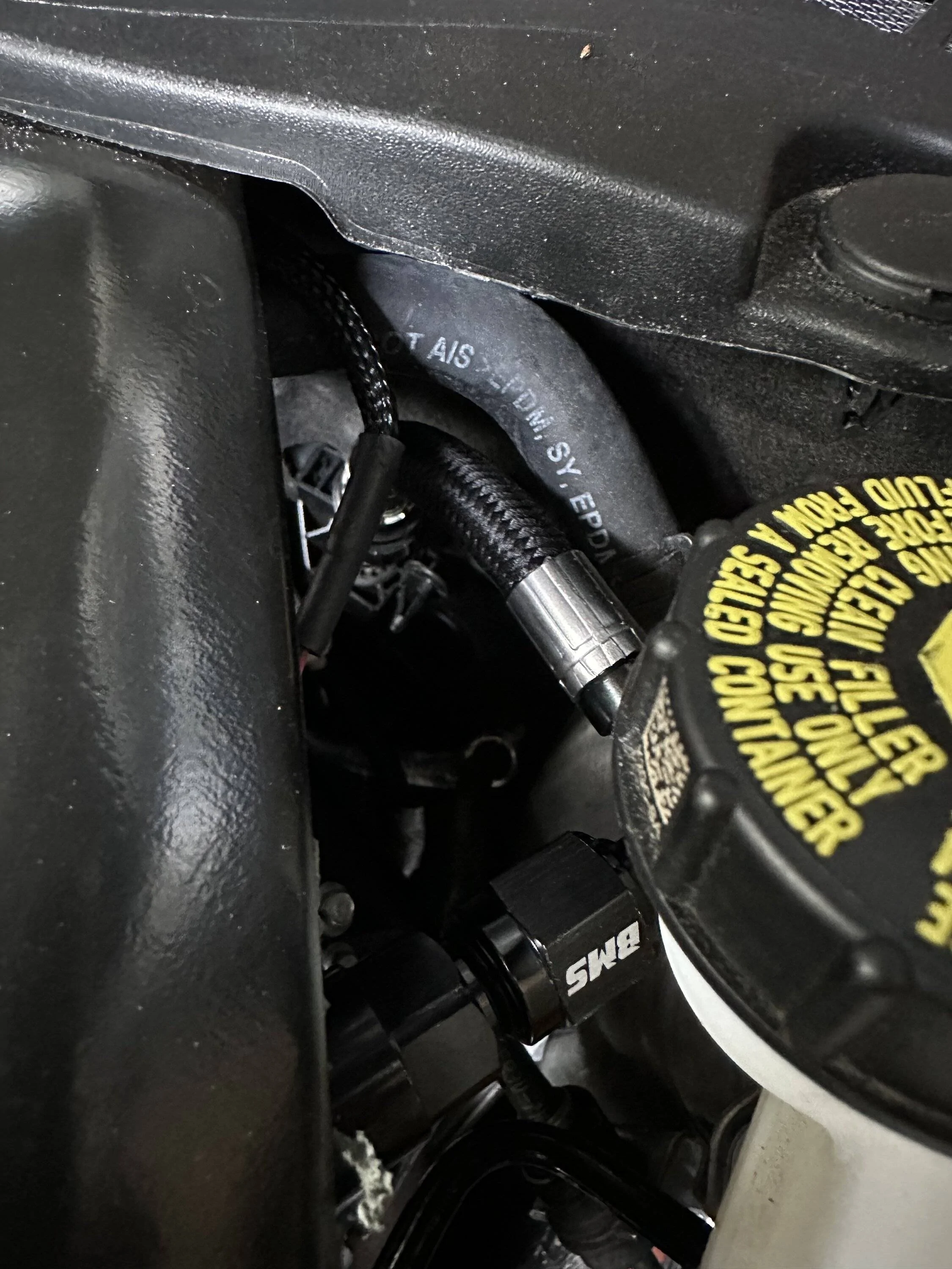

The only part of the Fuel-It kit I still use is the GM Flex Fuel Sensor and the bluetooth dongle. I have since adapted the setup to work on my return fuel system, with AN lines and the Aeromotive Sensor adapter.
However, the original Fuel-It kit worked just fine. I was initially concerned with the fairly aggressive bend in the fuel line coming off of the OEM hardline on the firewall, but it worked.
