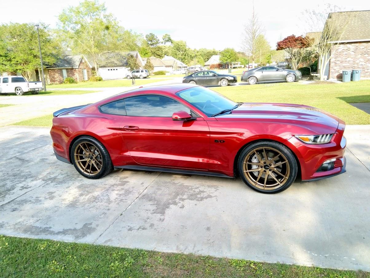

I don't know if this will help you or not, but I'm running 20x10's on the front with a 35 offset. My front tires are 285/35's and I'm lowered on an Eibach pro-kit which is I think about an inch drop in the front. Performance Package car. They are VERY close to the front fender well when I turn, but I have no rub marks anywhere. No spacers.
This is exactly what I run and had the same results. Fits, no rubbing. I will add that I installed steeda roll center correction arms (lateral links) and lost approx 5mm of track width like others have. After that, I installed 5mm spacers and everything is all good again. So ended up with a 30 offset after all said and done. I could probably squeak out another 2mm or so and not rub.
So you are saying the correction arms pushed the wheels in another 5mm?
I was thinking about getting those when I lower it, but I don't want the wheels pushed in any farther.
