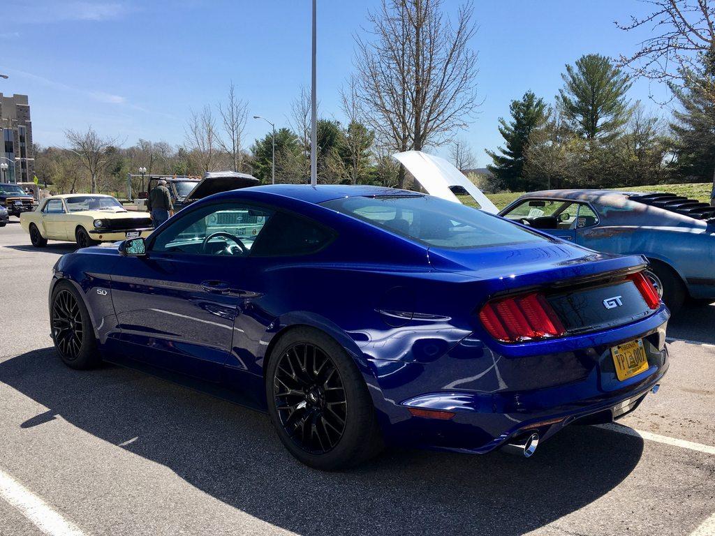

ā€˜15 GT
I guess I’m just going to stick with my 265, I don’t want to run a staggered setup. Womp womp
You can run 295’s on 10ā€ wheels. It may not be the ā€œidealā€ size for a 10ā€ wheel but it’ll fit fine. How well it fits also depends on the manufacturer and model of the tire. I’m running 10.5’s up front and there is some poke but I adore the way it looks. Those wheels with the same offset don’t fit so well out back. Too much poke there, and I’m at almost -2* camber on the rear
