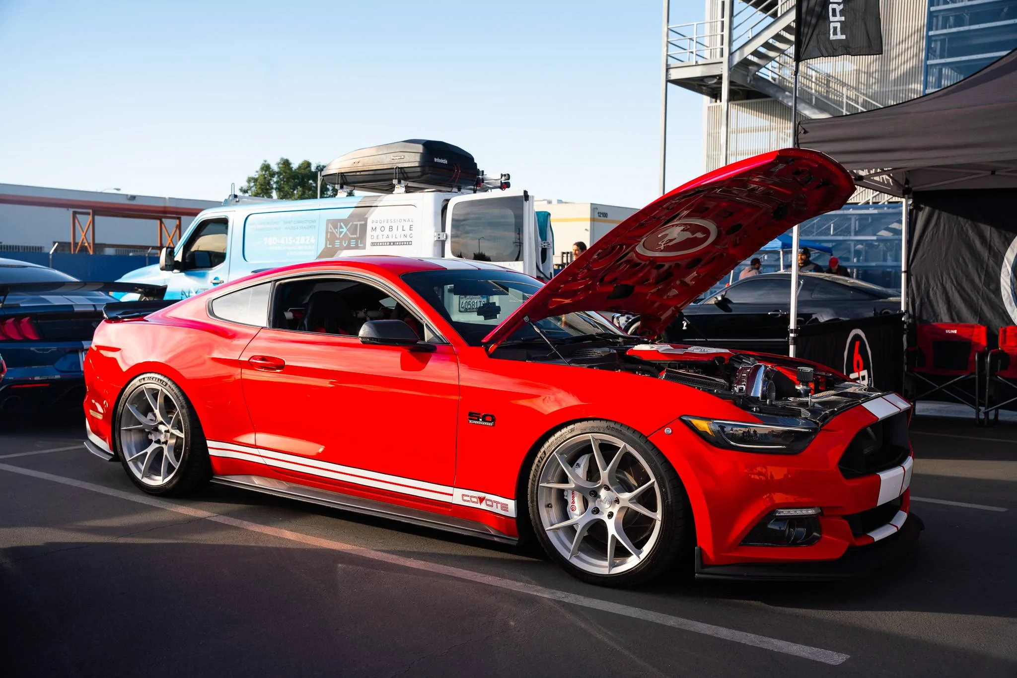

Hey this is Junior from Project 6GR, from what it sounds like is the offset on your wheels must be wrong for the front. What are the exact specs for your wheels up front? Here at 6GR we use a 20x10 +35 285/35 for the front and we have no rubbing or clearance issues on these mustangs. Here is my personal car for example lowered on BC Racing coilovers lowered about 2 inch's with the our 20x10 +35 285/30/20. I have plenty of wheel to strut clearance and no rubbing on the inner fender. Feel free to give us a call if you have any fitment questions.

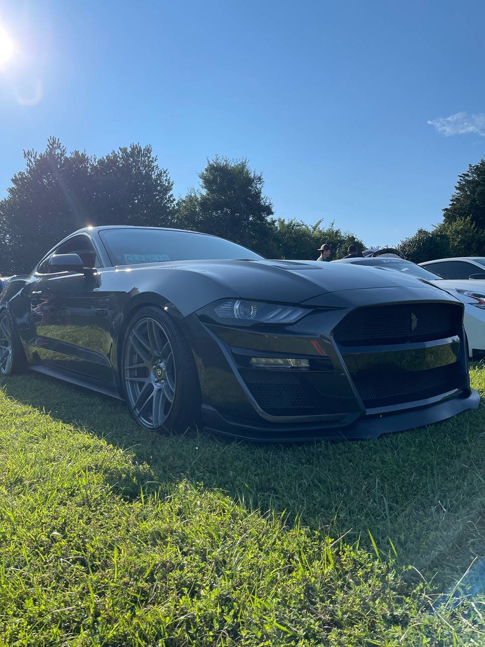

Looking for an update to see if you resolved this since it seems like I’m encountering the same issue. For a few months I have been running the Pedders SportsRyder Strut/Shock system and previously had a 275 front and 285 rear tire setup on 20x9.5 +30 offset with no issues. I just replaced the front tires to run a square 285 setup earlier this week and yesterday noticed some rubbing when I would go over an overpass or bridges on the highway. Very notable audibly. I don’t feel or hear any rubbing at any other time but when the shocks compress due to the road bump.
