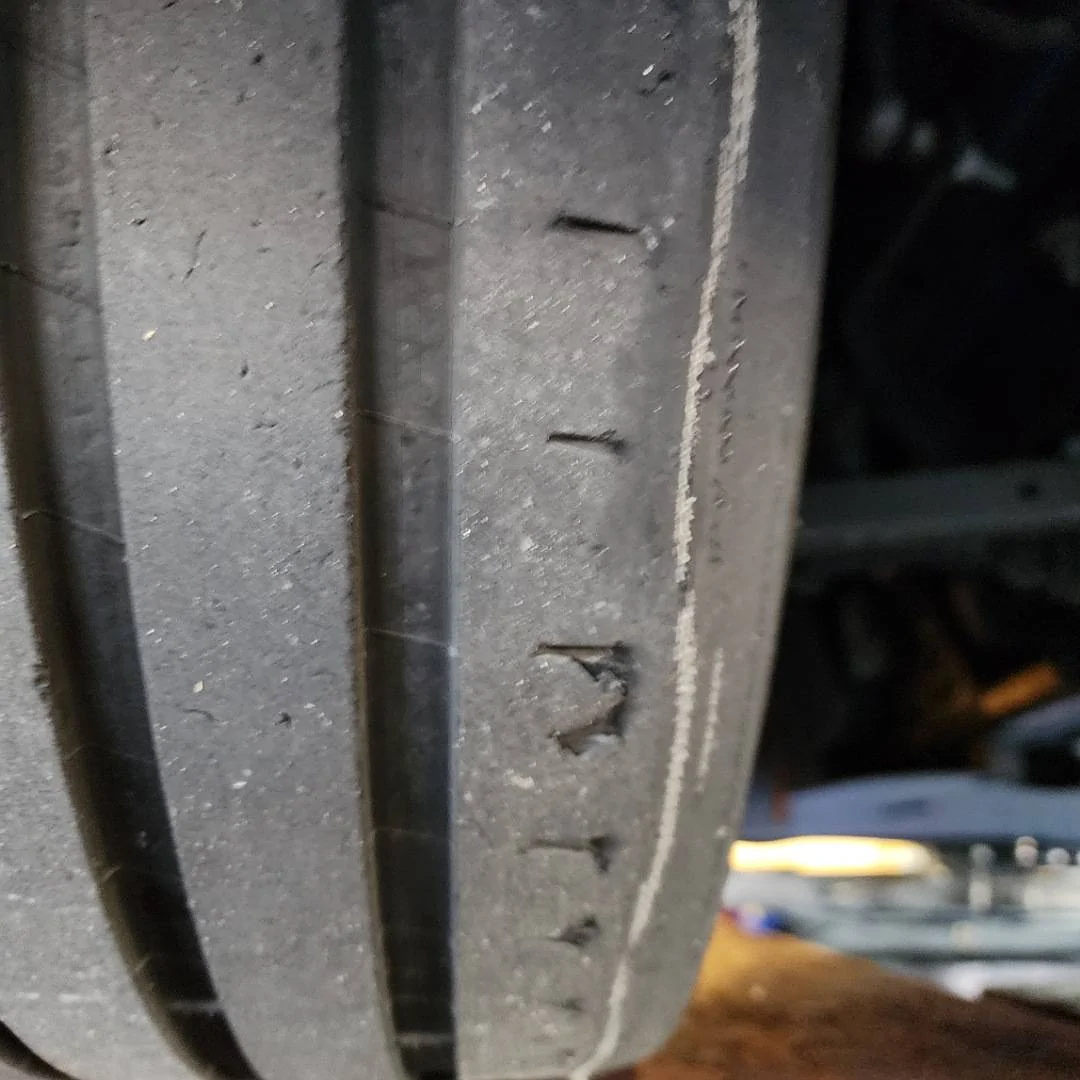

This is an amazing thread, and there's a lot of great information here! I found this because, after my oil change yesterday (with tire rotation), the shop noticed inner tire wear in the front tires. (See picture.)
Not what I'd consider normal! She's a 2019 GT Premium PP1 on staggered Michelin Pilot Sport 4S. I've not replaced/upgraded any suspension parts just yet, so this is an interesting thing to have seen. It's on both front tires, inner corner/walls. She's 17,513 miles into her life (bout with 0 miles on odometer) and she's a "daily" driver (read: driven maybe once a week regularly.)
Are they both doing that? Check camber/toe.. you either have one side with too much negative camber or you have too much toe out, that would wear both tires though.
100% this is an issue of toe, not camber.
