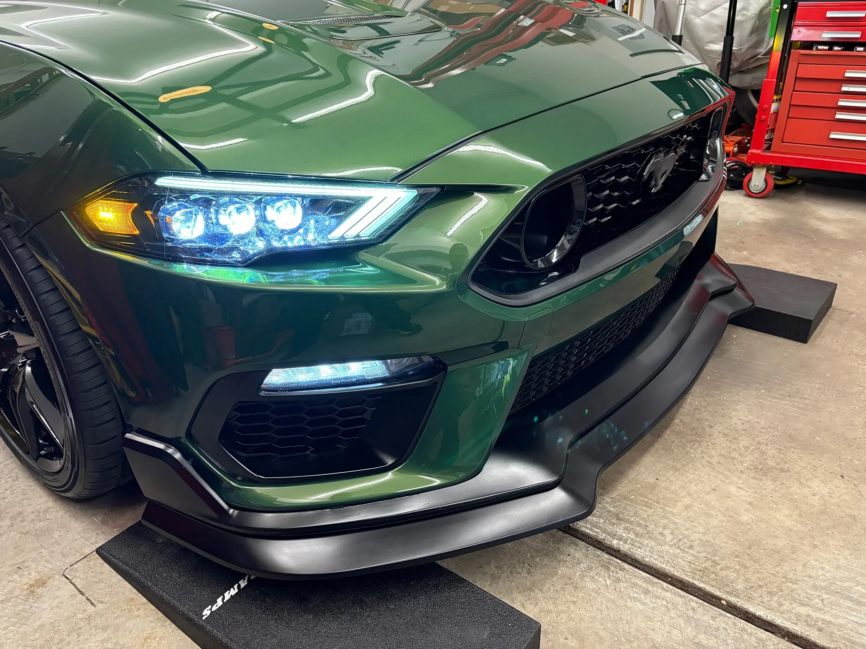

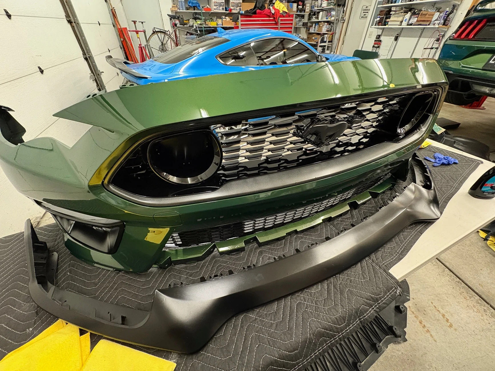

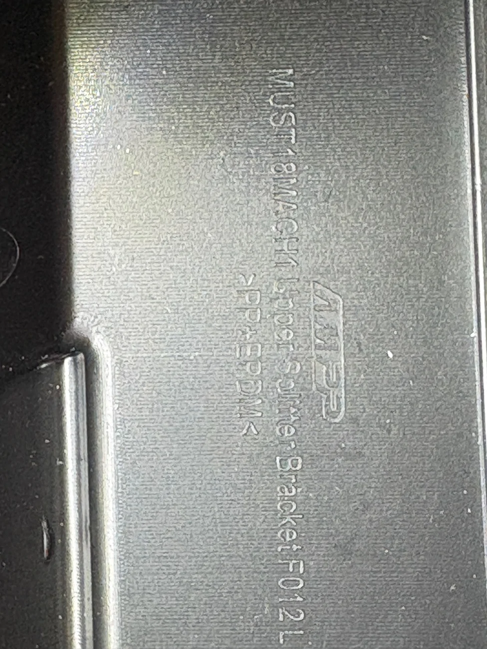

Bite the bullet and get the OEM. I installed a 777 conversion kit (all aftermarket pieces are molded by the same Chinese source, last image) on my son's 2022 GT and the lower splitter is a single layer of flimsy polypropylene that will chip or split on the slightest bump. We had to swap out his PP1 fender liners and undertray to a base Mustang to line up with the upper splitter but the lower splitter nests into the upper splitter same as a real Mach 1. Try ordering the real deal from a local dealer if they offer an on-line discount service and get approximately 30% off and free pick-up. My local dealer makes it tricky to find because you can't access it from their main web-site but another dealer might advertise a discounted price and you can go to that web-page and change the dealer to a local dealer and the price will be the same or similar. FordParts.com used to offer great discounts and free shipping or pick-up through any dealer but those days are long gone.

Update: My local dealer, Varsity Lincoln, has on-line 34% discount pricing (Valance Panel Ford MR3Z-17626-AA) so current pricing is $529.50. Mine (original Mach 1 ) has taken some hard hits and survived but my son's 777 conversion piece cracked on a minor driveway scrape.

Is the Steeda splitter a single "layer" lip and are there images of the underside and how it nests into the upper splitter? I've had good results with RTR's accessories and their plastic is significantly more durable than the polypropylene material used on my son's 777 conversion kit.
