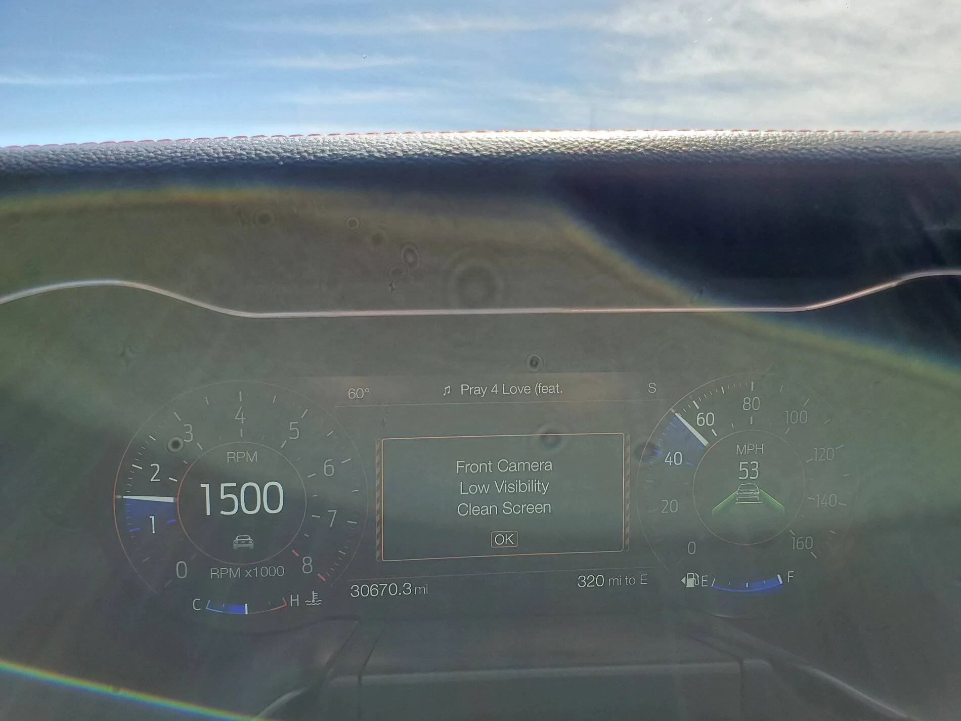

Does anyone else with the Safe and Smart Package get the "Front Camera Low Visibility Clean Screen" message popping up frequently? For me it pops up almost every time I get on the highway and occasionally while driving. It also looks like there's a haze in the camera housing (has anyone cleaned it out?).
I was at my local dealership since my radar was acting up and my service advisor said that if they removed the camera housing and didn't find anything abnormal that I would be responsible for the man-hours required to remove, reinstall, and reprogram the camera.

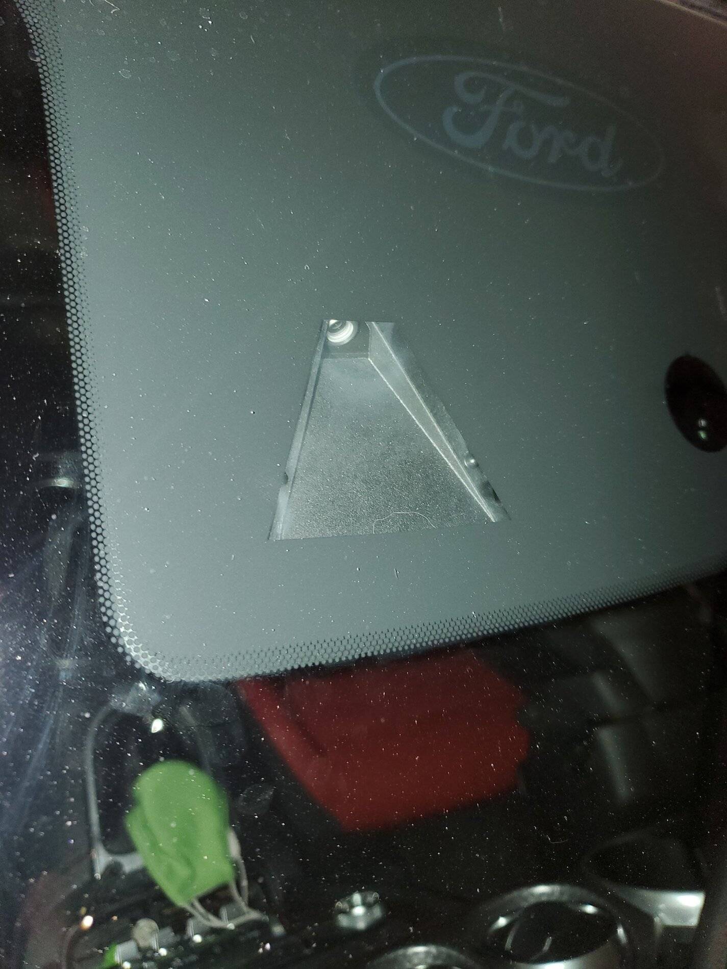

It looks like there is a haze there to me, at least from your pics. Unless that is some type of reflection on the exterior of the windshield?
Looks like the haze is on the inside between windshield and the camera housing.
Yes. I'm assuming that the haze is why I keep getting the error message.

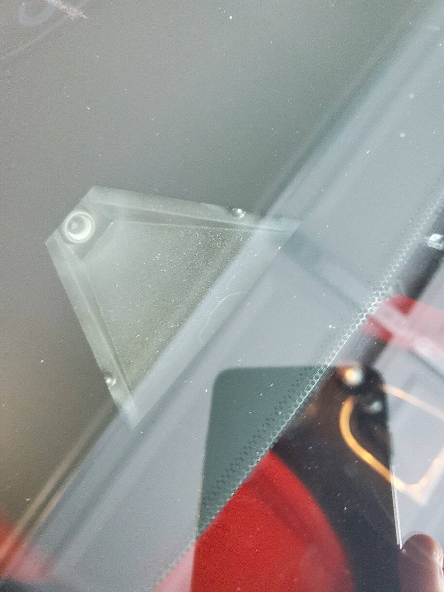

I have the same haze inside my windshield in the camera area and it seems to trigger the warning when bright sunlight hits the area just right. It even triggers my auto wipers on then that is usually followed by the warning message coming up. Since this camera senses several safety features, I would assume that any low visibility means everything it does is less sensitive.
From what I can tell, the haze is forming from fine dust in the air and from blowing air on the inside of the windshield, just like it does anywhere inside the windshield, if you don't clean it.
The housing is not totally sealed. There is a small slot at the bottom of the camera housing that air can easily get into and that is probably what's letting this haze form but it's not big enough to get anything in to clean the area. I've also always been in areas with high humidity which probably adds to the problem.

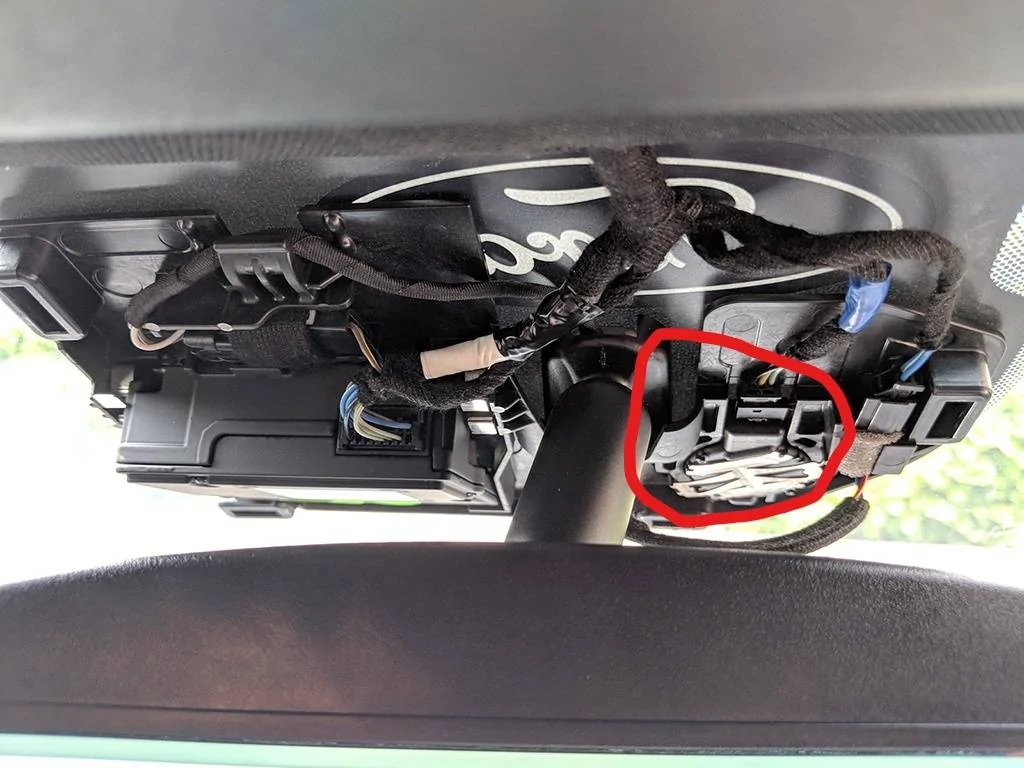

Thanks for the info Alex. I did ask if that housing would come off and while it does, it doesn't allow access to the area in front of the camera. (see attached image).
There is a thin slot there and maybe an innovative technician at your dealership, used something small to get in there to gently clean the windshield. I've found no one who will attempt anything, yet, so the mystery continues, for me :cool:

After reviewing this thread again and the pics of the haze - my guess is the haze is being caused by interior degassing of the plastics. This wouid be similar to the haze that accumulates on the inteior of the windshield during hot days.
It's more common to see the haze on the front windshield than it is the rear or sides because of the close proximity of the dash pad and other surrounding plastics to the glass.
I forget the exact scientific reasoning, but it's the degassing of chemicals used in the interior component composition. Such as dash pad materials, plastics, rubbers, etc. This happens more frequently with vehicles on hot days, whether it's sitting out in a driveway/parking lot/street or even stored in a garage.
I don't know of any way that hazing can be stopped if it's being caused by interior degassing.
