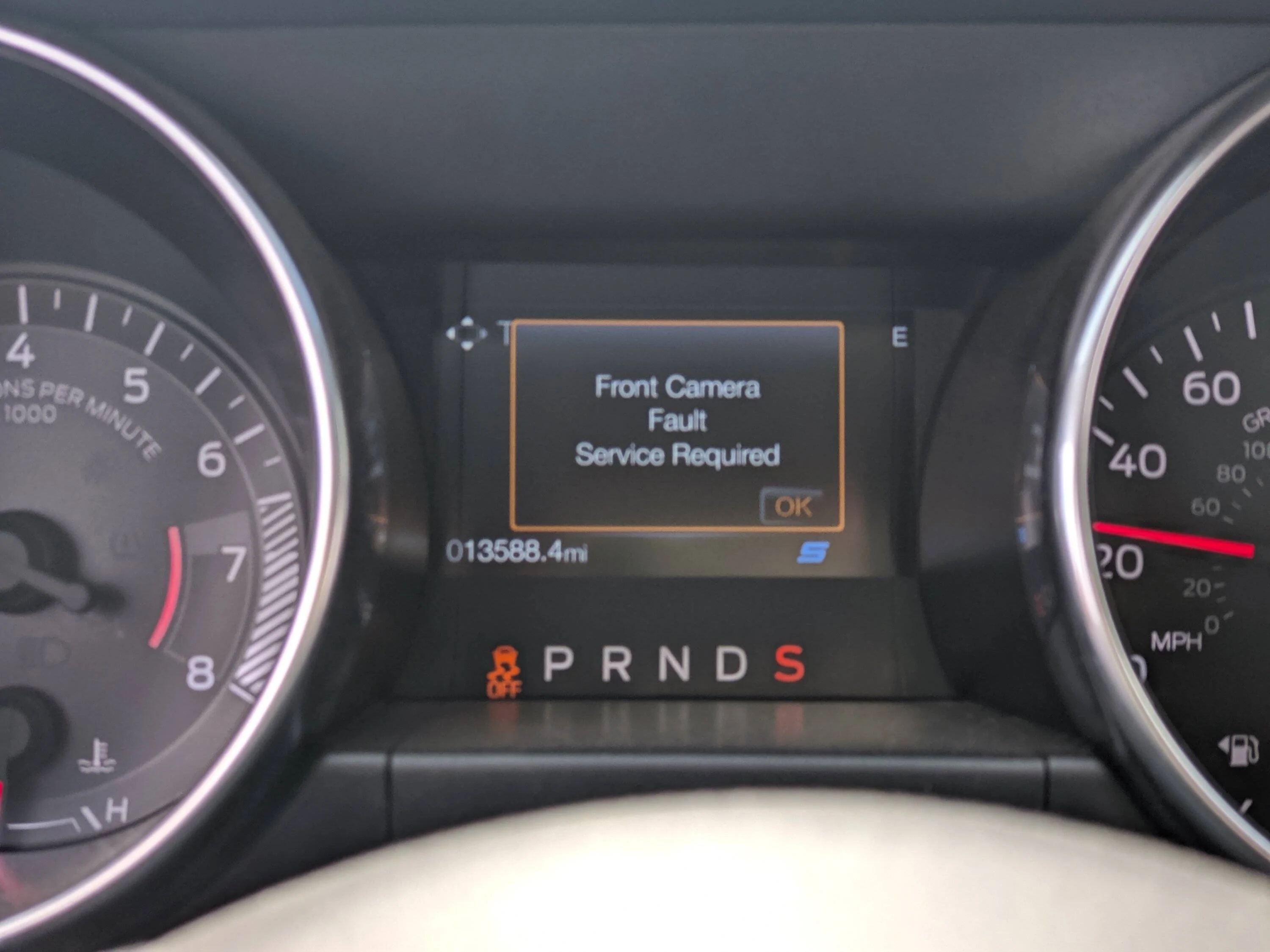

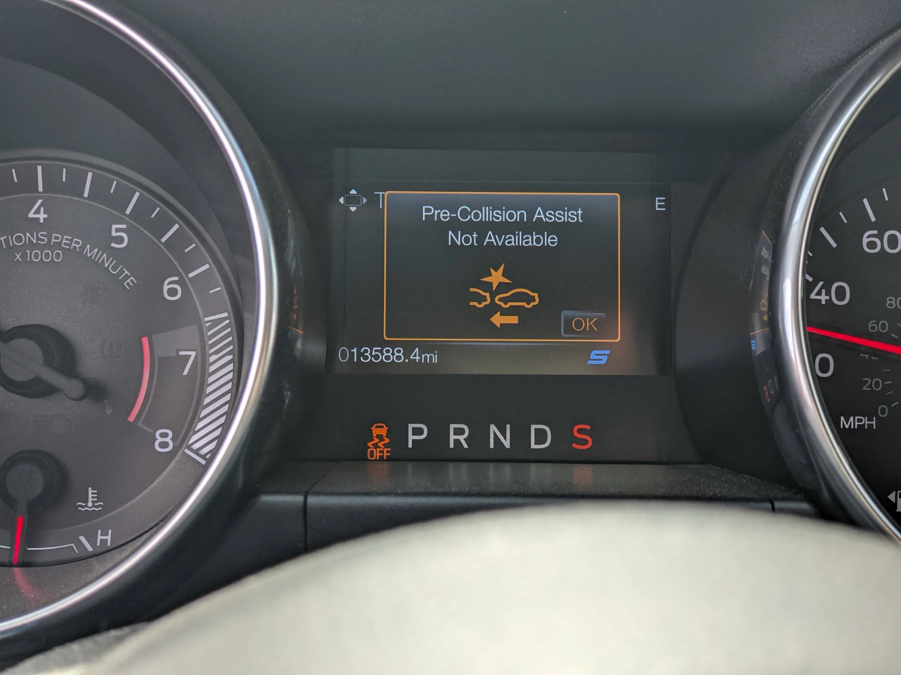

I am not shocked that there is another problem with this car - but here I am, yet another issue.
This morning on my way to work I had two errors pop up. "Front Camera Fault - Service Required" and "pre-collision assist not available) Obviously the second one is directly caused by the camera. When I went to lunch (I take very early lunches 😅 ) the issues did not reset or go away. Went for a short drive, turned the car on and off a few times - the errors still pop up.
Now every time I start the car I get these warnings.
I would prefer for these systems to be disabled or removed. I do not like the error messages popping up.
I guess my questions are:
1. is there a known fix that I can do by myself to resolve the issue?
2. Is there a way just to disable these systems so that they never bother me again?
Few other things. I washed my car last week and it still very clean - do I doubt its dirt anywhere messing with the camera or sensors. But I will do a wash tonight to see if that helps. I would really like to not go back to the dealer for this car.

It is FINALLY fixed. The camera was failed around 13k miles. They had the part within a week after my appointment (which was sometime in August) - but it took an additional month for them to actually install it due to lack of labor. All of my local Ford dealers are insanely far behind.
They say all their old workers retired during 2020. And they are finding difficult to hire and train young people.

Can you please post exactly what they did to fix this. I want the “diagnosing” phase to be as short as possible while at the shop.
You will have to tell them your symptoms. I told the service guy I think the camera fault it causing the pre-collison failure. They then ran their stupid little tests and determined that it was the camera that had failed (as opposed to the pre collision system which is separate?)
Anyway, it was easy for them to get the part, but I had to wait a long time for labor to open up...
So basically, the plastic box that holds your rear view mirror was opened up and they swapped the whole circuit board/camera system. *They did not replace the mirror or anything like that
