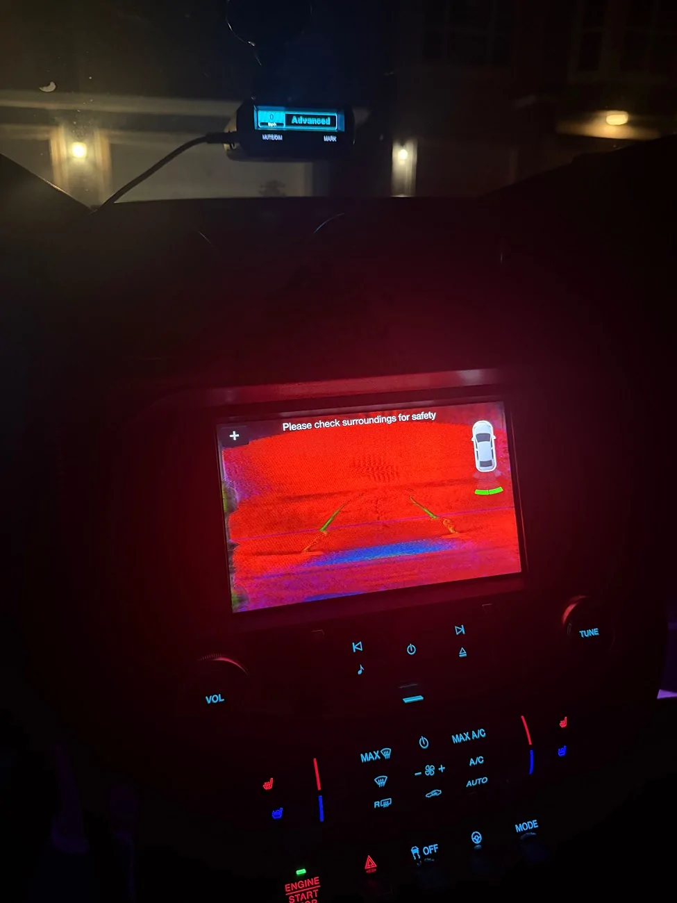

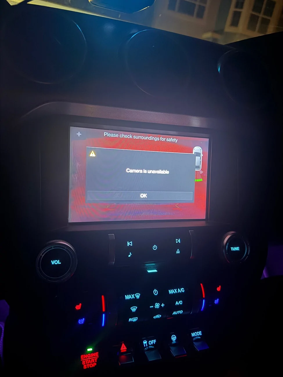

I’ve just encountered my first “problem” with my car. When in reverse, the camera will bug out and have lines throigh it almost as if it’s working but not as clear.( picture below) It progressed and got to the point where it said camera unavailable. Today it seems to be working fine for now but just looking to see if anyone had this problem or knows a way to fix. I’ve heard could be the fuse or an update but the app shows it’s up to date.
thank you

Your wiring harness may be damaged. You can look in your trunk and see if you can see any broken wires, or your camera itself could be failing. A replacement camera is around $40. Not sure about the harness.
It's not often easy to see broken wires as the are in a loom. You have to take the loom apart to properly inspect them. Even then it's not always easy because the wire itself can fail inside of the insulation.
A camera is not too expensive but sometimes they have to be programed to the car to restore backup lines. That requires Forscan or a dealer.

The recall is for the camera wire in the trunk that hangs down from the trunk interior and passes to the lid. The section between the ziptie fastening and lid rotates 90 degrees each time the trunk is opened. The 90 degree bend in the wire is sharp and the wire is fatigued each time the trunk is opened. The more the trunk is opened the more the wire is fatigued until it eventually breaks. Trunks used more over the life of the car have a higher chance of the issue. It's more about how often the trunk is used rather than the age of the car. Even if there are no issues with the camera the wire may be damaged and pending separation. The wire is wrapped with electrical tape and the tape must be removed to check for damage whether or not the camera is operating normally.

The root cause of the issue is the ziptie. The ziptie was installed much too tight on the wire at the assembly plant. The issue might not be here if the ziptie was loosely installed around the wire and the wire had room to float. Looks like the failure built up from 2015 to now and the poor install of the ziptie is now being uncovered.

On your vehicle, the rear view camera could display a blank or distorted image on the center display screen when the vehicle is in reverse. You may also receive a message that the rear view camera is unavailable on the center display screen.

They replaced both the camera and the harness in one day...no return for service.
