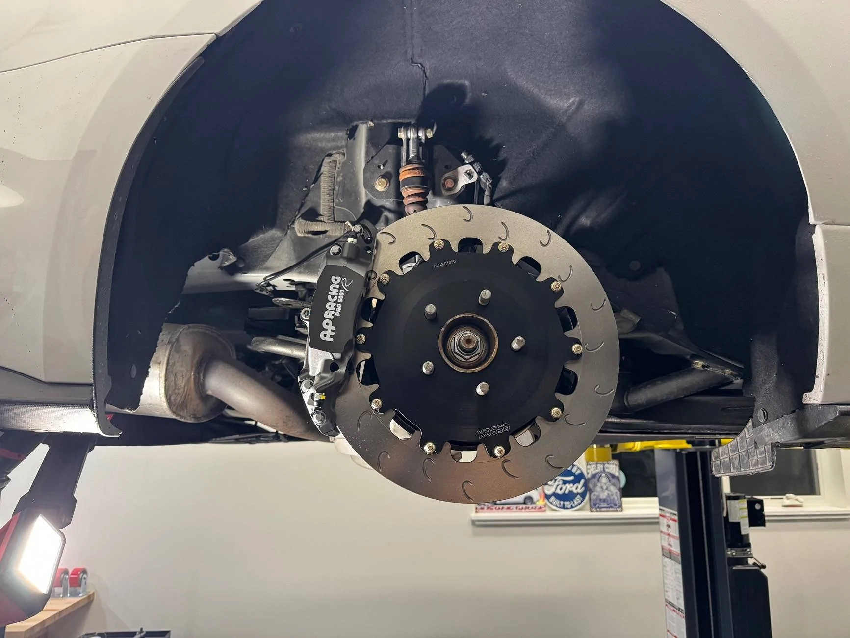

In terms of running 18s at a minimum you need the front kit, wait for a Black Friday sale or wait in the classifieds for one. About 2 years ago I did the rears as while the oem rear caliper clears most 18s, occasionally rocks get stuck in between the caliper and wheel.
To put things in perspective, over the 8 years I’ve had the kit I’ve done maybe 30 trackdays, the discs lasted about 27 before I replaced them. I replace pads every 4-6 events depending on the tracks I go to.
The wheels are Forgeline GS1R 18x11 +52 and I rotate them with a 25MM spacer up front.
