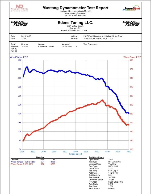

Here was my dyno run on mustang dyno today
17 ecoboost, 3.31 gearing, 5th gear manual dyno. Non performance pack, speed limited to 120.
Idk if that impacted my numbers at all. But here are my numbers with ford performance tune + stock airbox and drop in kn filter.
I sold the cai. Just liked stock cold box look more.
If the number difference between mustang dynos being 10% lower than dynojet is true I should be roughly 292hp and 411tq at wheels

Something isn't right with that graph. The HP peak on the 2.3 Ecoboost motor is about 5500 rpm, your graph is showing 4200 rpm. The torque peak is much lower than what the engine does.
I have a 17 with the FP tune and it pulls hard to 6000 rpm.

My speed limitor kicks in 120mph. And I’m 3.31 gearing. It hit 120 and just plummets, hard cut off
my car pulls hard on the street all way to 6k, but the dyno it won’t show its full range due to the power cut off. So oh well, not dynoing again.
The car continues to pull on street way past those numbers but I’m not going 120 either at those speeds

The car also may have not fully learned the octane yet. It won't fully perform if you just flash it and head to the dyno. It must learn the octane.

So, why couldn't you dyno in 3rd gear where you wouldn't hit the speed limiter?

because then the slope of the graph wouldn't be comparable to anything else on the planet.

I’ve had my tune for weeks, it pulls like a freight train. Not too concerned about numbers, if it won’t read right due to limitor then, oh well.
I’m happy knowing or not. I tried to find them out

3rd gear would have a final drive somewhere in the 5's, but a fourth of 1.238:1 works out to a pretty common 4.10:1 final drive. Seems like you should be able to compensate for any gear in the setup.

Not sure what is up with the dyno plot, but nothing is right with it...
And it doesnt matter what mph, but the mere fact you don't even hit 5,250rpms at all and seem to have a crossover point instead, at 4250rpms. Doesnt add up.
