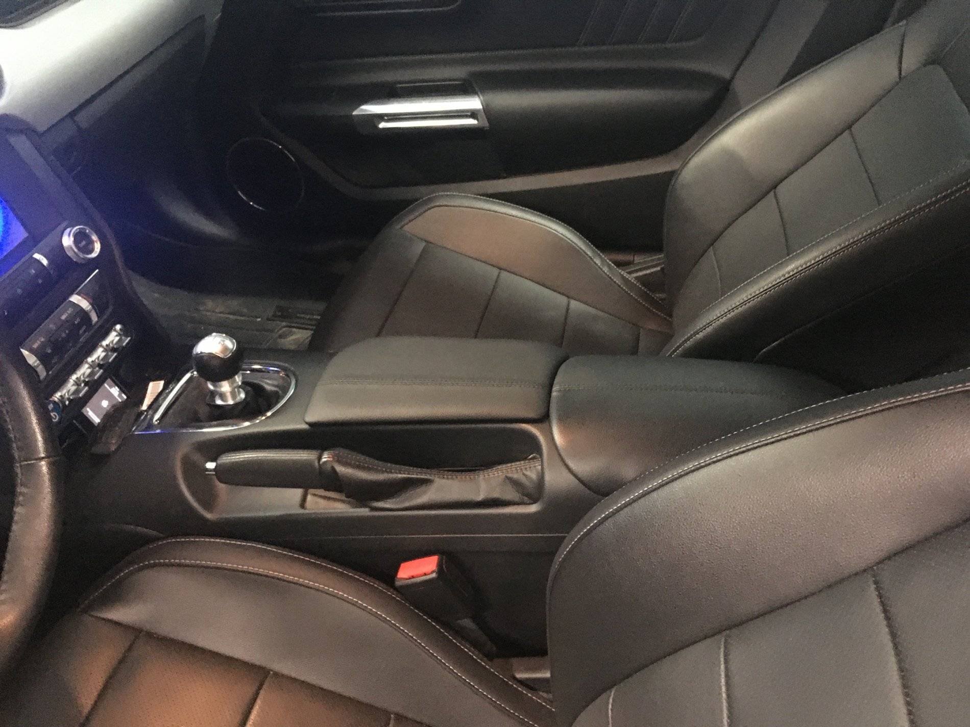

You will not break the mt82. Modded gt’s have issues because they push ridiculous power. For ecoboost we don’t have issues really.
but I will tell you. The two things I loved, that made me love! My shifter was
Steeda clutch spring. 15 bucks
Hybrid Barton 3 short shifter. I paid 350 from Barton.
shifting went from notchy, etc to 90%notch free, so much more comfortable, the clutch spring let me feel the clutch engagement.
and well,the next biggest purchase is.....
the damn 5 spur shifter arm rest cover. It’s 100. But I can’t live without it now
oh, this wasn’t needed but I had alignment done and saw the store had bg synchrshift ii.
I asked about it and they said $100 we will swap fluid for you.
fluid itself is like $70 bucks so to me it was worth to let them knock out on the lift. It took a few days, but the10% notch that may of been left whencold,
eliminated 100%. But with Barton, once warmed up, smoothest shifting experience I ever had on stock fluid and maybe 5% better on bg shift ii fluid
