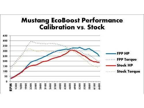

New to the Ecoboost world, having just picked up my 2018 last week. But I've noticed something a bit odd about the description of the Ford Performance Ecoboost tune. Ford indicates that the tune adds 100hp at 6K rpm, but peak hp is only increased by 25 at 5500 rpm, to 335hp. I assume this is all crank hp. I have seen several dyno charts for stock Ecoboost engines showing roughly 230 whp at 6K rpm, so lets do the math. Adjust that 100 hp @ 6K to whp = 85. Add that to the 230 = 315 whp. Addjust that back to crank = 370 hp. But peak is only supposed to be 335 @ 5500? For Fords description to make sense, the base engine would have to make less than 200 whp @ 6K. As described, it doesn't add up.
Obviously, if someone has a dyno chart showing the impact of ONLY the Ford Performance tune w/CAI, that would probably resolve this. However, it seems like the only dyno charts I can find, also include other mods such as larger intercoolers and/or down-pipes. If anyone has any info on just the Ford kit, I'd love to see it.
Thanks.

SVO - the turbo releases pressure at peak and the power drops like a rock at higher RPM. At 6K on stock tune, air box, and intercooler, you are lucky to get 200 HP from the crank. Ford's charts are also read less than Dynojets.
Read around Pg 115 and up and you will see some charts explaining why.

OK, I found this on Levittown Ford's website. This is really what I was looking for. This is crank hp, and it does show much less for the stock motor at 6K than what some other aftermaket dyno runs have shown, for stock.
