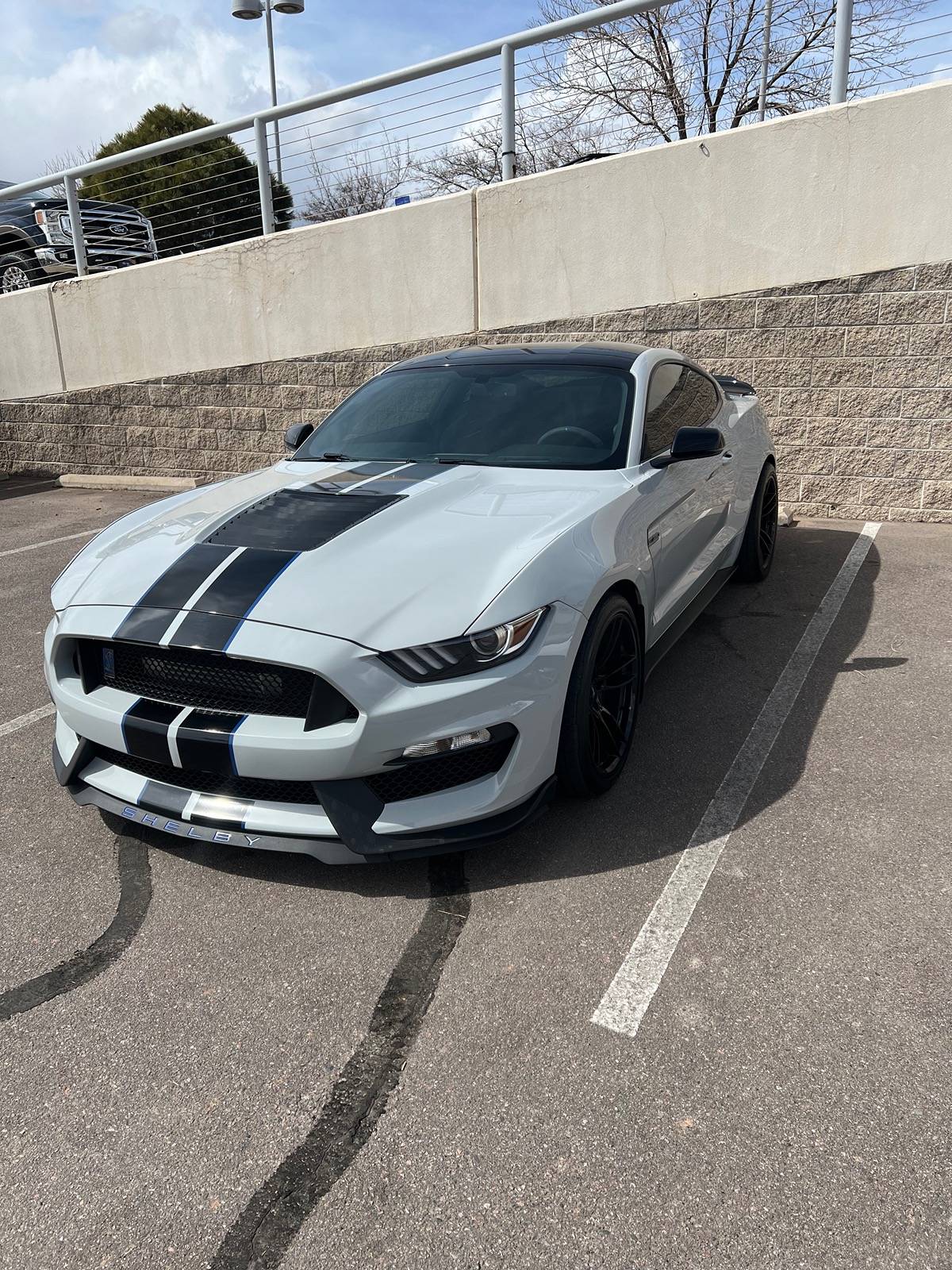

I recently purchased a ‘17 GT350…LOVE IT!!! is an understatement! A previous owner put a ProCharger on it…and the dealership is offering to add the Ford Protect extended warranty. I know there are a LOT of debates as to whether or not a supercharger will void the warranty, so I was a little surprised they even offered it.
My primary concern that I’d want a warranty to help me with would be a blown engine…which I suspect Ford would immediately point to the supercharger and deny a claim. Any thoughts on that?
Also, even if they wouldn’t cover the engine, do you feel having the extended warranty would still be worth it to cover everything not related to the supercharger/engine?
At the end of the day, I kind of like having the piece of mind of a warranty…but don’t want to throw away $4,700 if it’s not going to be worth it.

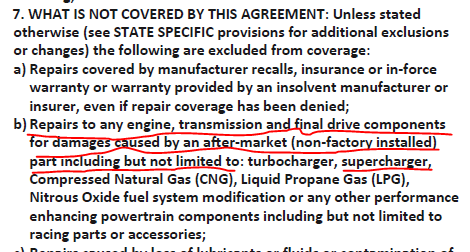

I think you’d have a tough time getting them to fix/replace a blown engine with the S/C on it. The ESP could be useful for other things such as the trans, electronics, etc. If you plan on tracking the car, just beware that another member here went through a tough battle with Ford ESP over a transmission issue and was denied because of signs of track use (HPDE specifically). It was denied under the no racing clause and went to arbitration where the member did not get a favorable ruling. So just know that going in and if you do plan to track, remove all signs of it before going in for a potential warranty claim. Even if the claim is not track related
You better make sure that whatever policy you get specifically calls out modifications and/or the supercharger installed. I highly doubt that will be the case though because 1) the unit was installed by a previous owner and 2) Ford ESP doesn't cover any aftermarket stuff.
Also a supercharger affects more than the engine, it can also impact the transmission, driveshaft and rear end. Basically your entire powertrain will not be covered. What you're left with is $4700 warranty for minor things which IMO is not even remotely worth it. Heck I don't think $4700 is worth for a stock car which includes engine.
To me this sounds like a pushy salesman just wanting more commission by pushing useless stuff onto you.

Cut from my Ford PremiumCare ESP contract:
