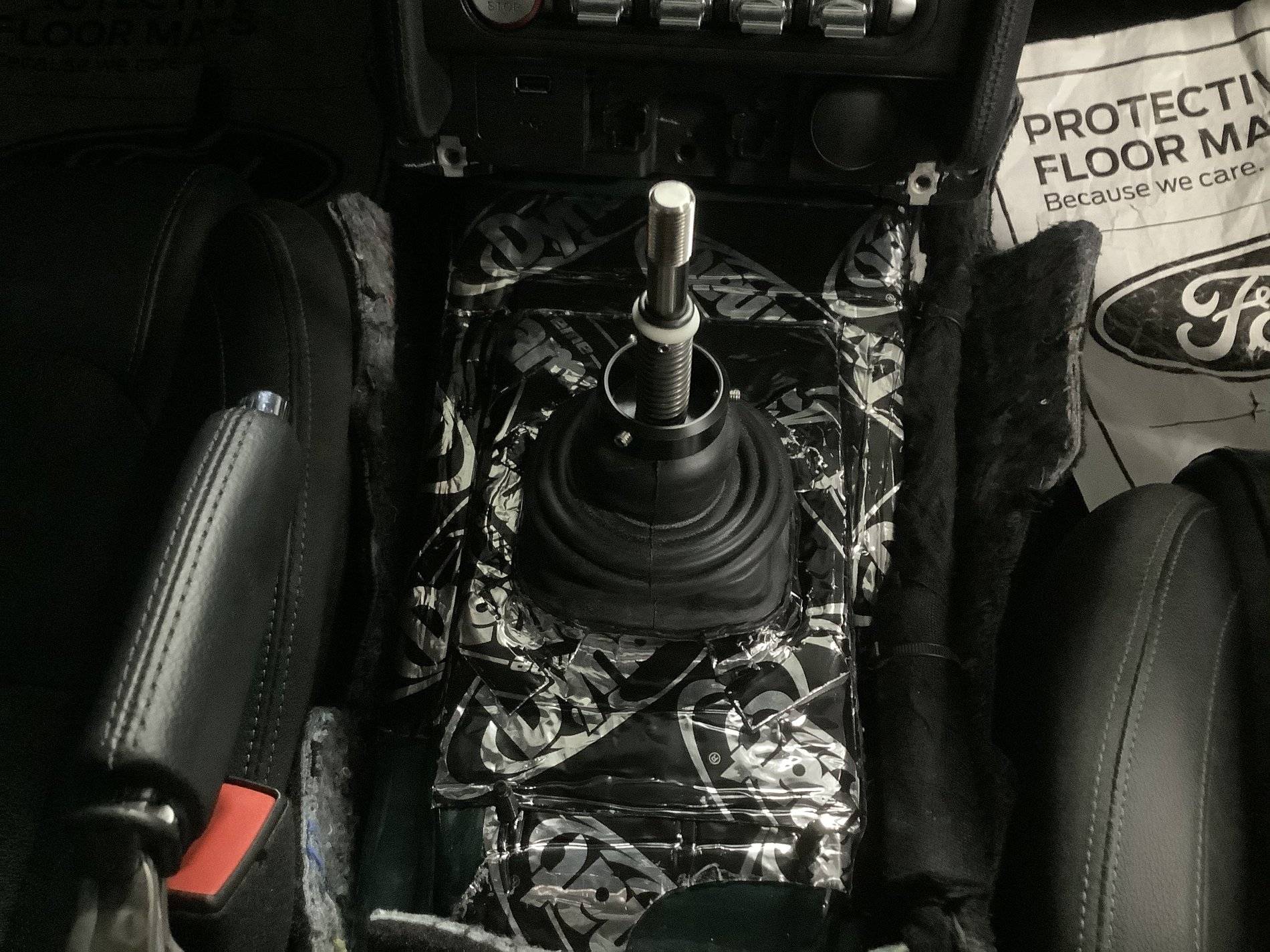

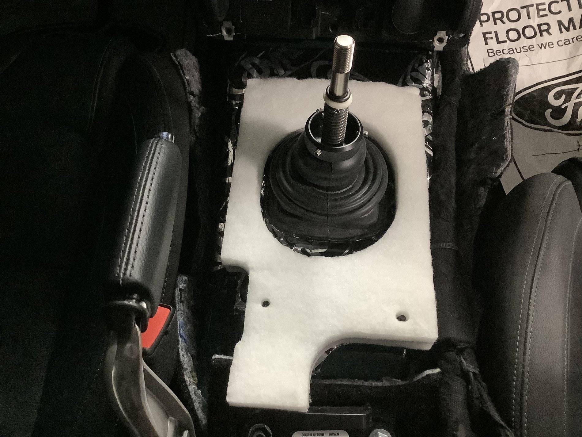

Bumping this thread as I just got done installing this kit along with a DSS 1pc aluminum driveshaft. I've been running the Blowfish Racing Bracket since day 1. I was worried about driveshaft vibration imbalance, but that turned out fine.
I wasn't expecting this level of NVH from the shifter. My car sounds like in-car footage from some of the endurance racing I've watched recently. My Raceseng lockout and shifter knob didn't quell the lockout rattle as much as I hoped so that's still there, too.
I really, really, REALLY don't want to uninstall the exhaust and driveshaft and and shifter again, so I'll be trying everything I can from inside the car, which amounts to:
  • Removing knob and lockout and lockout collar and applying heat-shrink and O-rings and grease wherever I can to quiet that down.
  • Checking that the OEM boot is installed correctly. It seems like mine may be "leaking" noise into the cabin.
  • Applying Dynamat to the shifter area as outlined above (and in other threads for MGW, etc.. one poster in this thread suggests lead sheeting: https://www.mustang6g.com/forums/threads/heavy-nvh-from-new-steeda-shifter.127771/page-3)
